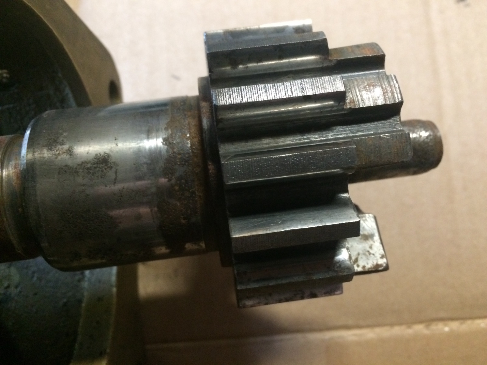

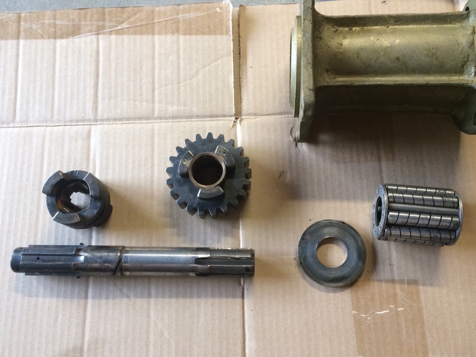

Les thanks for sharing your experience! It sounds like a good unit! I have the same under-drive unit that you discribe:
To get an idea of the inside. Here is the power transmission parts. First the output side:
The second shaft/gears:
And here is the gear on the driveshaft:
I am thinking of selling it. Maybe I will find someone looking.
