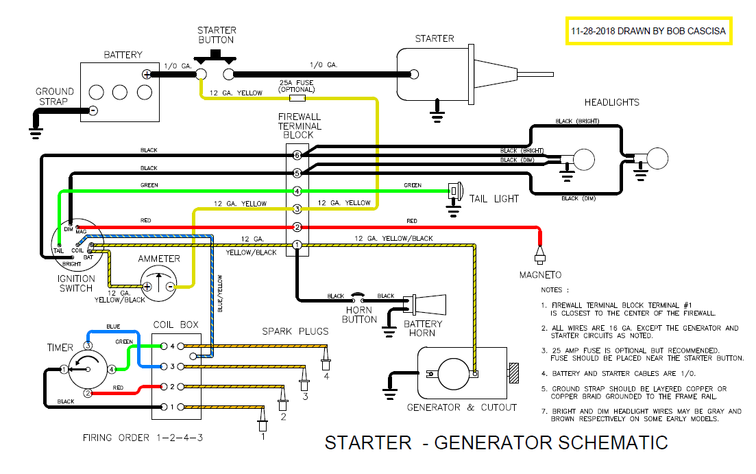

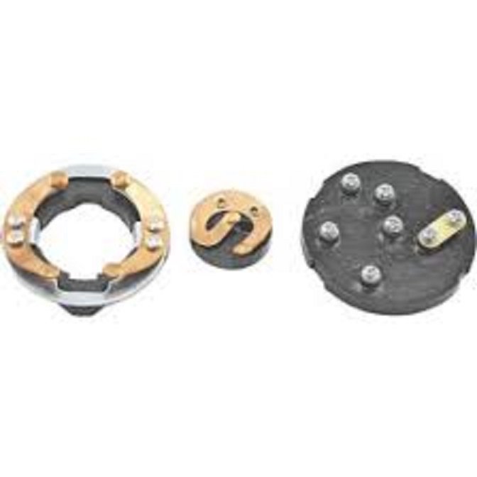

Here is a very nice and clear wiring diagram. You can see why terminal 1 & 3 are hot because they are connected to the battery ( 3 directly and 1 to the Amp meter to the switch and terminal 3 to the battery). The second photo shows whats inside the switch less the locking mechanism. Think of them function this way. The key operates turning left/right is used to select the power source and connects to the larger outer layer where the switch arm is used to select the lights choice. what is connected to terminal 3, the DU4mag or the mag output on the hogs head. Rest of you question depend on the voltage output of the DU4mag. Normally a fuel pump starts pumping just before the engine starts to turn over.

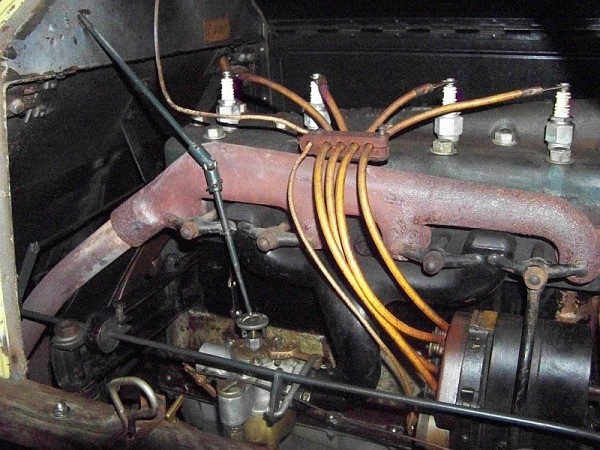

The DU-4 on my '14 Metz. Note the skinny wire routed to the firewall for the ignition switch.

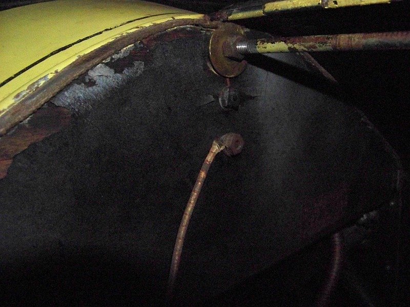

The radiator stay rod is wired to the back side of the switch screw to ground the magneto and thereby turn off the magneto's power.

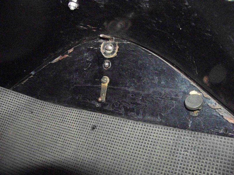

The switch is simplicity itself. The brass strip hanging down turns the ignition ON. Swing the strip up and the magneto is grounded and the ignition is turned OFF.
