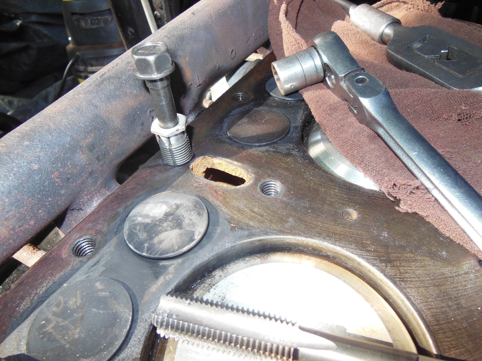

Went to torque @50lb the headbolts on my 26 today and the rear center bolt pulled out. Had used a torque wrench on all the others and used a ford sparkplug wrench on this one cause it was under the dash. I compared that bolt with an original and the repop was about 1/8" shorter. I was lucky and had some long v8 studs that were 1/4" longer, turned the large part down and screwed in in after pushing the firewall back a little. I tightened it very carefully and it held. bottom line is check those pretty repop domed bolts for length!

Jim is right on with his warning. Did a short block for someone and he installed new dome bolts with a Z head . Stripped out bolt holes in block. Bolts were short like Jim says. Dan

For the record: Block was just cleaned in the machine shop. Head was Z. Had had this engine down many times over the years with the same combination. None of bolts tightened with torque wrench failed. Bolt that failed was rear one on a 27 and was against the firewall where a torque wrench would not fit and was tightened with a ford spark plug wrench.

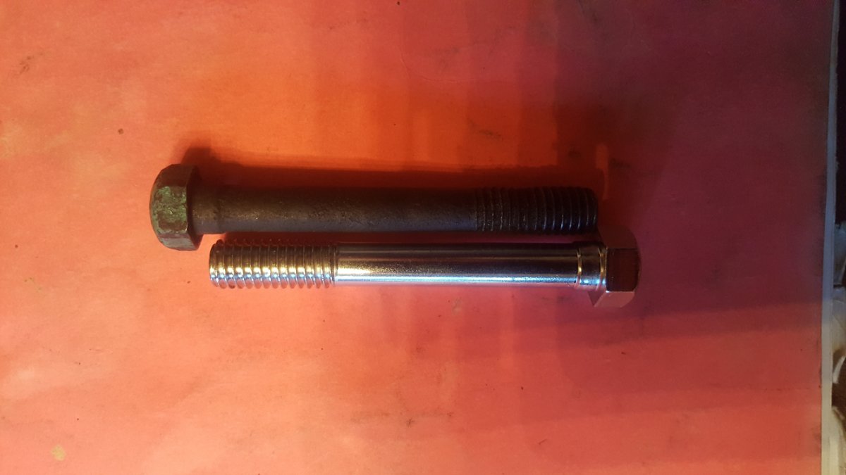

The reproduction bolts are or were short. My customer’s problem was two fold, bolts were short and his AL head was about .100 thicker than any other Al head in my shop, one head was brand new. This lead to a major problem.

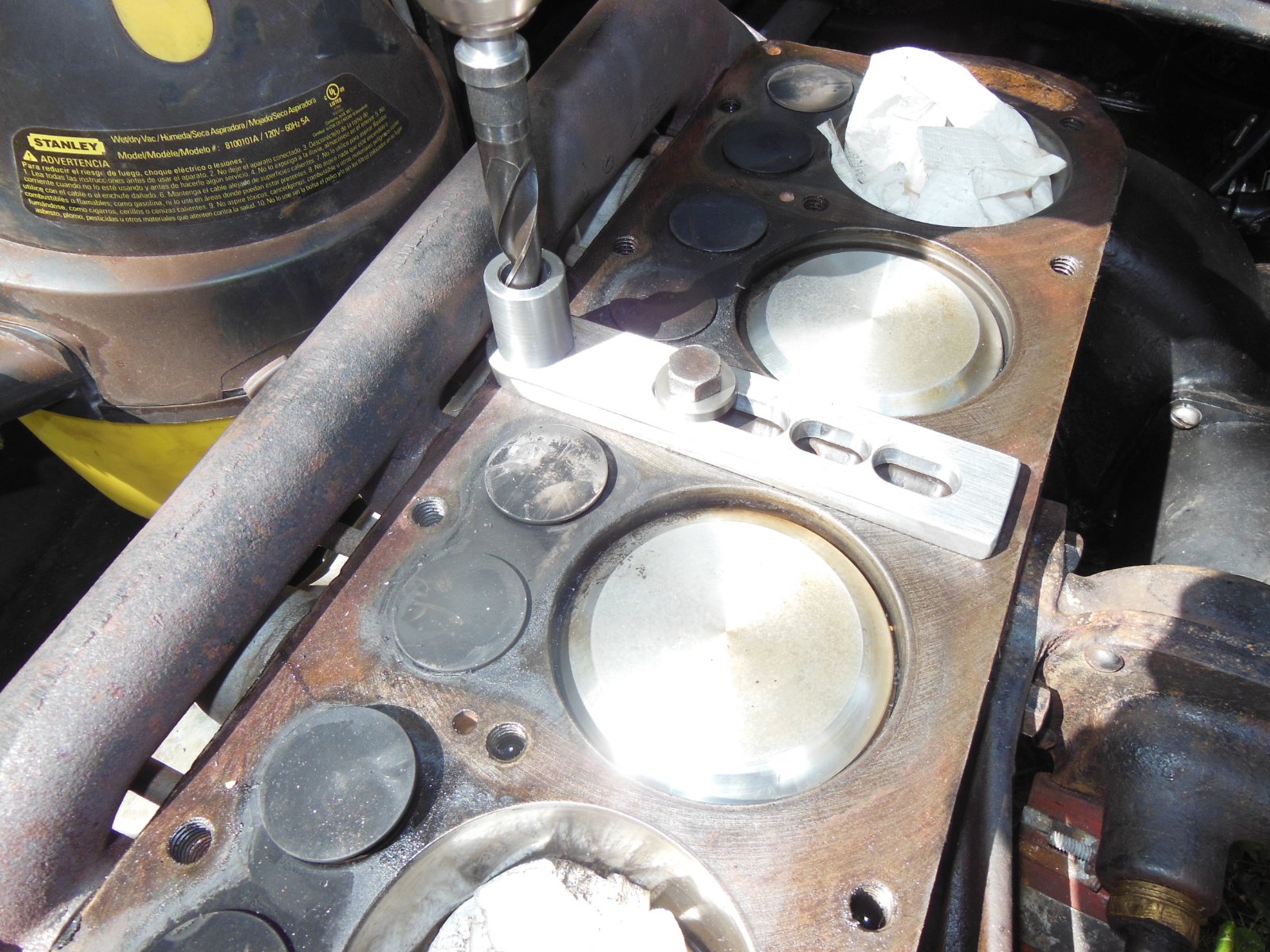

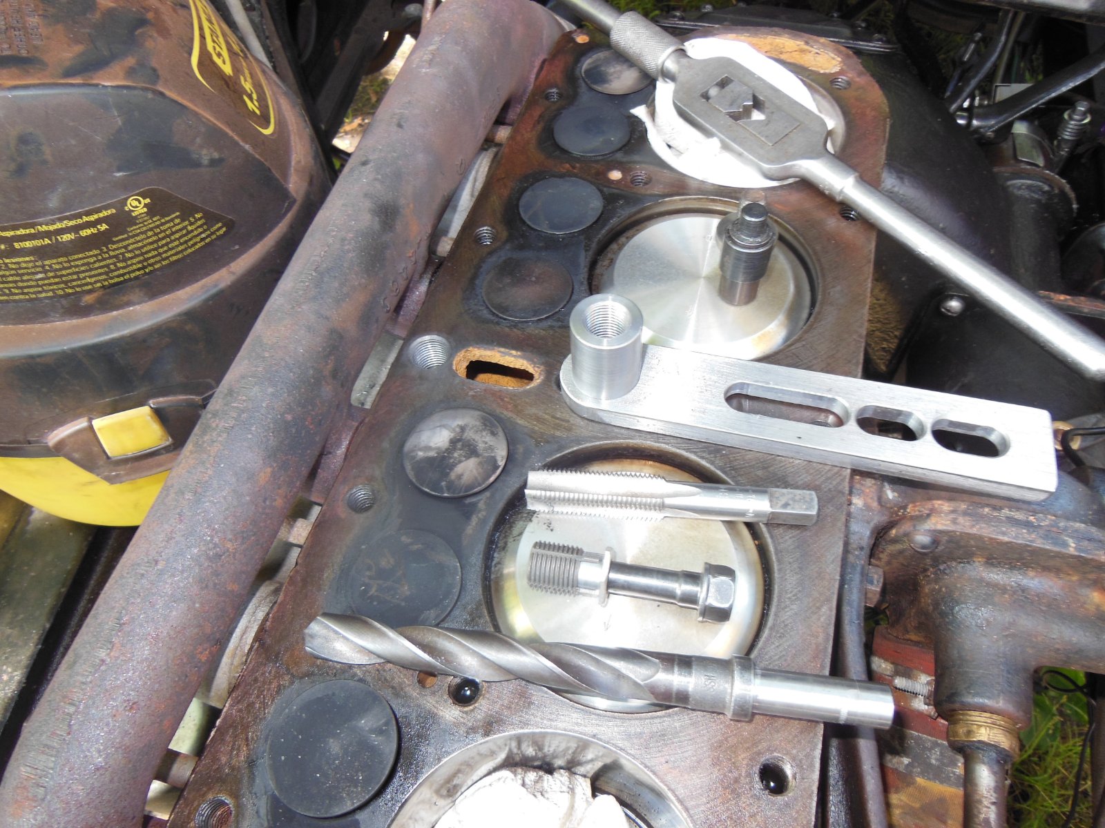

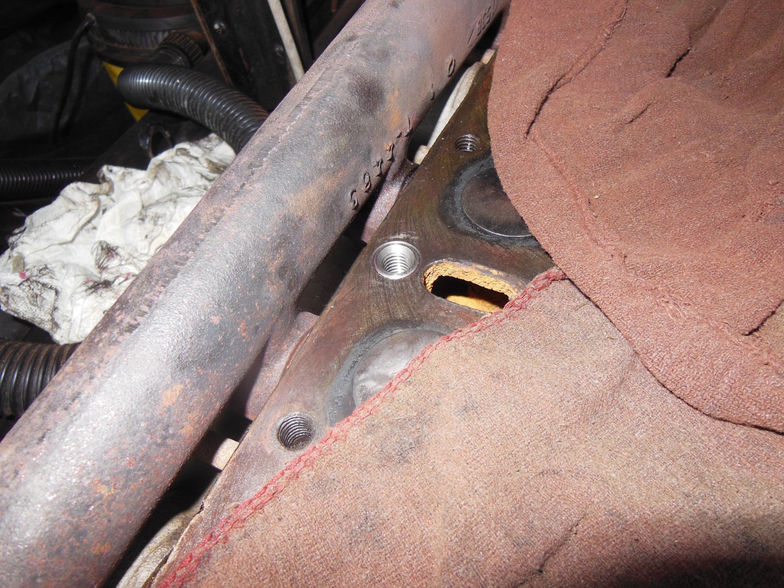

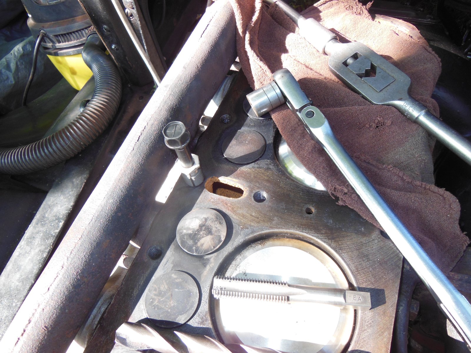

Just finishing a customer built motor with 15 domed nickle plated bolts in a Z head. It lost a head gasket seal with 3 striped and 4 soft torqued at 30 lbs, that's almost half of the 15. I used Keen Serts as there wasn't any good thread for the first 3/8 of an inch.
Helicoils might have work, but I didn't want to take any chances. I have used them In aluminum racing blocks with as much as 15.7 : 1 compression.
[The pictures show the KeenSert and my setup to install them on center and square to the block

End result: I bought a set of grade 8 bolts from RK which are 1/2" longer than the repop bolts. Checked depth of each hole, installed new bolts one at at time removing the repop, torqued to 45lb then to 50. Satisfactory job done.

I recently purchased a set of domed headbolts for my 27 project. I checked them against one original I had and they are indeed too short by a couple threads. Doesn't seem like much but the Ricardo head I am using is taller than a stock Ford high head. Combined with the shorted head bolts, there is just not enough threads going into the block to satisfy me. I purchased 20 grade eight shanked 7/16" by 14 tpi , 3 1/2" long from McMaster Carr. I almost have room for a 3 3/4" bolt. Only problem I see is the shanked section is not thinner like Ford headbolts, but its easy to turn them down if I need to.
