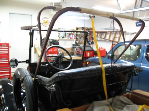

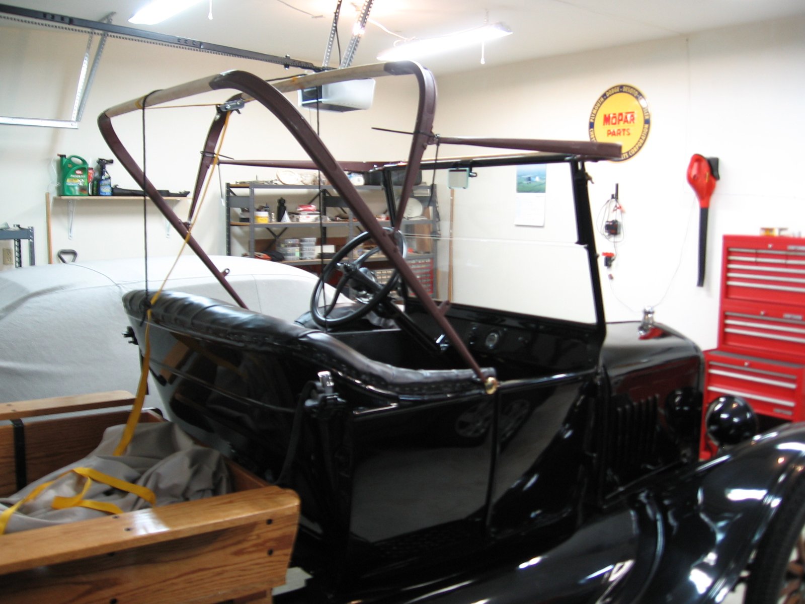

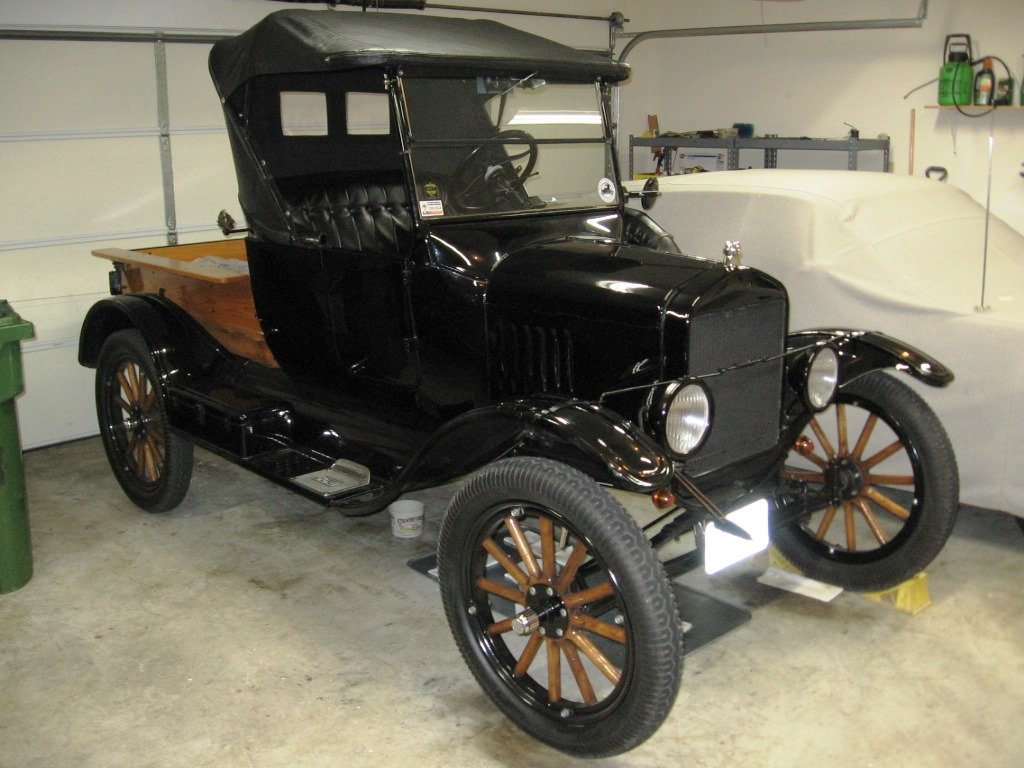

I bought a set of roadster sockets and bows from Lang's for Betsy, my 1924 cut-off touring (now a pickup). I was happy with the results.

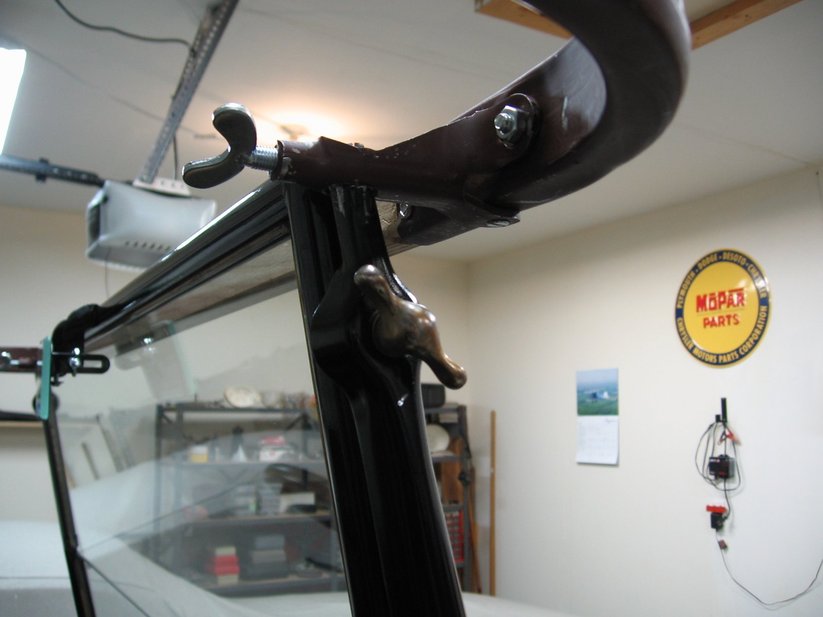

To Larry's point, the current reproduction sockets do not have the raised dimples stamped in them where the side curtain fasteners go.

One thing I failed to mention, the repro top sockets don't have the common sense fastener holes located, drilled or threaded. That is typical for reproductions. They don't do the research! That is why I stay away from reproductions.
