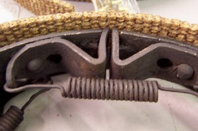

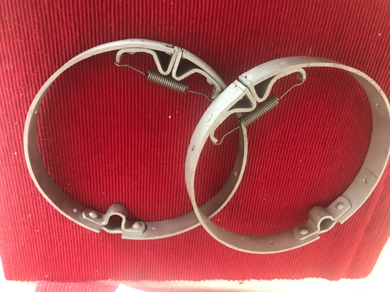

So I got these shoes in the mail today. They look awesome but the rivet hole pattern is different. They're both the same size but it just seems oddly to me. Does that mean that one is earlier than the other?

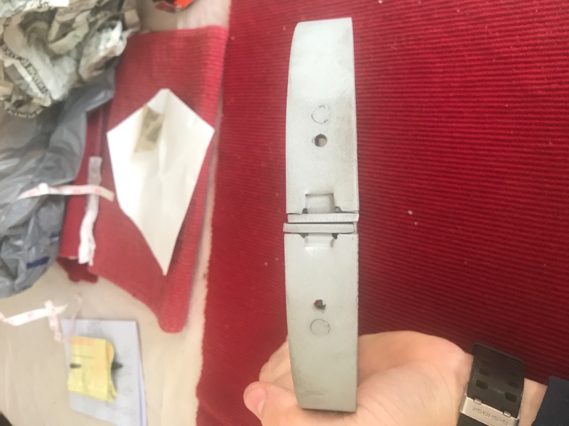

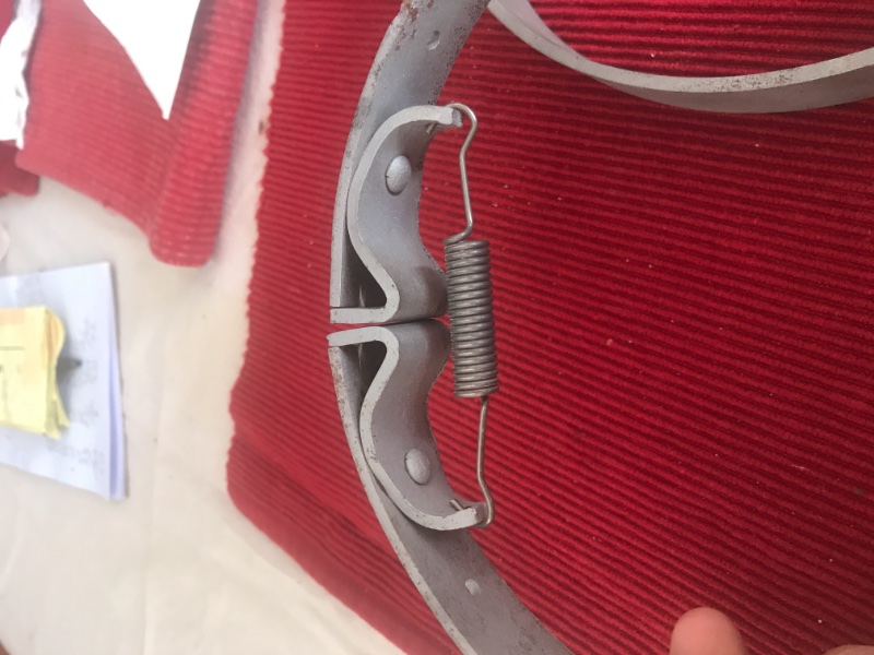

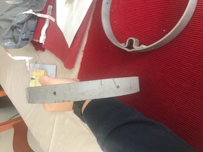

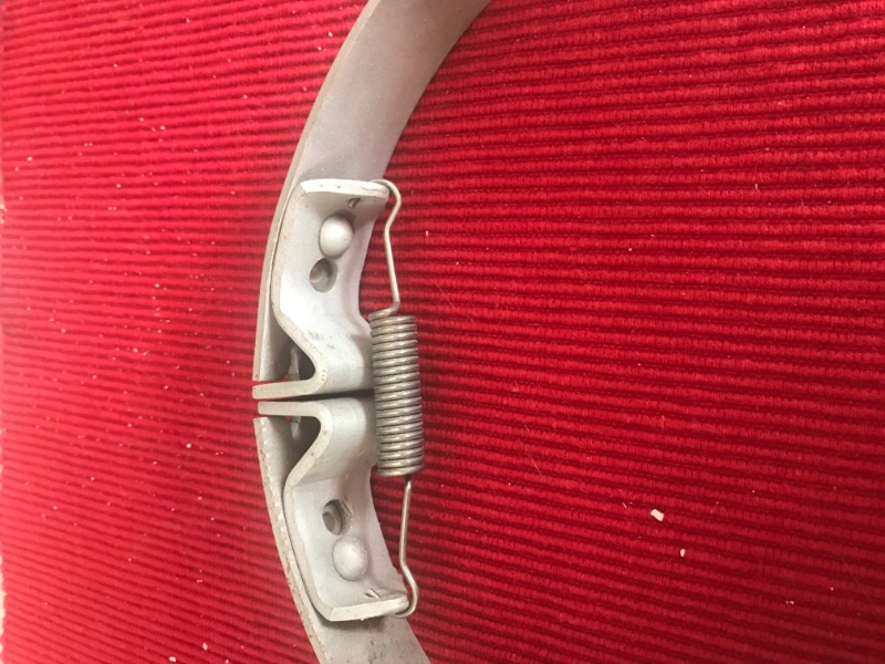

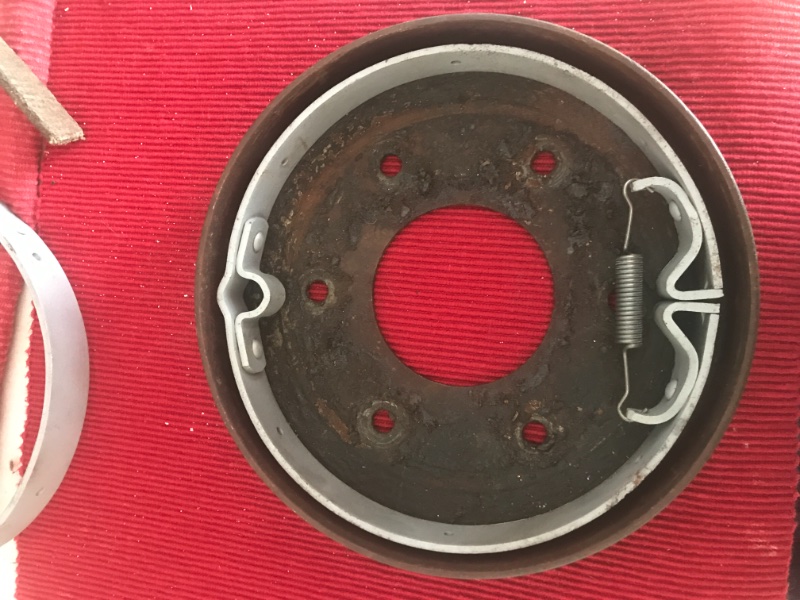

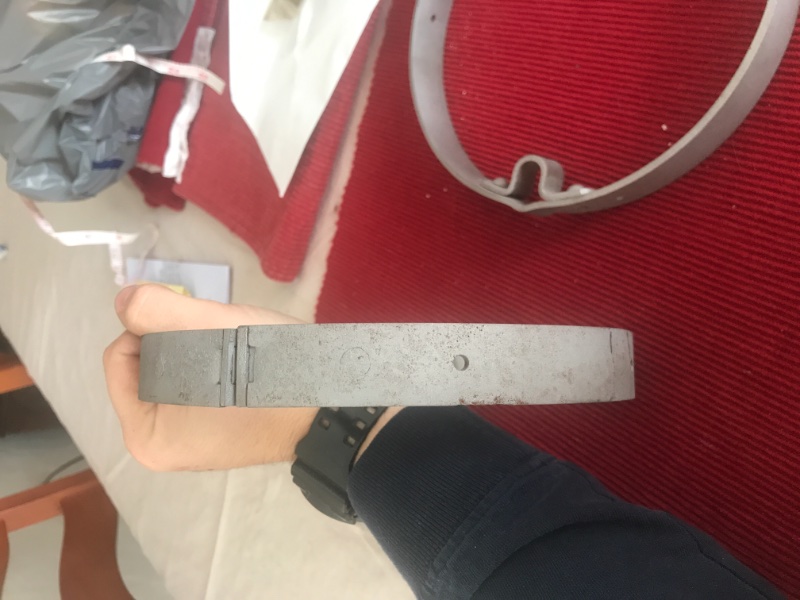

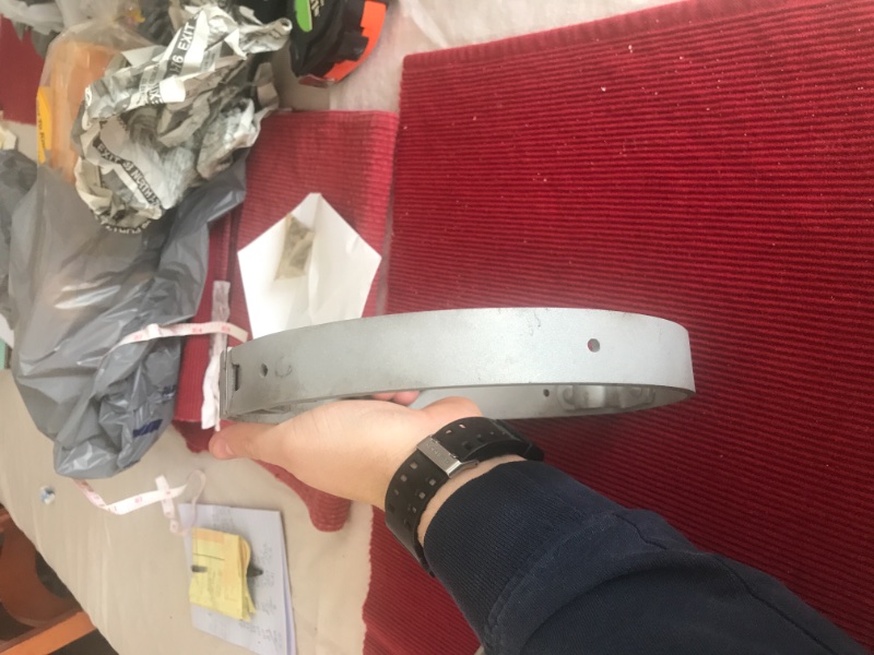

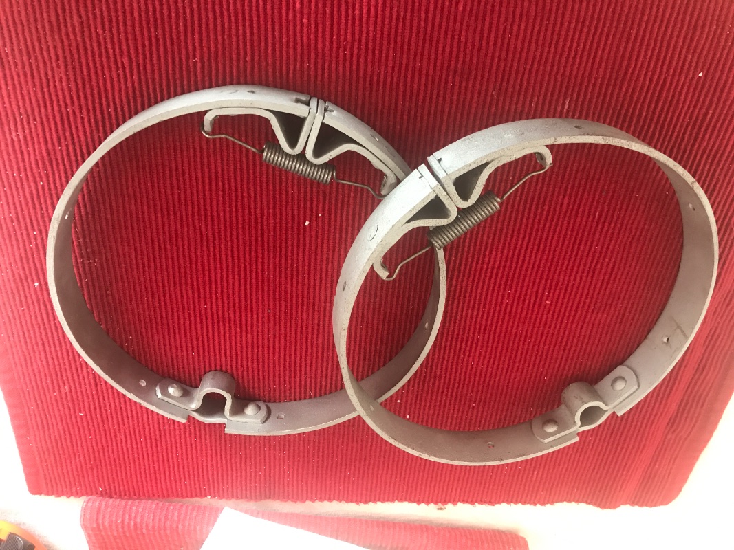

More pictures. They both fit well in the drum with room all around for lining.

Rivet pattern is odd so that you can tell left from right
But really, nice set of old aftermarket replaceable lining brake shoes!
Have used a set too, and relined them.
Got Model T '26-'27 lining and had to sand down the side on the belt sander to match width.

That is a mismatched set.
- Posts: 5471
Re: Small drum shoes
Look at the spring mounts - clearly different manufacturers.
