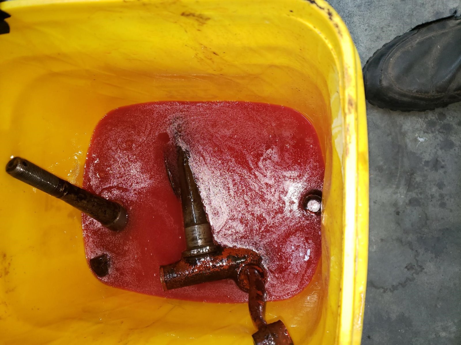

I just stirred the 50 / 50 mix of Acetone and ATF; I will check on the contents Monday or Tuesday to see if they're any easier to disassemble.

by Monday/Tuesday, it's going to be 100% ATF.
While it probably feels good to soak it, no more will get in than if you were to occasionally squirt some on. And keep the solution TIGHTLY covered with little airspace in the container...a canning jar works well...
FWIW - the only reason the arms need to move is if the tierod bushings are tilted and the tierod binds. I find that in about 1/2 the cars I work on, but not all the cars I work on. You may be needlessly trying to remove the arms?

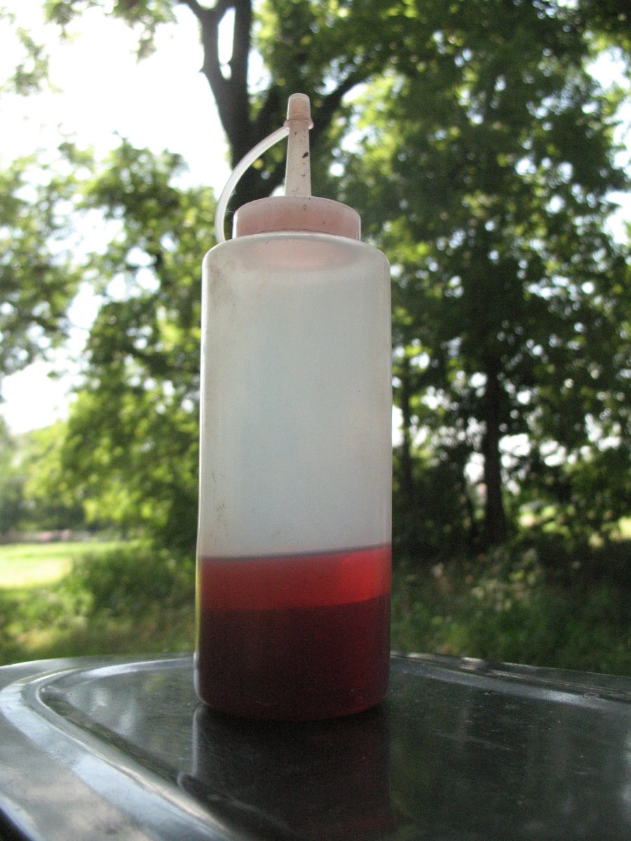

Maybe Scott is being conservative about how fast the acetone will evaporate out of the mix. It may not take until Monday. The ATF will also sink to the bottom pretty quickly.
I keep the mix in a capped squeeze bottle to retard the evaporation and so I can shake it up before I squirt it on. So much acetone has disappeared from this batch that I'll need to add more before I use any more of the mix.
