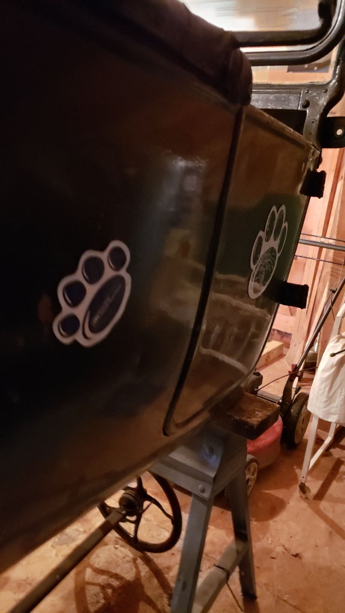

Re: Show us your 1915 pass front door line up please
January 1915 touring body. Nice and tight in my situation. Pretty sure your door sag is just from age/use. Common in many years of Ts. Can be fixed with a diagonal cable and turn buckle on the interior wood door frame.
