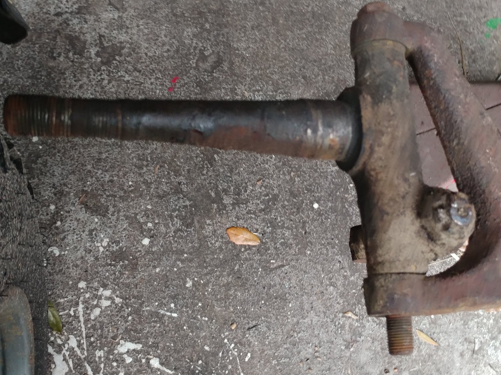

Re: Spindle differences
So I ran across a couple of left side spindles a friend gave me. The problem is I need to replace the right spindle due to worn out threads. My question is this. With regard to the geometry only(not concerned with casting numbers or machining for the tie rod arm) will a left spindle work on the right side. I did a retro fit today and I see (with the naked eye) no difference. Attached the tie rod and all moved as it should with no binding. What do the experts say? Will caster or camber be effected?
Spindles are right hand & left hand thread and MUST be installed so the threaded outer wheel bearing "loosens" when traveling in a forward direction - don't mix them up !!!
Thanks for the replys George and RojaRacer. I had forgot about thread direction. I did have T Haven find a passenger side spindle, bearing and nut. Seems that this TT trucks rt spindle was replaced years ago with a 26-27 left side spindle(notice right hand threads). This explains why the threads are wore down.
