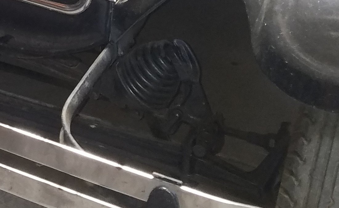

Re: Front Hasslers or Bumpers...Which Would You Choose?

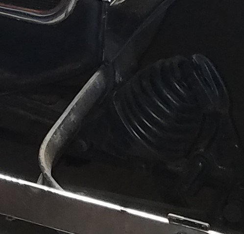

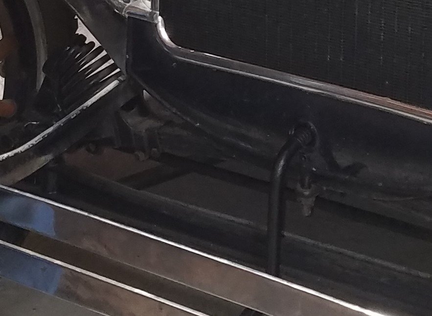

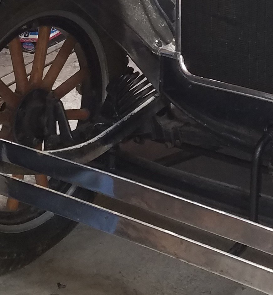

Michael Jewell : If you want both bumper and Hasslers on the front of your 26 T it can be done. This is a picture of my 26 Cp that has both,it came to me this way.

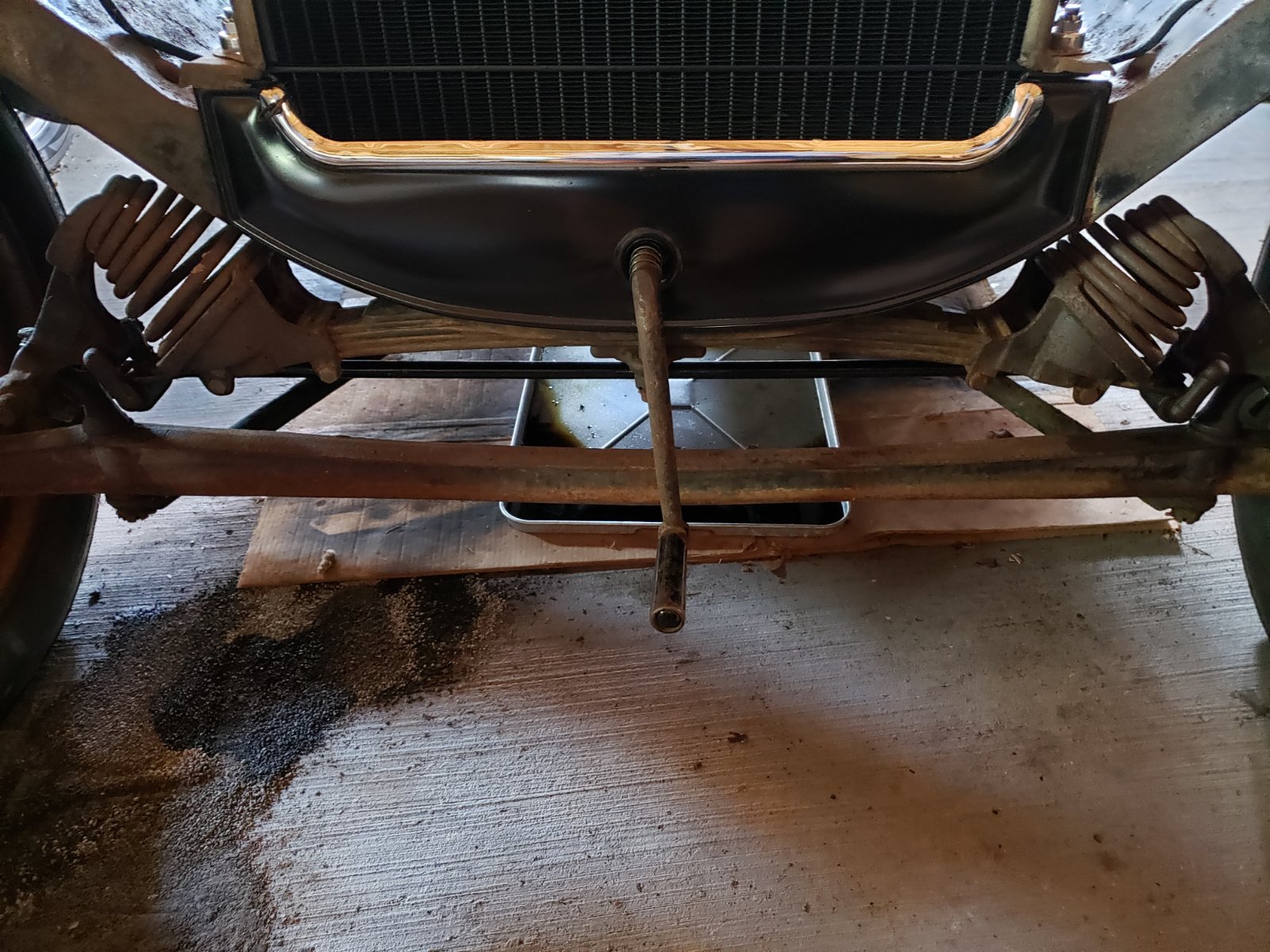

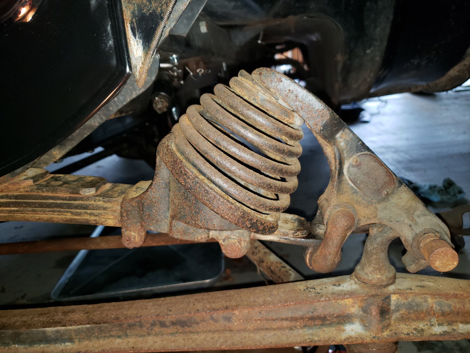

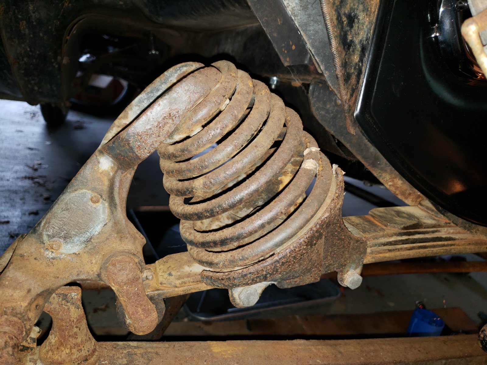

Hopefully these photos loaded up...uh hem....I had an oil leak that I fixed but haven't emptied the pan yet....that's my story and am stickin' with it!
Mike,
Looks like your main leaf is real weak!
Hank
Hank
Hank,
So you are thinking the lack of arch to the spring is allowing the Hassler to be too close to the frame?
- Posts: 5600
- First Name: Henry
- Last Name: Lee
Your Hasslers being flat with that front spring are taking up necessary space for clearance. Spring arch is very important.
Hank
Hank
Michael Jewell : I am attaching some pictures of my 26 CP as requested. I noticed that my Cp is using 1925 type spindles but I don't think they have any effect on the Hasslers. My spring arch is higher than you car's spring pictures show but not as high as a 1925 spring, maybe my spring has a extra leaf on top as a spacer.
Thanks Kevin! Really helps for everyone.
Soooooo....the conclusion is that my spring is worn out and needs replacing. If I get the new spring, will the Hasslers and bumper fit like Kevin's or will I need a spacer on top of the new spring to clear the bumper bracket? If so, how thick?
New spring project (for next year probably) added to my to do list. Hi Hank, how ya been?
