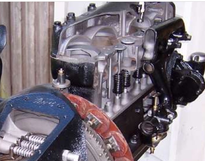

Items such as these heads were cast in numbers at one time, depending up[ the size of the object. Most such casting patterns had a letter or number for each item on the match plate. In that way if a casting showed defects, they knew which one on the match plate was defective. I assume Model T Head were cast in grey iron and then heat treated.
- Posts: 4047
Re: low head question
Darel
Correct on the heads made from cast iron.
Weren’t heat treated as my SawsAll wouldn’t have been able to quickly section, like cutting through butter, this freeze cracked
and busted high head to replicate a cutaway engine
