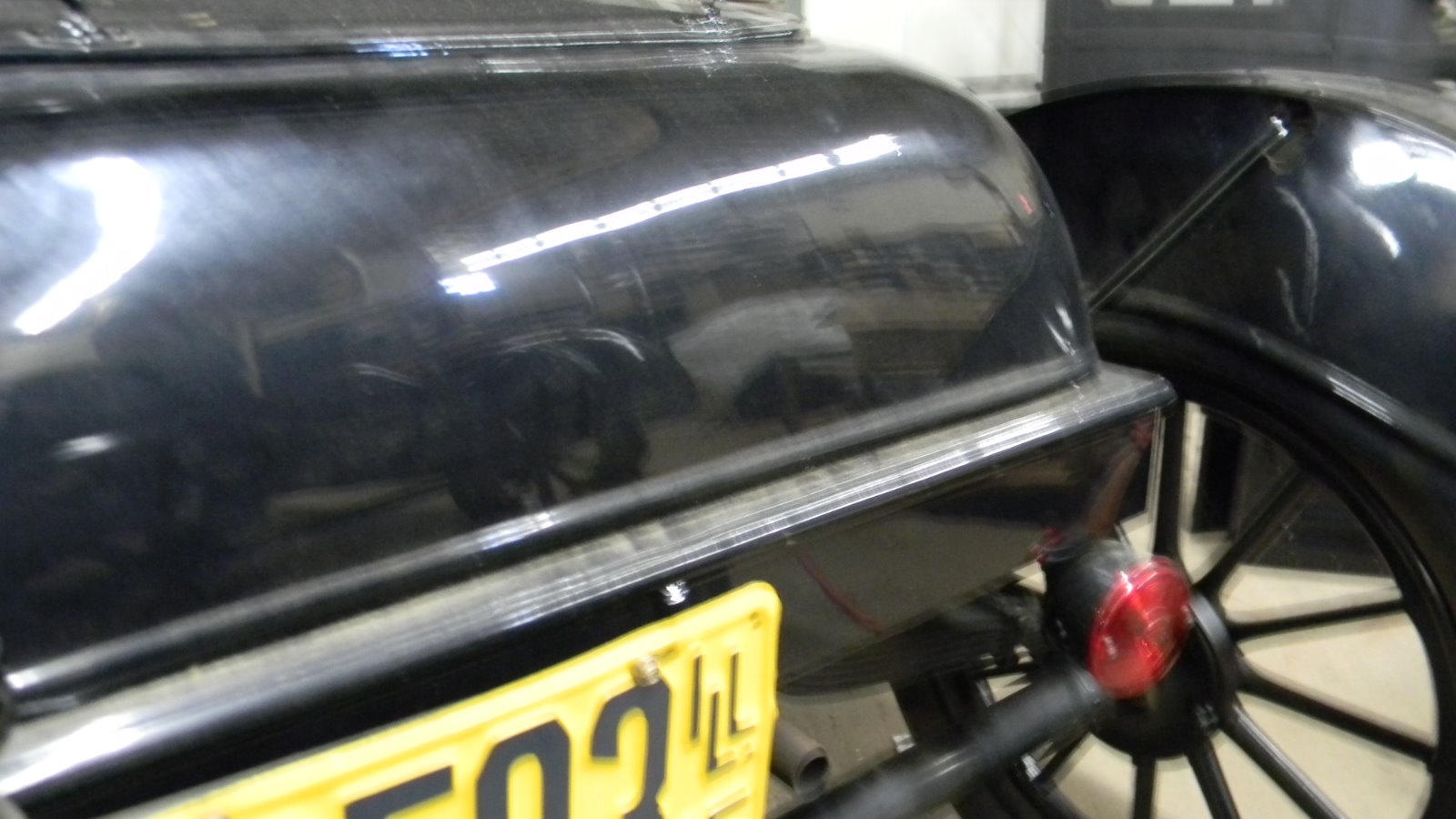

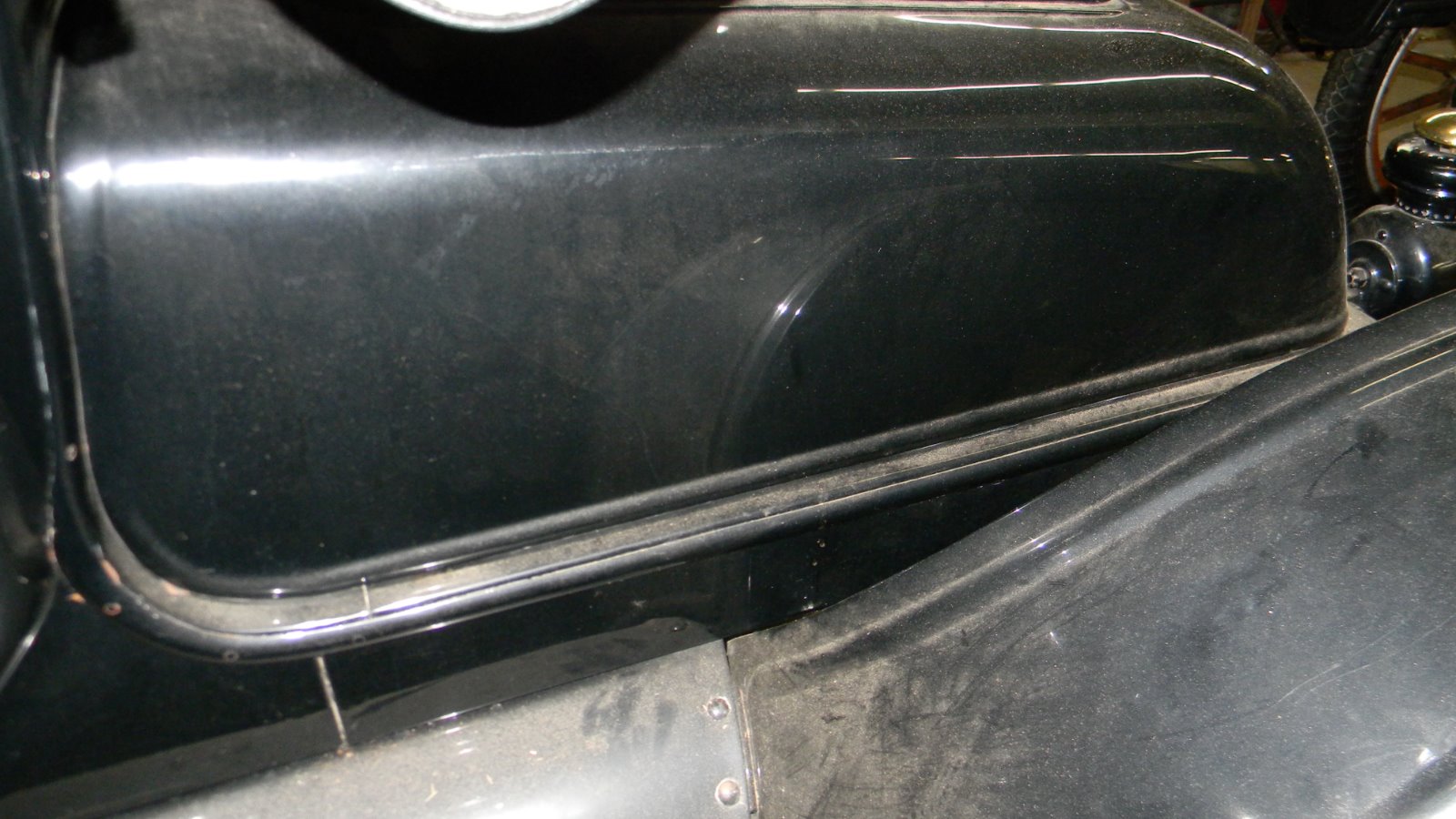

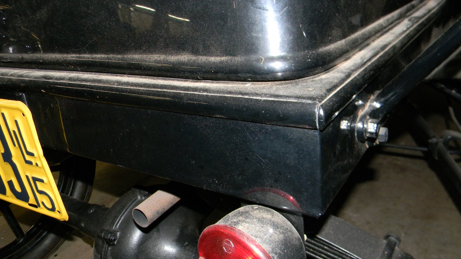

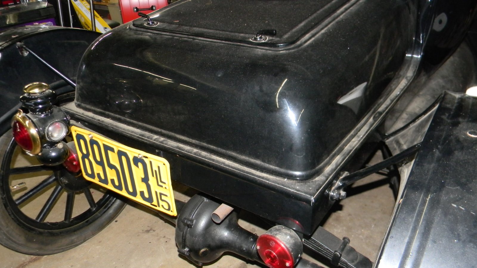

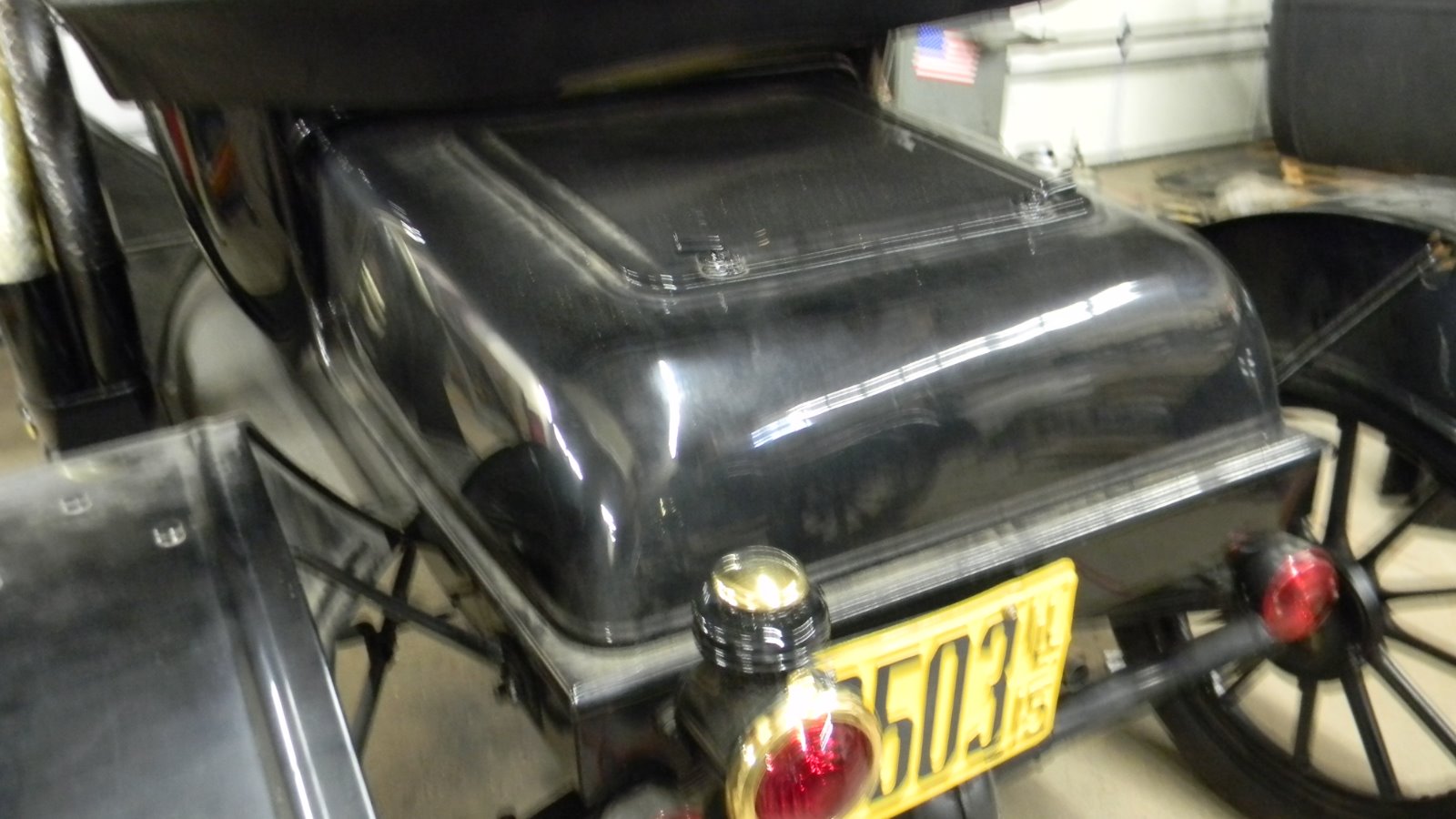

Here is a 1915, Bob

Thanks for the pictures Bob
