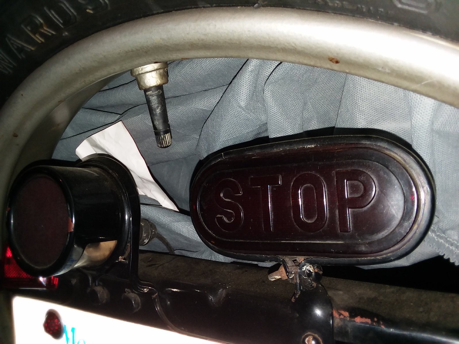

here is a picture of the lights.
I was hoping to be early enough they were not a factory installed item in '23. That way I would not need them to pass.

The taillight is factory, but you have what I believe is a 26-27 style light that was modified.
23 should have a more rounded back and mounts with a stud in the middle of the back.
Yes, the stoplight is an add-on accessory, but I see nothing wrong with adding any safety items.

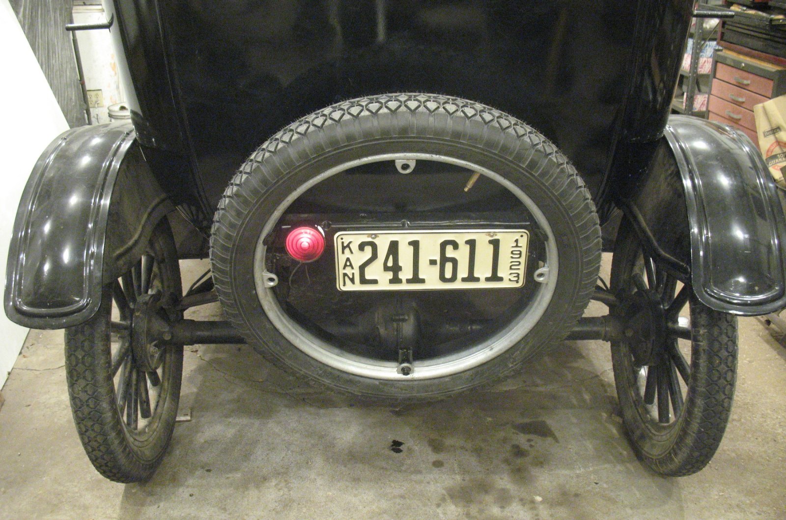

The left one looks like a stock Ford tail light. The STOP light is a swell accessory I would definitely keep. The T did not come with a brake light, but you can add one with a switch connected to the brake pedal.
1923 backside with stock tail light.

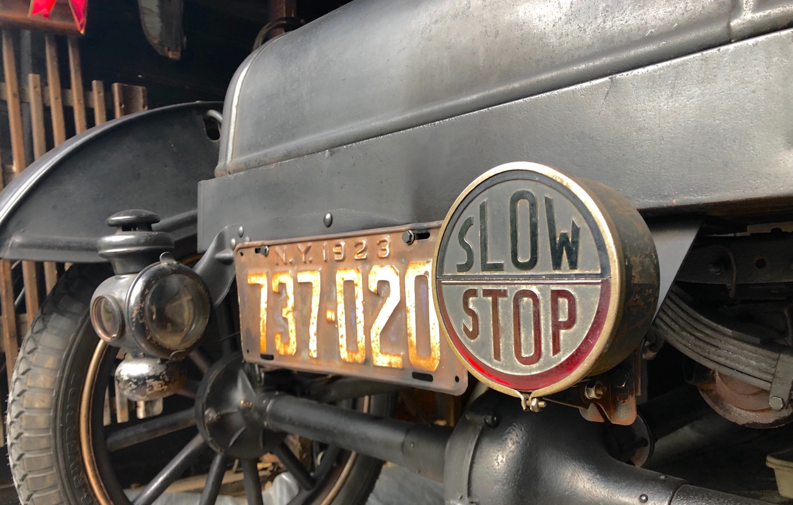

I also made a bracket to mount a vintage accessory SLOW/STOP light on the right side of the back. It comes up from underneath so no holes in the sheet metal. It has a large green SLOW lens to turn on with the headlights and the red STOP lens to turn on with the brake pedal. In both of those I have halogen bulbs that makes them very easy to see ... particularly the brake light during the day.
Evidently my low radiator ‘23 runabout was originally sold from the dealer without the starter package. It had kerosene side light and a kerosene Ford-O tail light. The Ford-O is an unusual variant that has a large clear lens facing the license plate and the small red lens facing the back. It takes a special stamped bracket that holds the lamp at an angle. I inserted an electric bulb in the tail light so that it turns on with the headlights.

Anyway this is how this stupid yankee has his stop light arranged.
