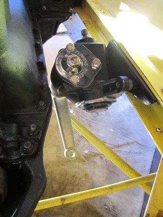

Hank, Thank you for pointing that out, helps in thinking about everything else too. Yes the first thought was somewhere between the firewall and stock steering box. But I have no measurements yet for where anything will line up. Here is a picture of a Vega Box hooked up to a T frame, any issues with this setup?

- Posts: 5600
- First Name: Henry
- Last Name: Lee
Re: Steering Quickener
Yes, will post you some pics later tonight. Glad to help!
