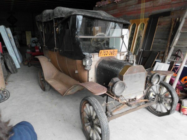

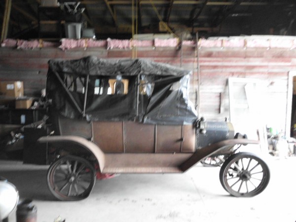

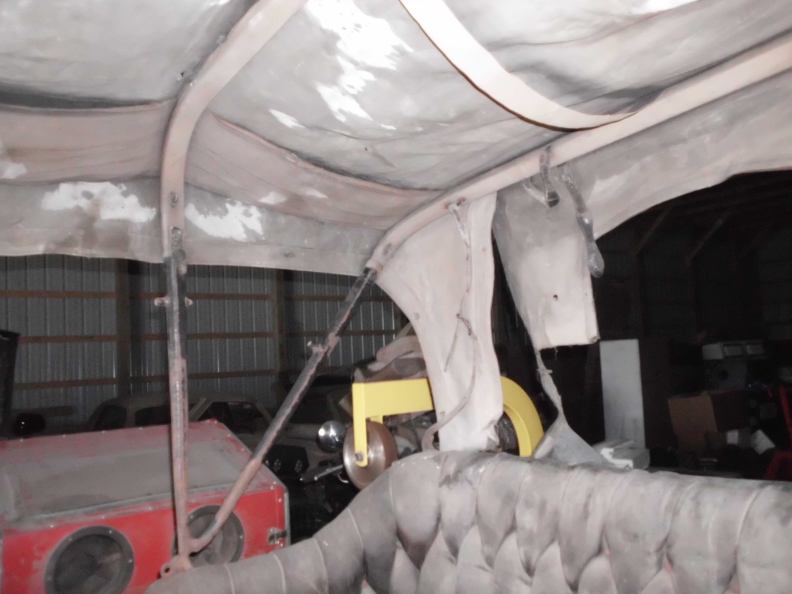

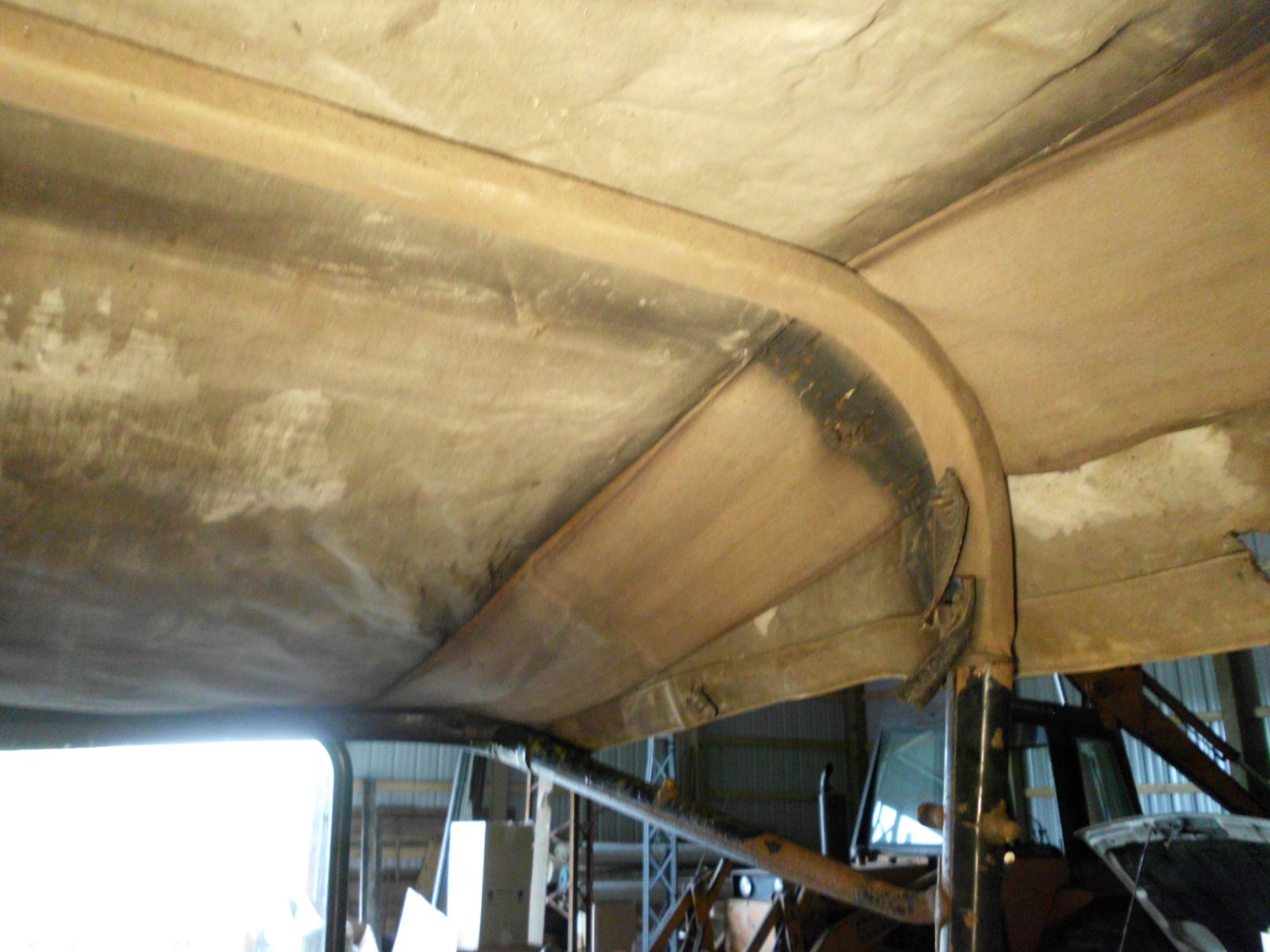

I don't know if mine would be of any help but maybe it will. It still has the original top and is not restored. I just don't know where to start to get what you need and am tied up with other things right now that can not wait. I also have the side curtains that came with it. Everything fits together real good. If you can hold out for a while till things settle down here I am willing to help. This is the reason I decided to preserve this car rather than restore it. Please note that in my pictures the top is not held tight due to missing or broken straps and some fasteners are missing or damaged so the corner of the front section of the side curtain is loose and so it sags but the location of the damaged or missing fastener may still be intact.
These are the only pictures I have in this computer but more can be taken since I was not looking for anything when I took these and some are not the best quality. Hope this will help for now.

Thank you so much for posting the pictures. They actually help a lot! I am able to see all of the fasteners, I believe, except any between the 2nd and 3rd bows. I assume there is one fastener between those two bows as there seems to be between bows 1 & 2 and 3 & 4.
I will also need to make side curtains after I complete the top. I would appreciate any additional photos of them when you have a chance to make them.

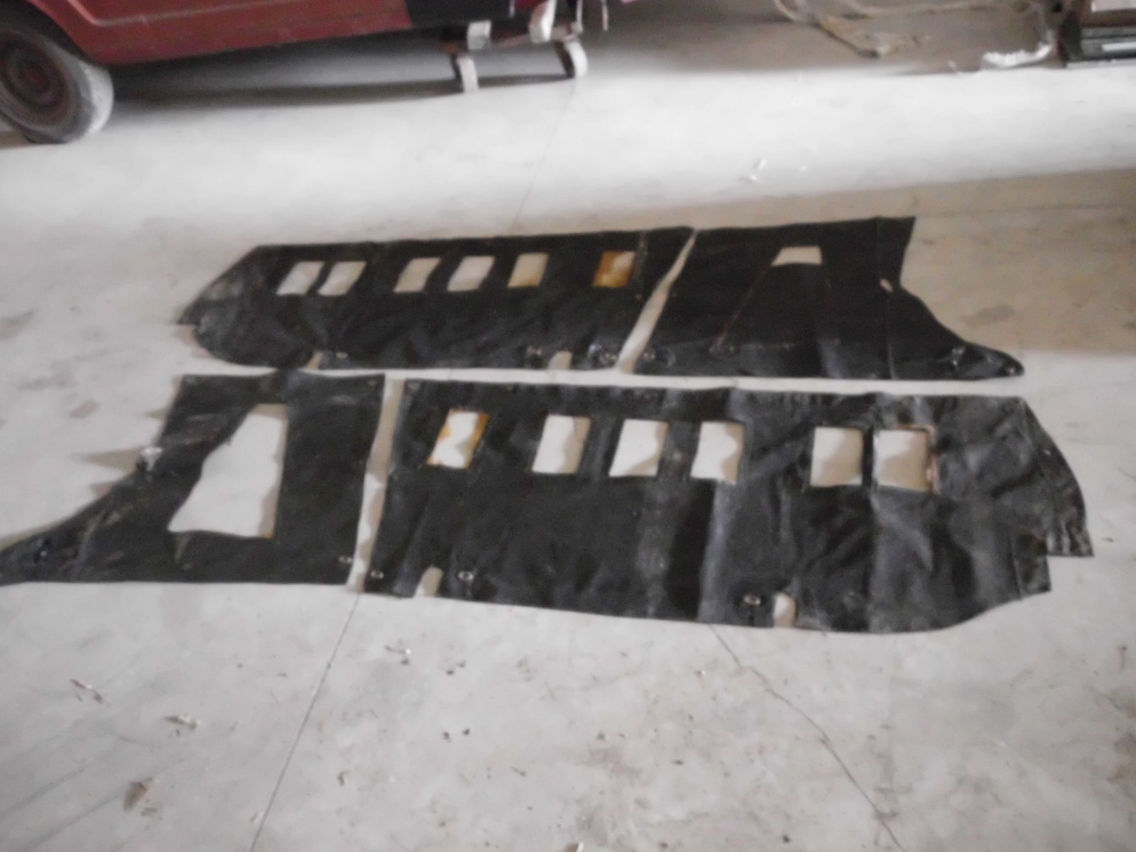

I will take some better pictures for you and measure from a point on the top that can be found on other cars to locate them. Also I loaned out my side curtains to Mike at Clastique over the summer so he could confirm they are original and make a pattern and start reproducing them for people like you that will be looking for them. I guess good originals are getting scarce after over 106 years and I felt these would do someone more good in the right hands than just sitting in a box under my seat. If they got lost or damaged they would do no good for anyone.
