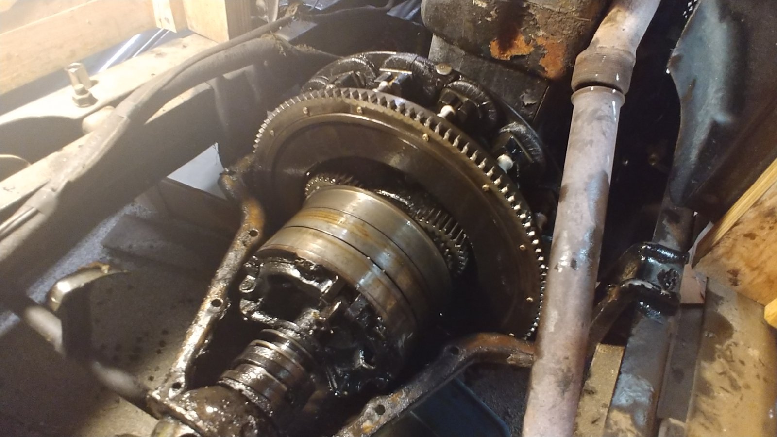

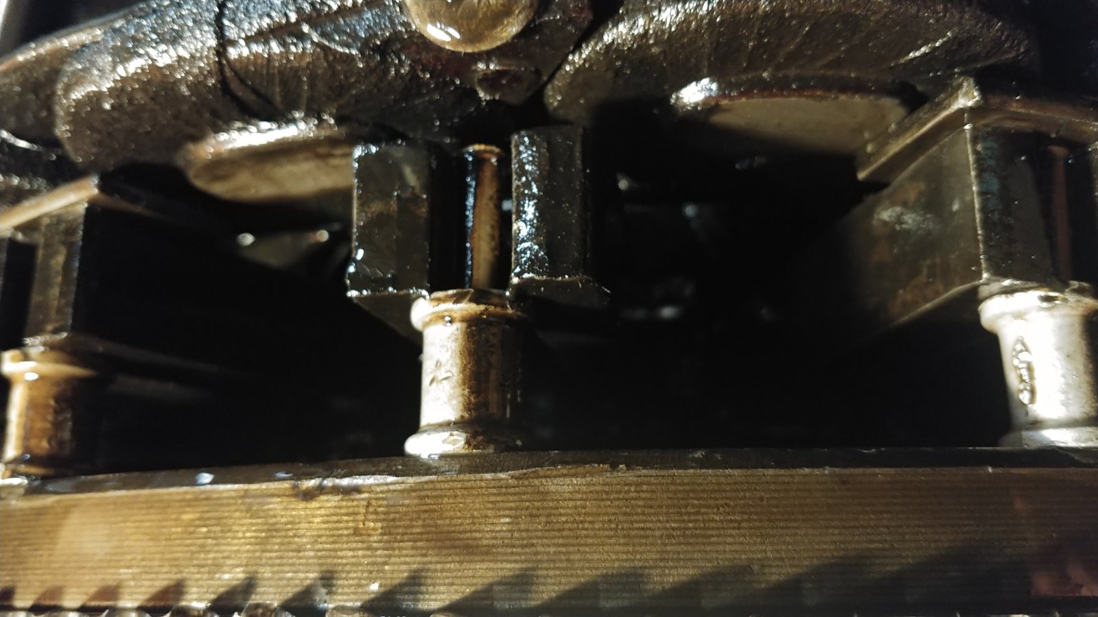

I was driving home and the magneto stopped working. After some troubleshooting I pulled off the magneto post and discovered that a stray magnet clamp was disrupting the connection.
I pulled the hogs head off and found the clamp. Luckily I caught this in time before any serious damage was done. Flywheel teeth, gears, and other parts look unaffected.
So my question. Before resorting to pulling the engine, any hope of replacing the magnet clamp and screw with the engine in place?
The good news is that I can easily replace the bands. I'll take the win where I can get it.

No hope. Flywheel and transmission have to be removed and once you put the new screw in, the height has to be set. If one screw let loose, I’d go ahead and replace them all. Takes a few specialized tools but it can be done in your garage.

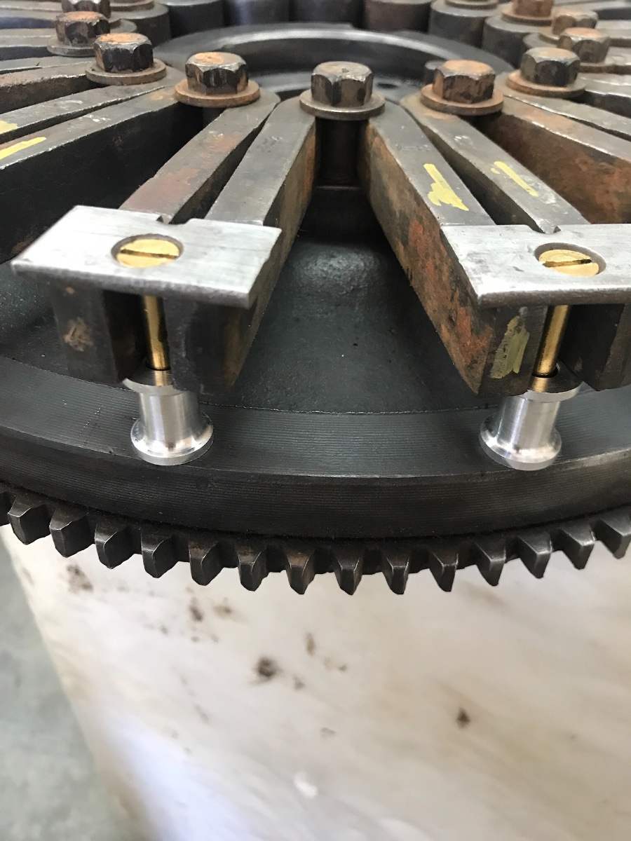

Thanks. Good suggestion, I'll play it safe and replace all screws and plates. What tools do you recommend I order to make the job easier and accurate? Do I need to tool below?

I would strongly suggest that you:
1. change all aluminum spools with new ones when the screws are replaced. From a metal fatigue and practical point of view, they are at end of life.
2. find a good original undamaged keeper and replace the one that came off and is damaged. Repro keepers are not made from as tough material as original and will warp considerably when tightened down making accurate mag ring spacing difficult with one new one and all but impossible if they all are replaced.
