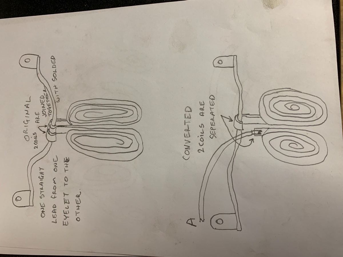

can this be done when converting to 12 volts

Electrically speaking, I can't see any difference with your modification. All the field coils are still in series, which then feed the parallel connected brushes.

thank you , its just, that it makes it easier to me to convert to 12 volts this way

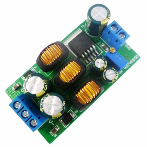

Not sure what 12 volt devise you need to run or why ts necessary but have you looked into one of these DC 6V 5-11V to 12V 10A Step up Converter Regulator Boost Power Module Input voltage 3.6~30V,output ±3~±30V adjustable There are all kinds & brands this one is < $30
http://www.denontek.com.pk/index.php?ro ... uct_id=202

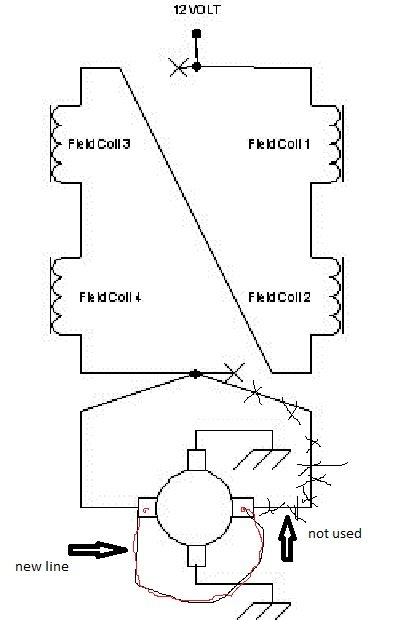

I’m looking at what your doing but your diagram looks like you are moving 2 wires
When I convert my starters I cut one side of the in feed bar one side
Then at other end I separate the 2leads at the brushes lead and send one Side of coil back up to top coil the same as your top half of your diagram
So you don’t need to move a brush

Your original unmodified diagram is the correct method, not the modified diagram.

Please elaborate --Y---

Hello Lorenzo,
As at least one person stated, electrically it is the same and that is true. What is not being factored in is the current draw, power, and heat.
Although I may not have accurate numbers, I have numbers that are in the ball park and will illustrate the problem.
A starter modified for 12 volts per your diagram will draw at least 150 amps and I feel that is on the low side while cranking the engine.
With the brushes wired per the original diagram that will be about 75 amps through each wire between the field coil and the brush holder.
With the brushes wired per your suggested change that would be 150 amps through the wire to the first brush holder, and
since there is unpredictable resistance between the first brush holder and the second, unpredictable currents on the first and second
brushes. This changes the power distribution from a balanced system as originally designed to and unbalanced system in addition to much
larger currents through the first wire.
I hope this helps. I may be able to expand on this more tomorrow evening if required or requested.
Respectively

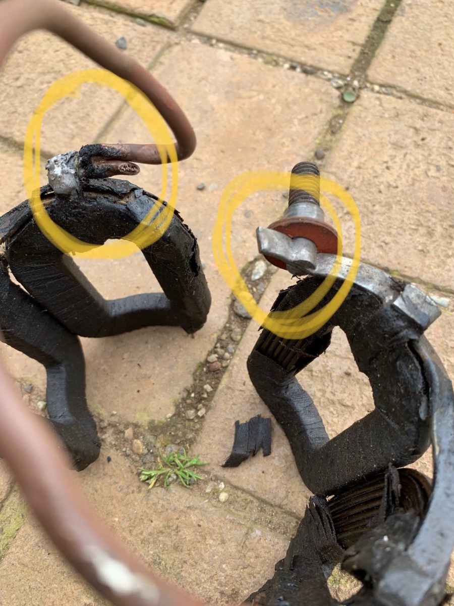

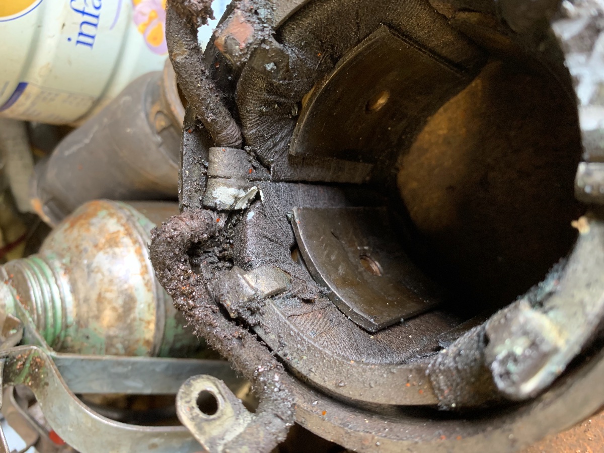

Hi Lorenzo I’m going to try and explain so her goes
The first pic is of an in modified starter and as you see the input bar is connected to both sides to a coil
On the other side there are the brush leads joined in the middle by two coils but the eyelets are on one continuous lead

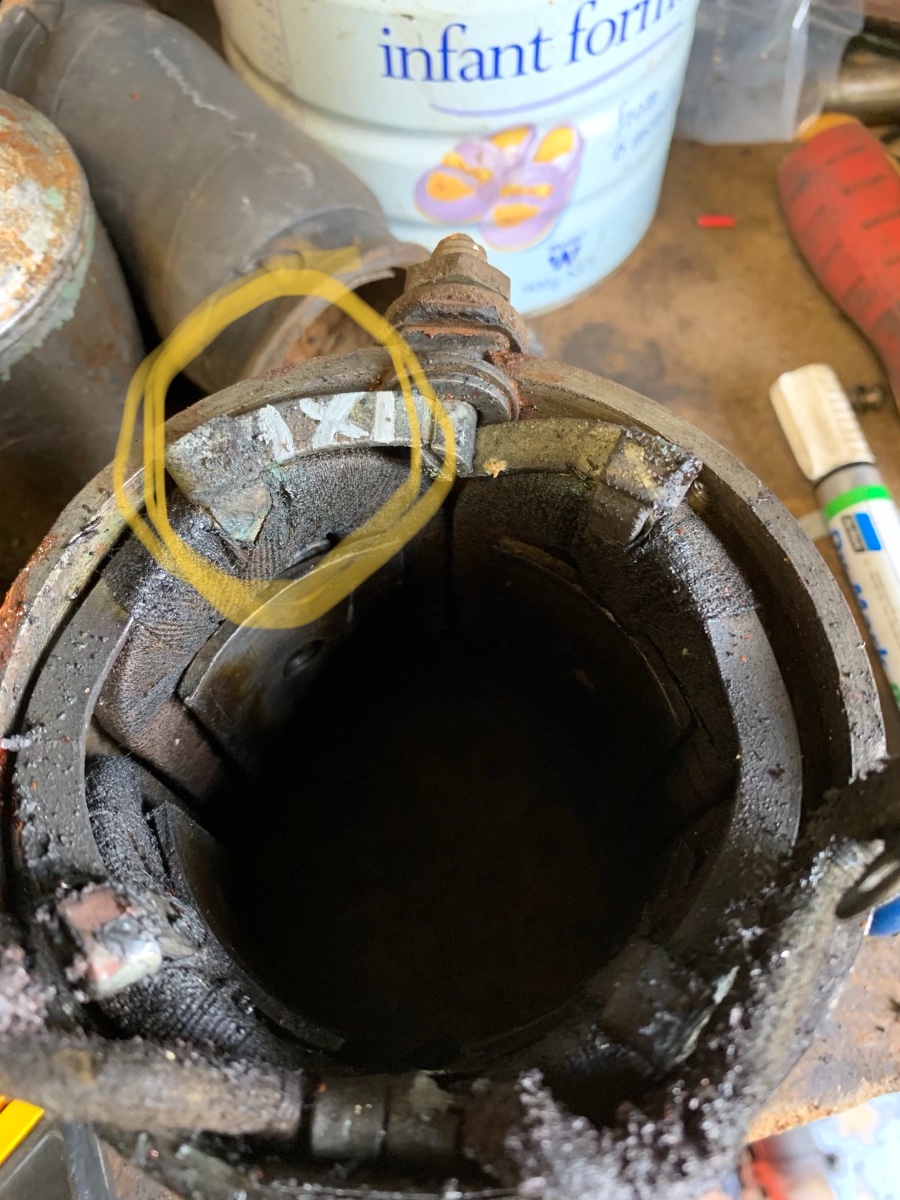

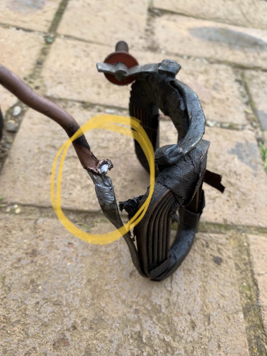

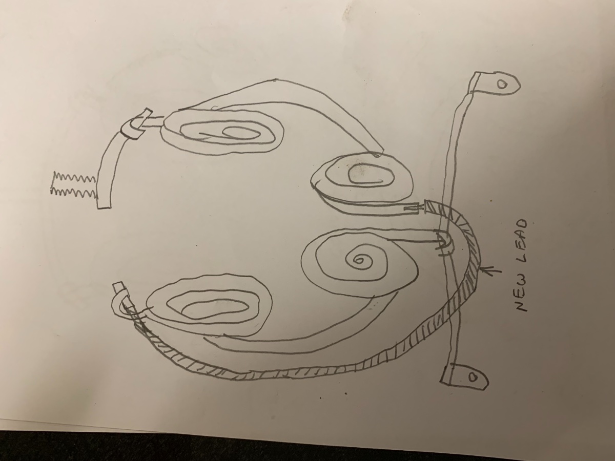

Part 2
I have marked in white where to cut on input bar and on brushes lead
On input bar I cut the left bar as marked on first pic
On second pic you will notice the left coil bar has a white mark on it that is the second detachment

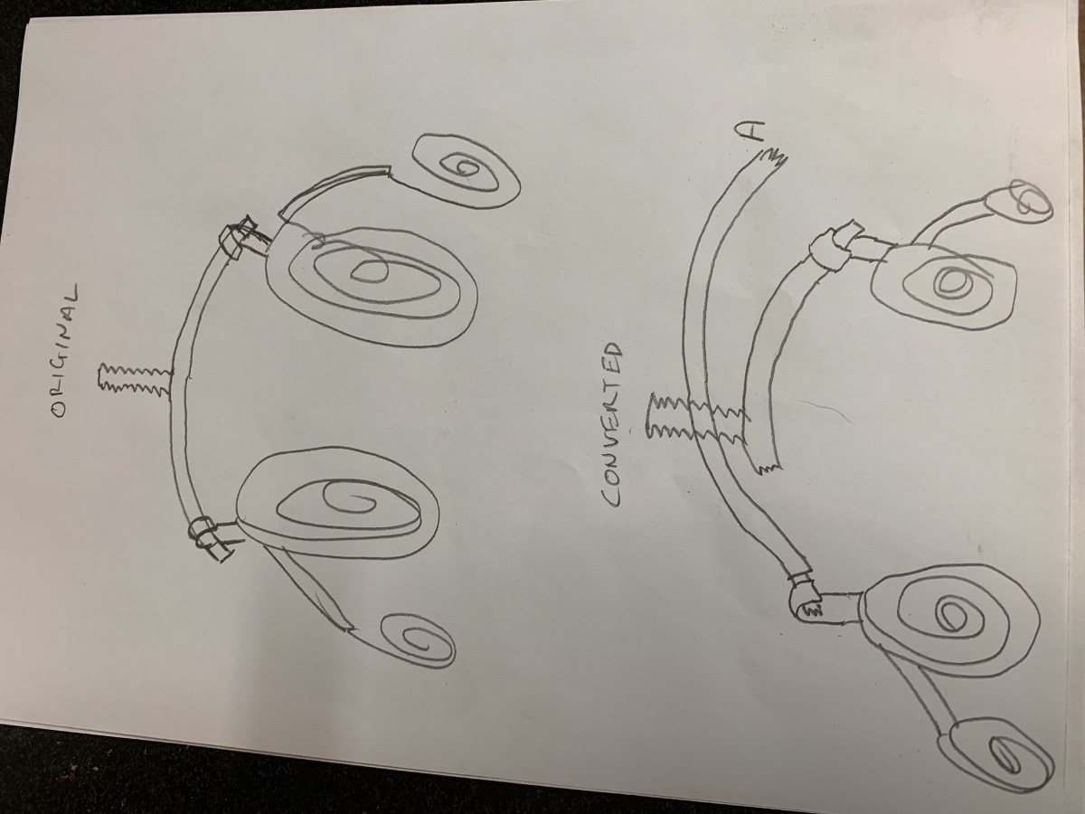

Part 3
These are a diagram that should help under stand how it is done
The reason I’m lost with cutting and rerouting a brush lead don’t make sense as your not modifying any of the brush part you are simply taking one of the 2 joined coil leads off so they are separate
The separate coil is simply having a new heavy lead soldered to it and sent around to the cut of input coil bar

From the looks of those coils there is no question in my mind why they did not work on 6V. I hope these didn't go back into a hosing like that.
