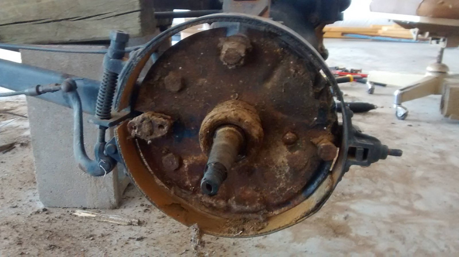

What kind of brakes do I. have? There is just one brake shoe that goes almost all the way around. It compress around the outside of the brake drum instead of normal brakes that have 2 shoes that expand outward contacting the inside of the brake drum.

Do they say Rocky Mountian on the brackets? Should have stock brake shoes inside the drum also.

Re: TT brakes
Rob,
Do you believe these to be "original" after market brakes or could they be newer, added in more recent years? They could be original Rockies, but they are not modern reproductions. Original era Rockies had the band anchored as shown in your photo. Later reproductions are anchored at the forward bottom end of the band. That's why they work better forward that in reverse.
Look at the brake pedal. Does it have the name embossed on the pedal itself? Also, does the brake pedal shaft have the cam to actuate the Ford transmission brake? These things will help us figure our what you have.
Also, Dallas is correct. There should be a pair of emergency brake shoes inside the drum.

I am away from home right now but will look when I get home. There are no brake shoes inside the drum.

You can find the shoes and other parts for E brake in the drum. Very important thing to have IMO.
- Posts: 4384
Re: TT brakes
I tend to be a bit against the prevailing opinions on TT brakes.
However, first, the outside semi-flexible lined part is generally referred to as a "band". Just to minimize confusion.
Stock standard rear brakes, whether you want to call them "parking brakes" or "emergency brakes " are quite different on a TT (truck) than they are on a "T" (car chassis). The TT rear wheel brakes are heavy duty, well built, and lined so that they are practical to use as an emergency brake. The standard T chassis? Not so good.
Either way, what you have is not the Ford factory issued brake. One problem is that because they are not factory standard, there are literally dozens of different ways for them to be set up. Not knowing exactly what you have, makes it difficult for us to give good advice. Whether they are operated by the brake pedal, or the hand lever, makes a big difference.
Outside band brakes were considered better for a variety of reasons. That is why they were manufactured and sold in large numbers. However, under certain conditions, outside band brakes are NOT as good or as reliable. That is why many people will recommend having the inside shoe brakes functional as well as the outside band brakes. Whether or not they are both needed depends upon how they are operated.
Where my opinion differs from the prevailing opinions is that many people recommend setting the outside brakes to operate from the brake pedal and also keep the brake pedal working together with the planetary transmission brake. I do NOT like that idea because I knew of a few cases where an adjustment issue cropped up and did cause accidents (fortunately, nobody hurt seriously, but significant damage to a few cars). The likelihood of such an occurrence in my opinion is far too great for that to be a good idea.
Whether the pedal or the lever is used, on either the inside shoe or outside band, and which on which, and where or even IF the transmission brake is kept serviceable, can be any of a few ways. Which is best depends upon circumstances, driving conditions skill levels, and personal comfort zones.
Most important. You should have two basically independent braking systems. Other than a wheel falling off, which would most likely bring your vehicle to a stop anyway, there should NOT be any one thing that could break or otherwise fail that would cause you to have no brakes.
Let us know what all you have, and we can give good advice on what direction you should go. And by the way? We like lots of pictures of model Ts and TTs!
