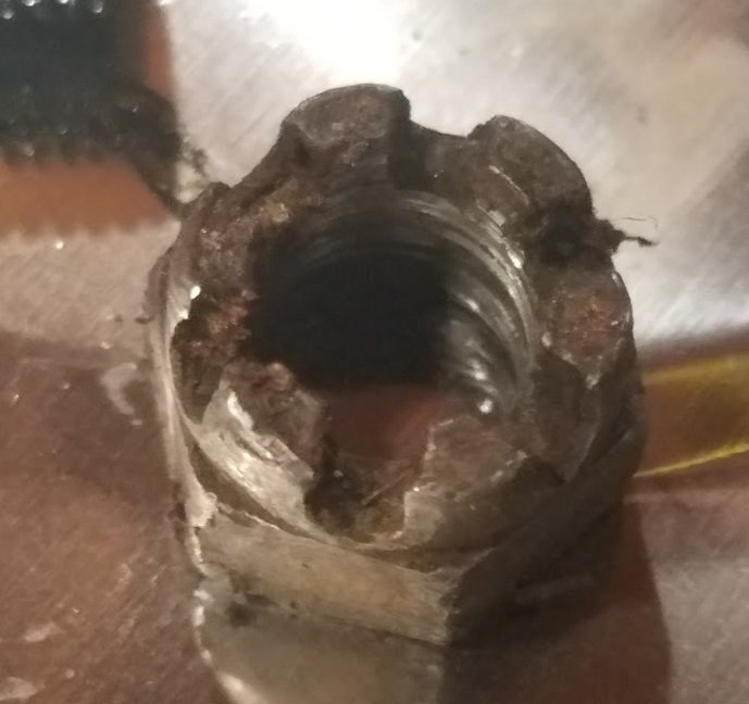

A couple of weeks ago I was driving down a hill, and decided to hit the brake suddenly. Suddenly there was a terrible noise from the transmission. I pulled over and looked under the car, expecting to see some disaster. The engine sounded fine, but when I hit reverse or brake, there was a noise like something wanted to escape. I found that if I drove very slowly, I could move in low. I nursed the thing to a friend's house. He said "well, what do you want to do? Do you want me to pull you home?". I decided to drive, cause there was no noise, if I went slow. My neighbor followed me in his truck, with a big pull strap in the back. All went well for a mile or so (all down hill and using the e-brake), until I got to the last up hill. It did not want to go with out more noise. I got pulled the rest of the way.
Because the sound seemed to 'definitely' be coming from the transmission, another friend and I pulled the hogshead. We saw nothing unusual. Later I pulled the engine, and still have not seen a smoking gun.
The only unusual thing I found was an apparently loose castle nut behind the pressure disk, when I removed that. Later I noticed that all the aluminum spools that mount the magnets were pitted in the direction of rotation. The crank case showed a funny 'sand blasted' area where something was apparently propelled against one side, also in the direction of rotation.
I have yet to complete the tear down, and may find something obvious like a big broken part.
Could the loose nut cause all this noise?

Darn right it could!!Could the loose nut cause all this noise?
You're lucky you still have a transmission in that thing. That nut has no business being anywhere near that engine much less inside it. The only thing I could think of is that it was used to set the distance on the clutch throw out (not being able to judge the size of the nut). Something as small as a lockwasher can destroy a transmission.
I can hardly believe the car has been driven any time or distance with that inside.

I think that it is a 5/16 or 3/8 nut. It must have found a 'safe' hiding place, maybe on a magnet, until a sudden braking shook it loose. I can't believe that it has been shooting around in there loose for a year. Last summer I made a 60 mile round trip and last month a 42 mile round trip, without any problem. Even drove in a Memorial Day parade. Just dumb luck. Engine at an idle sounded fine, only made noise when I tried to move.

I agree. It hasn't been bouncing around for long as you WOULD have known. If it is that small, it is a most certainly a 3/8-24 nut and has possibly come off of a pedal support bolt that was installed backwards.

It might have been off one of the connecting rods during a previous adjustment. Sometimes something falls into the transmission and does not cause any problems until it happens to get picked up by the magnets. It can be soon after falling or years later.

I bet that nut was up in around the magnets and got sort of tucked in. Probably been there since the rebuild. Stranger things can happen. I would check all the places inside the engine where it could have been used. Not that many as I remember. If you don’t see anything suspicious it was probably dropped inside the pan or was picked up on the bench by the magnets when being assembled in the shop.

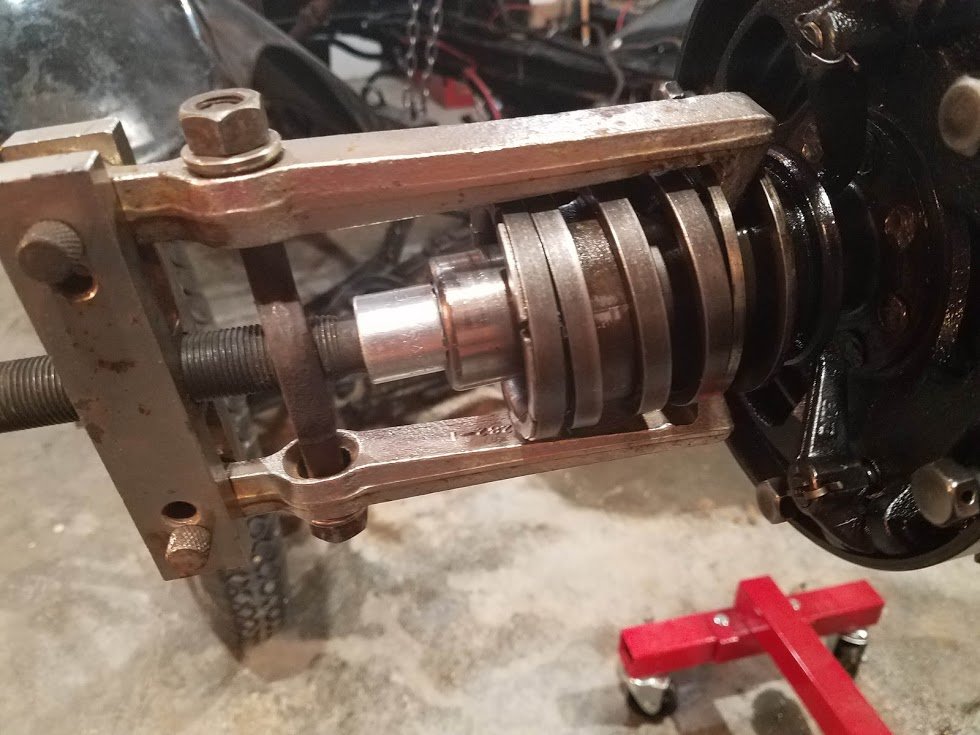

I messed up that last reply...
I'm having trouble pulling the clutch drum. I have a 'Steven's Repro' clutch drum puller. It doesn't open up enough to install the foot disk. I used a big nut instead, but as I tighten, the rig starts to shift off center. I'm having the shop at work, modify the foot disk. I used some heat from a MAPP gas torch. After I inspect the rest of the transmission, I'll look into the rear end. Not sure how to do that though. Thanks all for the support.
Also, after this 'terrible noise' happened, I could drive slowly in low without noise, but when I sped up or touched the brake or reverse, the noise kicked in. When Alan pulled me up the last hill, I was in neutral (clutch pedal pushed half way in, and lever in vertical position) there was no noise.

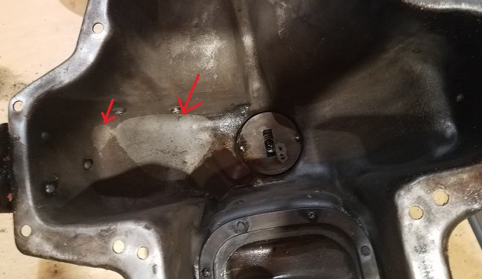

.Got the engine back together and installed. This is what I found: One stray castle nut. Evidence that something had been shooting around in the magneto space, evidenced by lots of abrasion to the aluminum spools that space the magnets. An area inside the crankcase where something had been blasting against it, consistence with the marks on the aluminum spools. The main felt oil seal on the crankcase was petrified. I assumed that the engine block side was the same, so I removed the crank to get at the felt seal. Turns out it was OK. Apparently replaced when the engine was rebuilt. I replaced both seal halves. I did find that the connecting rod bolts all had lock nuts (no cotter pins or wires). The manuals recommended not reusing the connecting rod bolts, so I ordered new ones with cross-holes and castle nuts. With the oil dippers, cotter pins would not fit, so I wired the connecting rod castle nuts. I noticed that one of the wrist pin bolts was not wired, so I tightened and wired that one. I found a lot of carbon on top of the pistons and in combustion chambers on the head, and cleaned that off.
I removed the clutch pack and pulled the clutch disk drum. I did not separate the three drums. I did not see anything amiss in the transmission.
After reinstalling the engine, and starting it up… The same ‘terrible’ noise was there, possibly worse. An angry clunking noise. Clunk, clunk…clunk…clunk, clunk. Makes you want to quickly shut it down.
A Model T friend came over to re-diagnose the cause of the noise. He determined that it was the rear end. After borrowing a spring stretcher tool, we removed the rear axle. Turning the u-joint on the axle[image][/image] / drive shaft assembly with various methods didn’t reproduce the ‘terrible’ noise. Opening the fill plug showed no grease at the fill hole. It looked like the rear end might be dry. Once before I opened the plug and a bunch of grease came out. It appeared like somehow engine oil was migrating into the rear end. The rear wheels did seem loose on the axles and had eaten up the shims that were supposed to tighten them. I split the rear end and disassembled the differential. The ring gear shows quite a lot of wear, but no broken teeth (looks worse in the photo). There was grease in the housing, not engine oil, just not up to the fill hole. There was evidence of leakage out the right axel at the wheel. There was also an accumulation of metal at the bottom of the case. The thrust washers were intact.
Back at the engine with the drive shaft removed, the engine starts and runs quietly (normally) with the shift lever vertical or in ‘parking brake’ position. But, mashing any of pedals stalls the engine. No ‘terrible’ noises. It seems like there is no neutral. Its like the clutch pack is stuck together (my guess). Looking into the inspection cover shows that the pressure is off the clutch push ring.
The loose nut in the crankcase was not a good thing but was not the problem. What could be the cause of the ‘angry terrible’ noise? Why is there no neutral? Could something be broken between the three drum assembly? Can I reassemble the rear end with a worn ring gear?
Any help would be appreciated. Getting frustrated.

When you have the rear end out did you take the pinion off the drive shaft and inspect the roller bearing and thrust bearing? I've experienced broken or disintegrating bearings on two occasions with varying symptoms.
- Posts: 6716
Re: Terrible noise coming from transmission
Richard
as I understand it, in addition to noise, the car has no neutral. How would a bad pinion bearing cause the car to have no neutral?
I believe that rear axle noises can sound like transmission noises, that from the pictures, his rear end has seen better days, and that even "no neutral" may simply be maladjustment following the transmission teardown. But with the present facts, as laid out by the OP, I'm not a fan of ignoring a symptom to fit a cause, which has to be done to point to the pinion bearing.
Whatever it is, I'm sure we both wish him a speedy discovery on the root cause of his trouble.

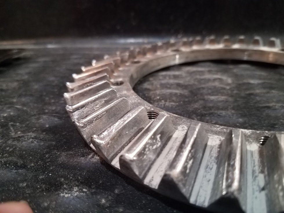

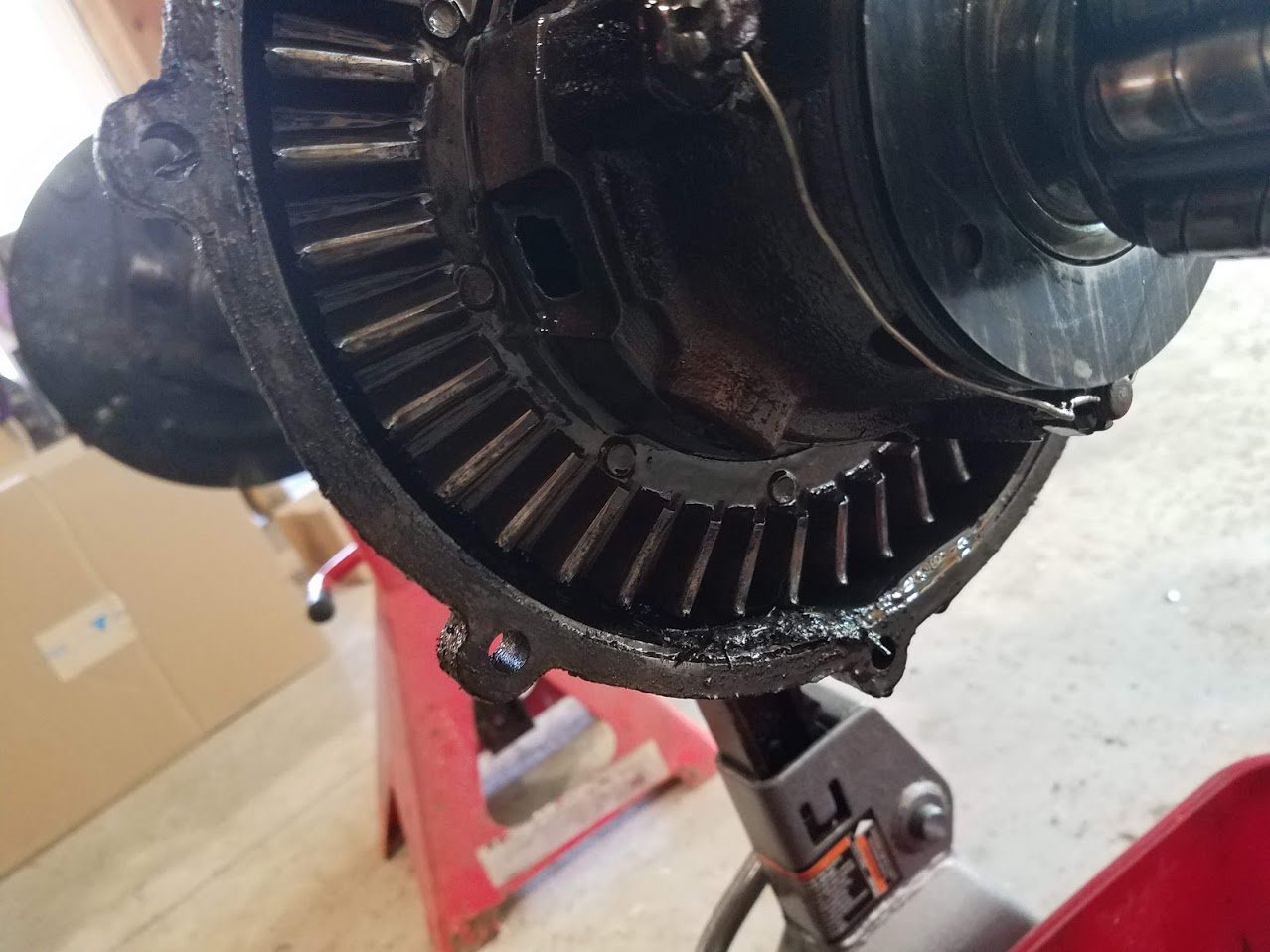

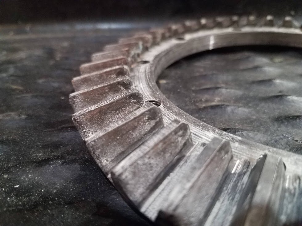

I see maybe three different things going on here.
1) That ring gear shows obvious signs of skipping over pinion gear teeth. It is beyond any further use. This is the cause of the terrible noise in the original post -SKIPPING TEETH. The noise sounds and even feels like it is right under the floorboards, but it is not the transmission! In the original post it was stated that the noise occurred while braking, trying to reverse, or under acceleration, but he was able to drive it gently as long as not climbing a hill etc. Classic gear skipping probably due to worn thrust washers or thrust surfaces if the pins have worn or sheared. The bad noise came from and is still coming from the rear end.
2) That stray nut in the engine doesn't belong there, may have made some noise sometimes, but apparently caused no harm other than the witness marks found on inspection. He dodged a bullet there, good thing he found it, but it was / is not the problem.
3) The transmission seems to have no neutral. The transmission was working fine in the original post. He drove it most of the way home and apparently had low, high, and neutral as well as reverse except for the noise. Something is mis-adjusted or out of place due to the disassembly and reassembly of the transmission during inspection. Possibly in the reassembly of the clutch pack or the timing of the triple gears.
Overhauling the rear axle with new ring and pinion and thrust washers will end the noise. Finding and fixing the transmission mis-adjustment or mis-assembly problem is the next issue.

I just blew up the photo of the ring gear which I had not done previously. Looking at it closer, I now believe you are correct, as is the advice to look into the pinion bearing that Richard gave. I made a significant mistake in not viewing the picture closely enough and giving poor advice. Like you, I believe now that the rear end rebuild will solve the root cause of the grinding when putting on the brake. As far as no neutral, who knows, but it will likely be sorted out shortly.
That was a good catch, and far more obvious than I could see.

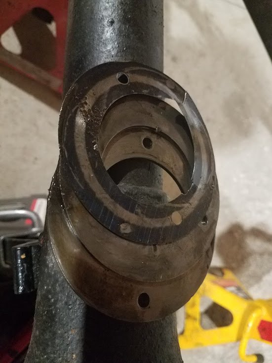

I do have new bronze thrust disks to use. I didn't like the look of the tapered end of axles, and ordered a new pair. Have seals coming for the outboard ends of the axles.

What I found in my rear end: There did not seem to be a lot of play. The ring gear is worn. The pinion looks pretty new. I found a better used ring gear. Both ring gears look dusty. There have been in the vibrating parts cleaner. There were no babbitt thrust washers, just three shims on each side of the ring gear carrier. One of the thinnest shims was torn. I have new bronze washers and two new axles.
- Posts: 4694
I don't know whether the picture is of the ring gear which was in the car or the "better" one, but it looks quite worn, and I, personally wouldn't use that one.
- Posts: 5506
That washer on top looks pretty bad! There had to be a lot of back and forth movement in the whole assembly as it is no where close to the proper thickness. Is that the ring gear that came out, I sure would not reuse it. Hopefully the pins that keep the steel thrust washers are in place and in good shape, if not I would replace them too.

One picture is of the 'better' used replacement ring gear, the other with the little spikes on the outer end of teeth is the gear that came out of my car (with the terrible noise).
On my previous 'engine in place test': I had the drive shave disconnected, hogshead on, all bands backed off. With the shift/parking brake lever vertical or pulled back: with the engine running, any pedal pressing tried to stall the engine. I have to think that the clutch spring was not releasing. Not sure how that could be. I thought that the bronze clutch release ring was in the right place. I think that there was still pressure on two of the three clutch fingers with the high speed clutch supposedly released.
- Posts: 6716
Given that the ring an pinion were slipping on each other, the pinion is not undamaged. For the savings of $179 for a new pinion gear, that is false economy, believe me. Replace them as a set. New. You've gone through a lot of pain and time to get here...

The bronze thrust washers that I received have no small holes in them for pins. Why not? Do I have to drill my own?
jab35
- Posts: 1027
- Last Name: Bartsch
- Location: Dryden, NY 13053
John: The brass or bronze thrust washers fit between two steel washers that are captive by the pins. The pin protrusions must be slightly shorter than the thickness of the steel washers. And it is likely you will need to remove some brass/bronze washer 'thickness' to achieve the correct ring/pinion mesh. This is well explained in the mtfca rear axle rebuilding book and also in numerous past posts on the Forum. Happy T-ing, jb
- Posts: 5419

Thanks all. I have the manuals. I have to replace sheared off thrust washer pins.
Question: How do you press the gears off of the axles if you don't have a press?

Anthonie, Thank you for the offer, but I live in New Hampshire USA. Maybe too far to be practical.
- Posts: 6716
The gears don't often need replacing, though sometimes the axles do. Just mentioning this, because unless one or the other is worn out, there is no need to go to the effort. FWIW.

I have two new axles. The old ones are a little rough. Leaks grease on one side, and the wheels are a little wobbley, even when tightened. The gears do look Ok though.
- Posts: 6716
There's an excellent chance that the wheel hubs are shot if they wobble even when tightened. New axles will be ruined by bad hubs if given the chance. Just make sure the tapers are straight in the hub...a quick check though not super accurate is by simply laying a steel ruler in the taper and seeing if it rocks fore/aft. Also, when the wheels are on the new axles, the axle nut should JUST clear the cotter pin hole. If you need any washers or shims, the hubs are done-for (and they wouldn't be the first).
The modern replacement hubs are VERY well made.
