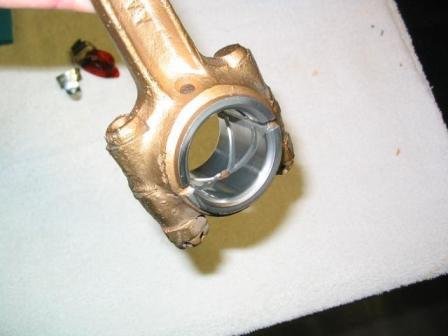

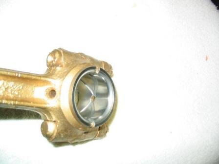

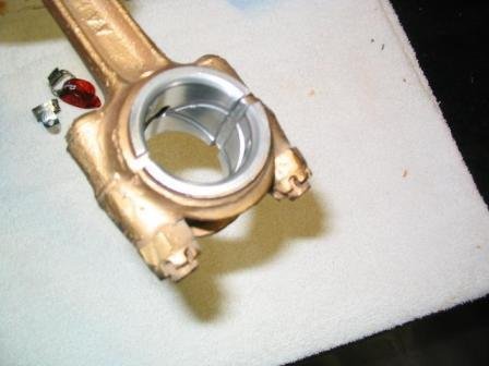

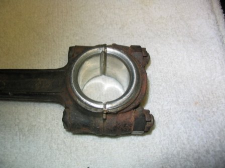

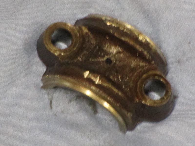

Holes in the cap, or web, and a Dipper will do no good, unless the rod has a X Groove System.
The holes in the web should be 3/16, and drilled on both sides of the web.
The cap should be drilled with 3/16 hole, and not over 1/4.
With out the X Groove, oil can not enter the bearing. It would be like trying to put water in an up side down grass, until you relieve the pressure in the glass, to make it flow through.
The dark rod is a spun poured rod of about 1930, from the clawson & Bals Co. The gold rod is one of ours we took to swap meets.
Herm.
