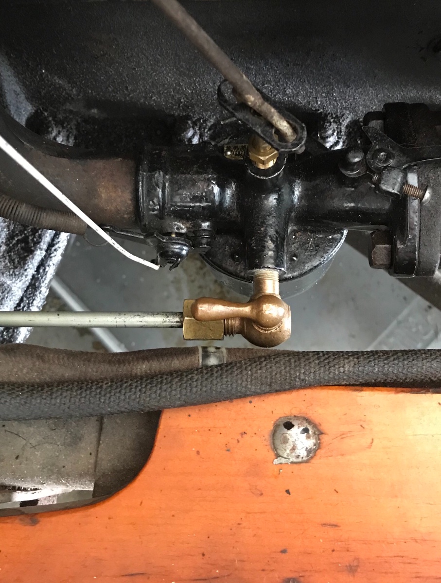

To save my mind and a trip under....is this Open or Closed ? I’m having a brain-spasm today

it's "on"

I put a SMALL pinpoint of green paint on the handle and another on the fuel line so when they line up, It's "on" Works for me. Bobt

If the handle lines up with the gas line, it's on.

Its on and when the pinion line up the gas line or if the pinion pointed the carb is off. Hope that help! I have the same pinion wich is original.

Those who posted are very likely correct, but a positive proof, if the engine will run would be to turn the valve in the direction toward the carburetor and run until it runs out of gas. If that doesn't happen within a few minutes, try the valve in the other direction and you will know for sure. Problem with having the valve at that location, it will work for parking to keep from draining the tank, but you will still need to crawl under to turn it off if you want to remove the carburetor.

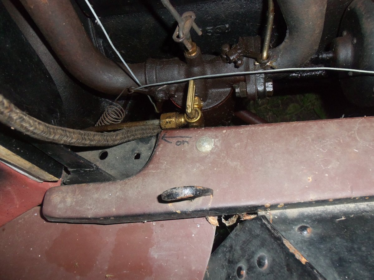

I'm so darned forgetful and so many valves to remember. 80's Kubota engine coolant drains and even 100 year old water drains on some engines/tractors are opposite of what one might expect but coolant drains are easier to learn. With a piece of wire to test!
My solution.
UGH, yes I know it's a rats nest of incorrect in there.
My solution.
