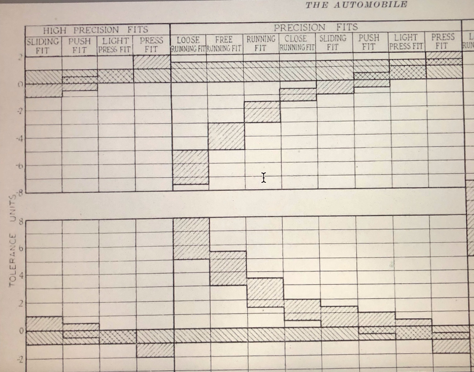

Here are Ford's service tolerances, 1st column is factory new, 2nd column is allowed service tolerance, when over/under tolerance, repair or replace.
If the gears are very nice, and bushings have proper service dimensions on the pins, one can reuse.

Dan, Where did that chart come from?

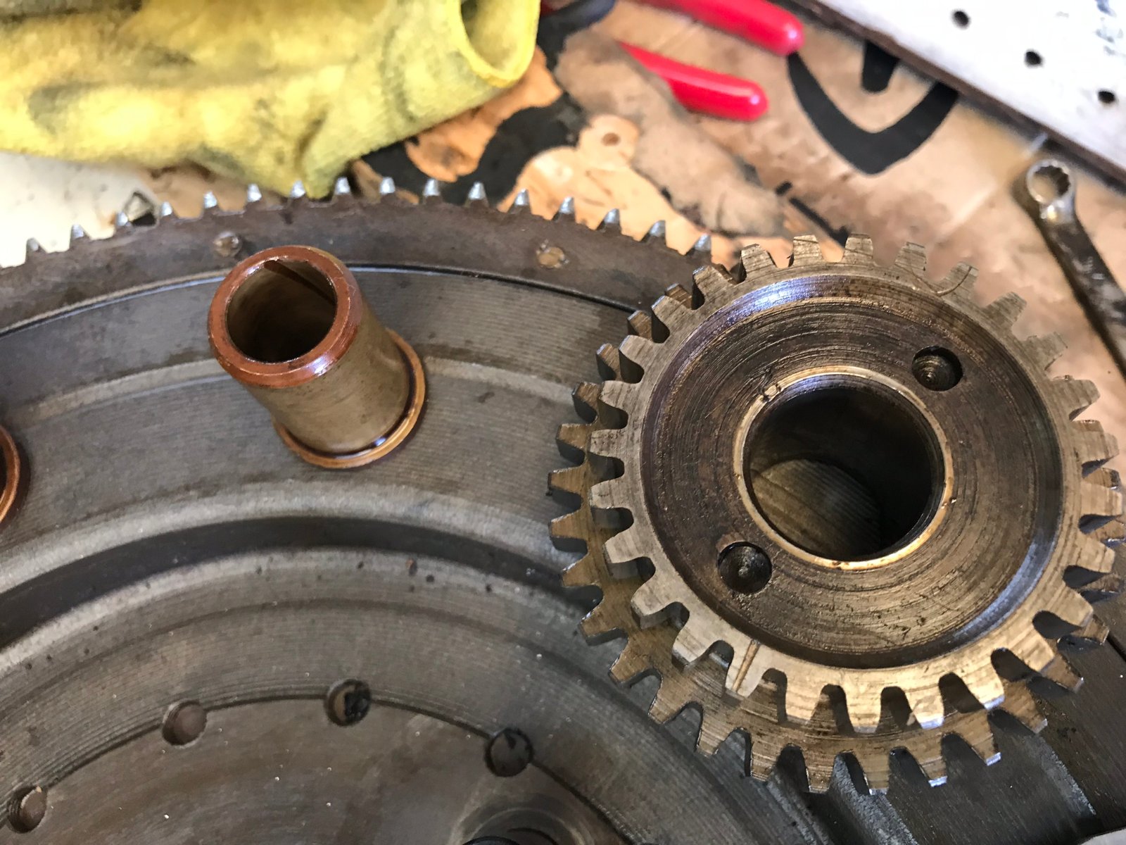

I've never seen a bushing wear so thin as the one that has left only the thrust remainder on the flywheel, nor have I seen a spun gear wear out the bushing quite like it did. Often times, even silent transmissions have a bushing welded onto the pin and spinning happily within the gear. This looks like a lubrication problem to me. Chicken or the egg...who knows?
It also looks like the drum assembly was not stable within the triple gears and wonder if the front bushing on the brake drum destructed first and oscillated within the triple gears. Oh, to be there for the teardown...

Nope. 2 of them spin freely on the pins and all three wore basically the same - look closely at the gear wear pattern in the flywheel that shouldn't be there. Funny how so many folk "know" exactly what happened. As a trained engineer, what I know is that is all speculation at best. I am up for testing the metal though... not that it will ultimately lead to anything conclusive.

That broken triple gear is the first tooth problem I have ever seen on a triple gear. I agree that most restorers make the triple gears too tight on the pins causing all kinds of problems. I have seen many with the bearing loose in the gear and many where the face has worn such that the gear touches the flywheel.
But that’s the first bad tooth😎😊

i am going to replace the pins only and let it roll. philip

RUNNING FIT
Note: In the Ford Service Manual, page79, Par 292 Ford uses different terminology to describe clearance. For the transmission triple gears he says 0.002 running fit. For all other bearings in the Model T Ford he uses the term clearance. On page 80 , Par 295 he says that if the clearance between the transmission bushings and shafts exceed 0.005 clearance they should be replaced. Obviously running fit is different than clearance.
Clearance means the total distance between a shaft and the bushing as measured with a feeler gauge. In this case the shaft would be against one side of the bushing leaving a gap to the other side of the of the shaft. This would be the clearance.
Running fit means that the shaft is on center of the bushing leaving a gap or clearance to each side. We believe that Running fit, 0.002 in. means clearance on all sides of the shaft or 0.004 In total clearance. This is particularly important with the triple gear bushings as they are under the most stress in use.
This point is highly disputed by many who claim that all the bushings should be reamed for 0.002 clearance. If that were so why didn’t Ford just say that instead of saying 0.002 running fit for the triple gear bushings?
Everyone I know of who set their transmissions up with 0.002 clearance have had their triple gear bushings seize on the pins. The drum bushings only survive because the drums turn at a much lower speed and for a shorter period of time.
Experience has proven that the bushings need 0.004 In. clearance to survive. Herman Kohnke says that his KR Wilson reamers ream the bushings to 0.003 in. I believe that Wilson screwed up on this. The bushings may survive at 0.003 but you are taking a risk. We all know that they fail at 0.002.

The Ford Service does mention the tolerance of the reamed triple gear bushings as a 'Running Fit' to the shaft of the triple gear pin.
That 'running fit' is one of the classes of tolerance for fits.
The Ford blueprints call out the tolerances of the pin and the reamed bushing
Pin shaft tolerance: .6770 -.6775' O.D.
Reamed bushing tolerance : .6785-.6790 I.D
So the tolerance or fit between these parts ranges from .0015 -.0020. That leads to a 'clearance' of .003" to .004".
These are the numbers that are successful for Glen and Herm and others, when done right with the good workmanship of aligning the drums and gears for reaming.
Murray Fahnstock with his Ford Power Plant chart of service ( I posted above earlier) listed .005" as "serviceable" but I can attest that .005" makes for a more noisy set of triple gears , as I had my last engine set for 'safe' clearance, but..oh boy. ;)
Found this info in The Automobile , 1916, to describe the classes of fits, you can see that a "Running Fit" is in the middle of the pack of precision fits.
The upper end of the chart is for shafts, the lower end of the chart is for bores, or the reamed bushing. The # on the left of the chart are tolerance units, if you look at "Running Fit" and look down on the lower chart you can decipher the range of about .0015" to .0035" or so, that is what Ford stated as the .002" running fit , it makes it on this chart in the middle of the grade for a running fit.
And listed definitions:
Fit in general denotes the physical correlation of two parts joined tog-ether, and is characterized by the clearance or interference.
Clearance is the free space between bore and shaft.
Interference is the amount by which the diameter of the shaft to be inserted exceeds the bore.
Allowance is 'the difference between shaft diameter and bore; it is positive when the shaft diameter is greater than the bore and negative when the shaft diameter is smaller than the bore. Positive allowance is interference; negative allowance is clearance.

Dan, Your chart says tolerance units not clearance. What does that mean? Glen

If we knew if FORD was using BORE BASIS, SHAFT BASIS, or BILATERAL BASIS, we would have a better grasp of what ".002" meant. However, with research in 1920's documentation, I think we can figure out EXACTLY what ".002 tolerance" meant.
Regarding the Chart that Dan provided, the upper left portion is tolerance for Hole Basis, while the larger portion of the chart is for Shaft Basis tolerancing and it represents the GERMAN basis for fits. This chart is difficult to use and was not fully incorporated for use in USA at the time.
Industry in Europe, UK, and United States were conflicted regarding tolerancing and class of fit, regarding types and how to break down those classes. In the United States, for awhile, the American Engineering Standards Committee, sponsored the American Society of Mechanical Engineers to issued a questionare to industry to quiery them regarding the MEANING of their IN HOUSE tolerancing regimes. Society of Automotive Engineers (SAE) settled on a system where tolerances were set at "plus" for bores, and "plus" for shafts, where the low limit was the "nominal" size called out, which was found to be very hard on gauges when establishing appropriate fits of parts. In Germany, just the opposite was the case, where "nominal" was the high limit. In 1921, America was still struggling with standards; which to use, how to apply, how to verify. It was a disaster and allowed for line/line fits on parts meant to rotate...BAD
In 1921 standards had STILL not been settled upon, but progress was being made. Finally, as they worked toward standardization of what "tolerance" meant, they conclude with: "It is the opinion of the Bureau that in general the minimum hole should be of basic size and that the tolerances on the hole should be plus, and that the maximum shaft should be of such a size as to give the quality of fit desired, all tolerances on the shaft being minus." This, however was STILL not the final word, thus, the one FORD drawing with a "tolerance" cannot at ALL be interpreted by today's standards with CERTANTY. Period.
And yet, with FORD being a leader in manufacturing, it is absolutely to their benefit to adopt what was recommended, so, If, on the other hand, FORD was going by RECOMMENDATIONS, then there you have it, in 1921 language for NEW manufacturing, the RECOMMENDED standard is: The standard is nominal "hole" plus .002 and nominal "shaft" minus .002. So, how about that? FORD drawing recommends ".002" tolerance. Just as recommended. Which is NOT necessary the TOTAL clearance, nor a mandate to have .002" "on both sides". It is the TOLERANCE, and now you know how to apply that .002" in the drawing.
This would explain why you find .004 (max) clearance to be a good, serviceable and reliable bearing for new Triple gear bushings, and why an "average" fit of .003 reamed by Stevens/KRW was chosen.
