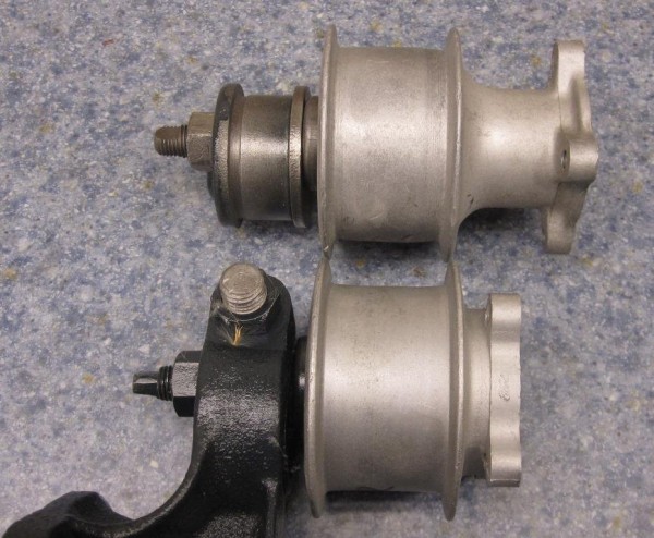

Re: Fan, distant from radiator
The pulley I removed looked like the one on top. The new pulley with ball bearings looks like the bottom. I installed a 2" spacer and boy can you feel the air going into the radiator. With the old pulley you could barely feel the air going into the radiator. I ran it in the shop for about 15 minutes and the temp ranged from about 190 at the rear of the head to 210/230 at the water outlet. At the outlet the temp would go up and down some. Radiator temp about 180. I think I got it whipped just before it whipped me.
