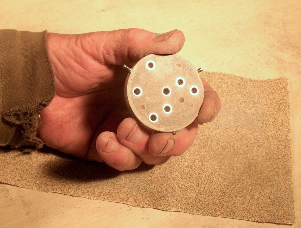

The tail light should the on when the lights are on. Bright or dim should make no difference. Most likely a couple of the brass contacts in the switch are failing to contact. This is really more of a mechanical than an electrical problem. There are two types of switches. If the backing plate is held in by pins, you just twist it to remove it. If it's held by tabs, you have to bend them up to remove it. While you have it out, anneal the tabs (turn them orange and let them cool) so they won't break off when you bend them back down. If the backing late is warped, as many are, rub it on coarse sandpaper to flatten the face. Pry the brass contacts up a little bit so they'll be tight against the terminals. If flattening the face of the backing plate makes any if the dimples shallow, you can deepen them a little with a drill bit. Just don't overdo it. They don 't have to be very deep.
