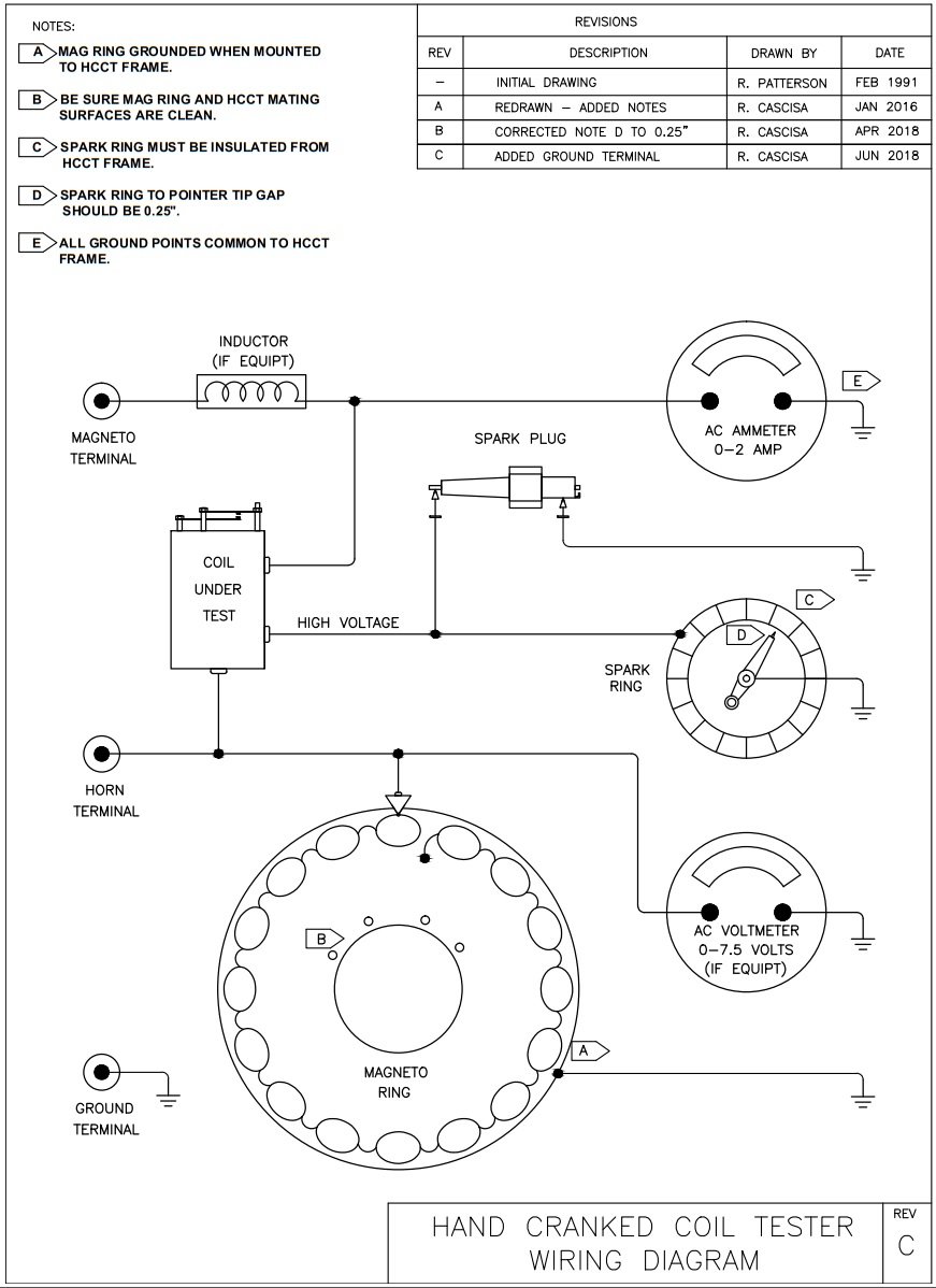

Does anyone have a diagram of the Allen Coil Tester? I have one I'd like to restore but I'm not sure how some of it comes apart. I'm hoping all it needs is the magnets charged, but I won't be that lucky !

Here is a generic wiring diagram.

Mechanically it is pretty straight forward to take apart. I have an allen electric, what do you need to know.

If the Allen tester in question has a brake drum spark indicator, then assembly is straight forward as Humblej said.
If it has the rotating spark indicator, then contact Ron Patterson for details about those.
