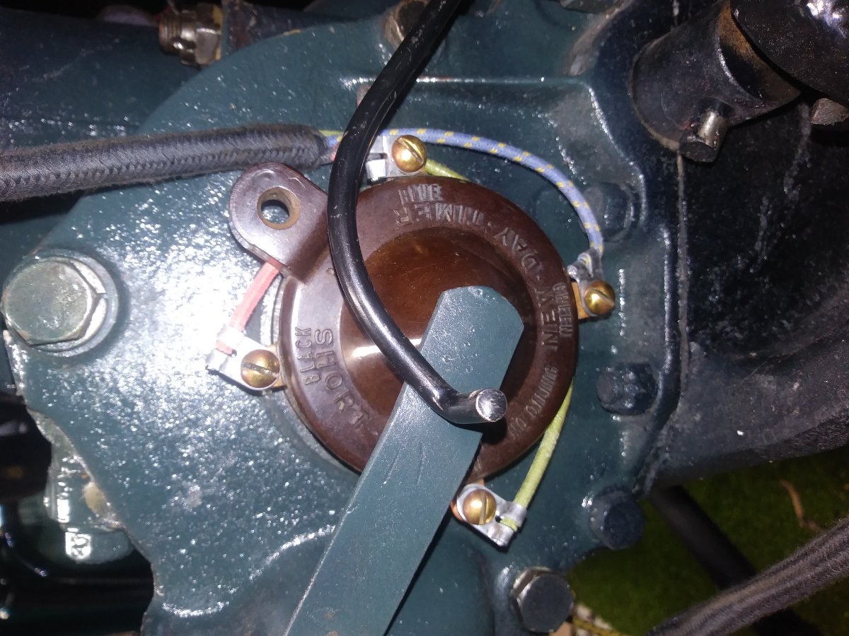

I just installed a nice old stock New Day on my 27 Roadster. I wired it according to the instructions that came with the wiring harness but the color code is totally off from what's marked on the New Day. I believe I have the piston travel correct by watching through the spark plug hole and using a straw but as I turn the timer the coil starts buzzing long before I get to full retard. And the wrong coil is buzzing. Am I getting something dead wrong or should I color match the wires per the New Day marked code ?

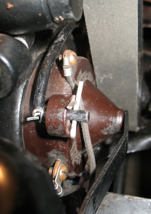

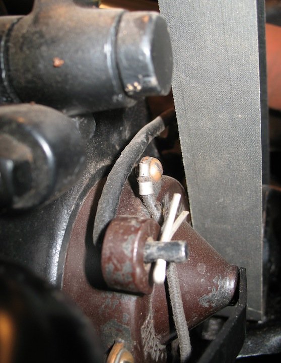

That yellow tracer makes me suspicious of the harness. Sometimes the new ones are made incorrectly.
Connect your timer like this, even if the colors on your harness disagree. Black on the timer terminal goes to #1 on the coil box, red terminal to #2, etc.
Set timing like this: http://dauntlessgeezer.com/DG97.html
Be sure the timer control rod doesn't touch the top terminal.
I added an extra cotter pin to keep the rod away from that terminal screw.

Only problem I see in the picture by Steve, is the cotter pin. I would face it in the opposite direction so it won't come in contact with the fan belt when you advance the spark as far as the rod will allow. I would also put the wire above the rod as in the picture by Gregory. If you bend the tab just right, you won't contact the timer rod.

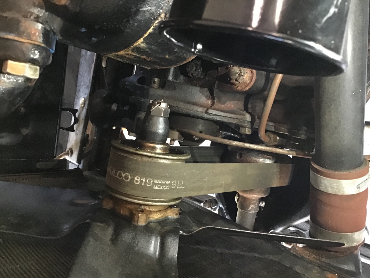

Does the rod normally get that close to the belt, or is it too advanced?
- Posts: 4685
Re: Timing with a New Day
Here’s a pic of the timer rod belt clearance on my 21 T Touring with the New Day timer. On my car it was a little tricky getting the timer rod to clear under the lower radiator outlet but it worked out with a little tweaking.
