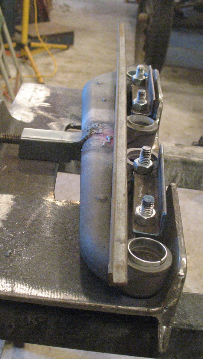

How much is it warped? If it's ¹⁄₈" or less it can probably be fixed. If it's ¼" or less, maybe. More than ¼", it's likely to crack.
How to check.
