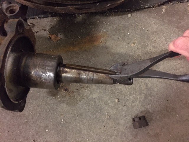

jab35
- Posts: 1037
- Last Name: Bartsch
- Location: Dryden, NY 13053
Re: Any ideas about removing a stubborn wheel key?
Justin nailed the removal, it requires a substantial side cutter as shown. Regarding fit of new keys, keyways, axle gears and hubs, I recently fit a set of used Ford gears to new Snyder's axles using new keys received with axle order. Keys were snug in axles as they should be, gears pressed on with approximately1500 lbs force, and new axles/axle hub keys also fit tight and the wheel hub axle/key/taper fit was perfect as it should be. The vender-supplied new keys absolutely fit the new axles! Now, if only the correct new manufactured ring gear and pinion would come back on the market,,,,, jb
