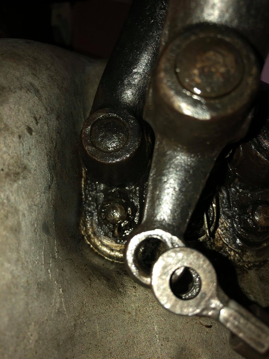

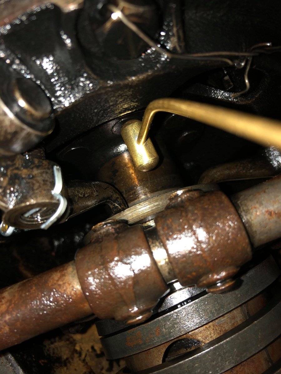

I have recently changed my bands and am trying to get everything dialed in, and I am experiencing a problem where the low pedal goes overcenter only when the clutch lever is all the way forward (i.e. in high gear position). The pedal was fine when the lever was in neutral/first upright position. I attempted to adjust the clutch according to the diagram (pull the pedal all the way back, remove clevis, etc.) but the bolt the yoke attaches to isn't long enough to get the 1/16" play that is described. The yoke ends up about 1/4" or so from the pedal slot when yoke is adjusted all the way to the end. At the same time, I noticed that the clutch fingers are adjusted very tightly. The gap between the drive plate is closer to 1 1/8" from the suggested 13/16". Could these problems be related or are they a symptom of something worse?
The clutch fingers were adjusted this way before the band change.
Attached are pictures. These gaps occur when the clutch lever is all the way forward. The yoke is on the last 3 threads of the bolt and is unstable if adjusted any further.

Set the handbrake lever all the way forwards and set clutch right using the caliber you have there. Than pull the handbrake lever backwards till the set bolt is just on top of the speed lever(3432). The clutch finger should be just clearing the clutch spring assembly(3344). If not adjust the set bolt.
Push the clutch pedal forwards till you feel it is touching the clutch pedal support (3442). Now you just need to adjust the slow speed connection till it fits .

I got the fingers adjusted to the proper clearance, and the compression/uncompression distance of the spring is much greater now. The clevis fits now when I follow the adjustment diagram, but now there's an issue where the clutch pedal is actuating between low and high gear even when the clutch lever is in middle position. The clutch pedal is very difficult to press as well. Adjusting the set bolt on the lever fixes this issue to an extent, but it has to be adjusted so much that it gets stuck when the lever goes from forward to back (meaning that is configuration isn't usable). Anybody have a suggestion?

Enlisting the help of Tony, we were able to discover the likely problem my 15 touring was having with the clutch adjustment issues. There was nothing wrong with the spring, clutch, or clutch fingers. The reason that the adjustment was so difficult to get was that the clutch pedal itself is actually extremely loose on the clutch pedal shaft. The pedal has 10-20 degrees of rotational play in it before the pedal even begins to actuate anything; this is likely because the rivet holding the pedal onto the shaft has worn down overtime. This was causing overcenter problems and proper adjustment problems. The proper fix would be to take the hogshead off and replace the shaft, but a quick couple of welds on the end of the pedal will have to do to keep it in place for now.
Interesting problem, Tony didn't remember seeing something like it before. Hopefully this helps somebody in the future. Thanks Tony!
