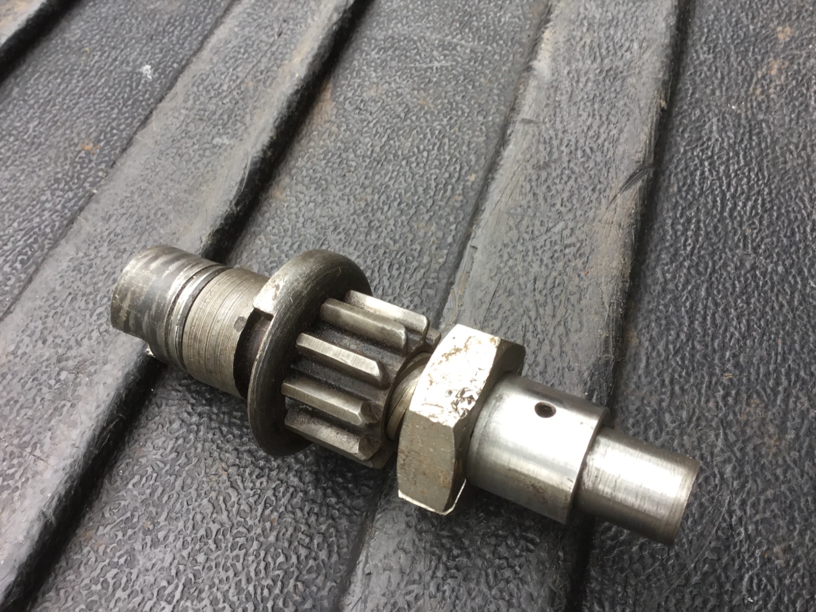

[attachment=1]image.jpg I’m trying to take a starter drive apart. Dose the bearing press off?

No not pressed on, it is threaded on then staked on from the inside into the two small holes.
