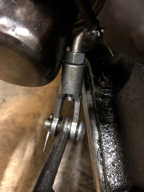

I put a new Clevis in after changing the bands, pivots, supports, and slow speed notch on the transmission. I've read a few guides on how to adjust the Clevis which is '1/16th short or play'. Problem: my new Clevis which is the same dimension as the old one isn't short enough by just a little bit. Most comment that the Clevis isn't long enough. See picture of new Clevis in position. Practically no threads left on the nut to thread upward so I cannot achieve the '1/16th short or play' that's why I think I have to pull back the pedal with my foot to get high speed gear. Solutions?

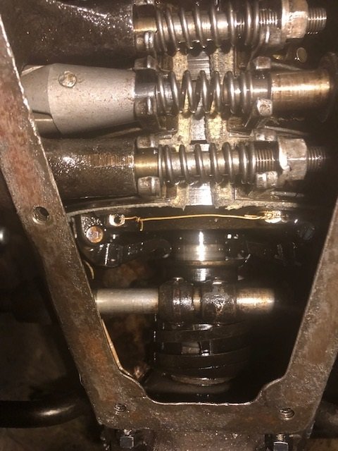

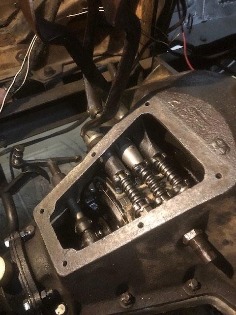

Take a good picture of the driver's side with linkage hooked up and pedals "in position".
Take a good clear picture of the notch mating with the support, through the top door on the hog's head so as to get good confirmation from the peanut gallery as to where things went wrong.
don't yank that thing yet...document everything first and post to forum
I am beginning to feel your pain! You've earned some success at this point, haven't you?

Ignacio: Before you take things apart again try this, remove the thick lock nut that came with the new clevis and replace it with a thin jam nut, that should give you enough threads to be able to shorten the clevis to get the 1/16" free play. It might be just the angle of your picture but the new clevis sure looks close to the starter bendix cover can. Make sure that the clevis does not touch the bendix cover can through all low pedal motion. When the starter cars came out the low pedal at the clevis mount point got a new offset to clear the bendix cover can. If your car some how got a 1918 type low pedal you may need to do some adjusting to the pedal clevis mount point so the clevis clears the bendix cover can.

In your last photo, where the clevis is not attached to the transmission arm, it looks like the arm is quite rotated, as though the throw-out is going very far forward (and the bolt/nut that contacts the parking brake arm is screwed all the way out?). I'm wondering if you have too few clutch disks installed? An aftermarket clutch that should have taken a few FORD disks? Or an early transmission (brake drum) that should have a spacer installed first before disks?
thick nut or not, it still doesn't look right

Your nut looks way too thick. Try it first without the nut and see if you can get the proper adjustment. Look at the old clevis. Does it have a nut and if so is it thinner? If so, you could try the thinner nut. If you cannot find a thinner nut, try grinding that one down. You could try putting that nut on a bolt and then clamping it in a vise and cutting it with a hacksaw or dremmel tool to about half the thickness. Put the uncut edge against the clevis.
