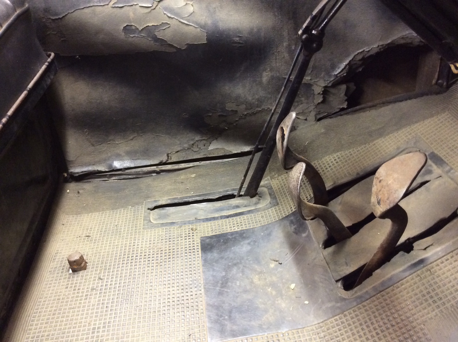

I have been sorting out my 24 and the main problem is the transmission. The low pedal is worn out too bad to adjust. Someone put a spring from frame to pedal To pull it back and I think the notch and support are worn out.
High works using the hand lever,low works with pedal,reverse and brake work. The free neutral drags. The engine slows but does not stop in neutral. With one wheel jacked up, I can turn the wheel by hand in neutral.I can push it around the shop.
My question is,if I have to take the transmission cover off to fix the pedal problems,would I be better off to also pull the engine and check the clutch at the same time. This is my second T and my other one seemed to have less drag in neutral.
Any ideas would be welcome.

If you have a copy of the Service Manual, go through the steps of adjusting your clutch section, the linkage & finally the bands - this should remedy most of the issues you are experiencing.
- Posts: 5508
Re: Need help with transmission repair
It also appears that your pedals could be bent from what would be the stock configuration - reverse should stand proud to the rear and the brake seems to be well forward of where it should be.

I have the service manual. The picture may be misleading. The brake and reverse pedal are in the correct place. The clutch pedal is pulled back as there is no stop for it to catch on.
I think the the notch must be worn. I will have to take it apart to see. It is hard to adjust it because the entire pedal and link are worn out.
My main concern is if I should remove and check the clutch discs as there is quite a bit of drag when it is in neutral with the hand lever. Do worn discs make the neutral drag?

With the parking brake in neutral position on a level surface, Turn the hand crank. The car should not move when cranking. Then push the car in neutral. The engine should not turn when in neutral. (note, it might creep when the engine is cold, but at running temperature, should not creep).
Take off the inspection plate from the transmission being careful not to drop anything in. The key should be out and anything else which could drop in should be away from the transmission. Inspect the bands. The ears should be pushed apart by the spring when in neutral or high gear. Also rotate the engine and inspect the drums all the way around. They should not have visible cracks. Now push one pedal at a time. The band should start to compress within one inch of forward movement and compress the band until one inch above the floorboard. The band should be completely tight around the drum when one inch above the floor.
An indication of excessive wear in the cam or notch would be that the pedal moves freely until it is close to the floor and then begins to compress the band. When you have this much wear, you will have to tighten the band so much that it will drag when in neutral and completely compress the band when the pedal is below the floorboard.
If all those conditions are correct you will not need to replace the notch or cam, but work on the adjustment of the link between the low pedal and clutch arm. See attachment.
