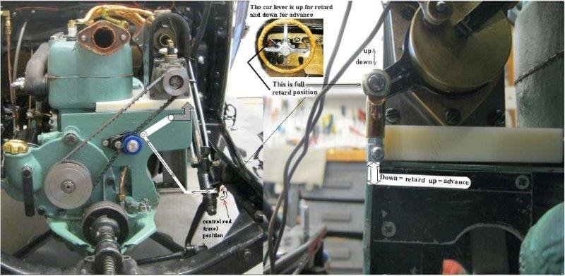

Around 1910 Bosch built gear and chain drive attachments. Their desire was to add efficiency and reliability for Ford owners. They fitted High Tension Magneto DU4 to the Ford engine. I wanted to do the same to my 1926 Tudor but I had a restriction with keeping my generator on the gear setup side. Therefore, I chose the chain/belt drive system.
My plan was to have the camshaft setup with two pulleys, one on the camshaft and the other on the magneto (with neoprene timing belt between each). I know the pulley system is not authentic or correct for the 1910 chain setup. It’s more modern than most Model T people would like, but it makes a lot of sense to improve the performance of the car. The timing belt has a lots benefits for example very little wear; no noise; no oiling/lubrication to the chain; no chain whipping; the neoprene belt body protection against grime, grease, oil and moisture; and gives a positive slip proof engagement. The Pulley/Belt System has a “PowerGrip-Timing” pulley made of fiberglass; high strength belt; high HP capability; and nylon tooth for long belt life.
The Bosch Magneto has lots of numerous benefits alone, example hotter spark; more power; better gas mileage; a lower throttling of the motor; eliminates complicated wiring (only five wires required, 4 spark plugs, and a kill switch or ground wire); and eliminates frequent filing and adjustment points.
It took me almost two years to design and build belt drive system. I had a lots of help from friends and Model T Members of the Forum. I would like to thank the following people below:

The engine runs great! I still have some remaining work such as the building a control rod for retard/advance; painting; and general cleanup.

Building A Bosch DU4 Magneto Pulley Belt Setup.
Your viewing of “Who D.A.T. Ignition System” article is amazing. So, I thought of continuing articles by showing the details of building the pulley belt setup; (researches, documents, photos, videos, costs, contacts) from the beginning of the project to the end with the running of the engine. If you chose to build the pulley belt setup maybe I can save you time, and money. The question I can answer today. Yes, I can build this setup faster, cheaper, and with less mistakes. Cost was important and it forced to me do a lot more of the work machining, but I was committed to compete the task because of my investment at each stage of the project.
Let’s start off with discussing the elephant in the room. The cost of the items:
1) Bought Bosch DU4 magneto on EBAY $155.00.
2) Rebuilt Bosch DU4 magneto (Counter Clockwise) for $563.68
3) Purchased 10mm chain wheel Tensioner $11.99
4) Purchased SS base tensioner $26.00
5) Purchased 14 tooth gear pulley sprocket $34.14
6) Purchased 28 tooth gear pulley sprocket $71.48
7) Purchased timing belt $23.40
8) Purchased stainless round tube for camshaft $15.60
9) Purchased natural nylon cast sheet shimming bracket $52.86
10) Purchased 7’ foot spark plug wire and brass connector $18.00
11) Purchased Brass TINTON LIFE Universal Bathroom adj. shower head wall mount holder base org spark plug $16.97
12) Optional purchase pencil tension tester $23.22
13) General bolts, nuts, drills, skill saw blades (guess) $30.00
14) Salvage yard purchase street aluminum light fixture $50.00
After, spending better than $1,092 dollar I still didn’t have a turn-key working setup. Each task requires doing my homework. One of the main problems I experienced was that no one had built a setup on a Model T Ford using a pulley sprocket belt system. So, the only guide/design was using the 1910 Bosch chain drive setup.
The tools needed to proceed are a socket set (std/metric), sander wheel, files, band saw, saw all, jig saw, drills, drill press, taps, drill motor, air tool cutting fiber wheel. Tools I didn’t have: metal lay, and welder,
Please feel free at any time to ask questions of any kind? Some may not want to continue with following this article because we will sometimes be getting into the weeds and it might be more than you want in the discovery process. I WILL TRY TO KEEP MY DISCUSSION AS BRIEF AS POOSSIBLE TO NOT LOSE YOUR INTEREST. Let me assure you that I’m a layman, who only wants to learn more about my Model T Ford. I’m learning from you as much as I can.
One of my goals was to keep the setup looking simple, and neat.
The ace I had was mentor Steve Tomaso (RajoRacer) who restores Model T professionally and loves the hobby. He loaned me a camshaft core while I was working on this project. Also answered a lots of my questions as needed.
The topics being covered are:
1) Research all aspects of Project. Note: in all cases I tried getting lots information with more than one person as source, books, documentation from the Model T Forum about the subject Bosch Magneto.
2) Purchase of Bosch DU4 Magneto repair and setup documentation.
3) The do/don’t using/and the servicing a magneto.
4) The camshaft research size outside dia., length shaft, location of the camshaft pin, length of threads.
5) Building of the bracket based on my research and using Bosch chain drive setup as a guide.
6) Research and modification of the pulleys, belt, and tensioner using the original chain drive setup.
7) Machining and welding the pulley sprocket and drilling the pin location hole camshaft.
8) Purchase of wiring for engine and building wire collector keeping it engine looking neat.
9) Final looking at design of the retard and advance of Bosch Magneto.

The Bosch Magneto stage 7, 8, & 9.
Purchase of wiring for the engine and building a wire collector keeping it engine looking neat.
Final looking at design of the retard and advance of the Bosch Magneto.
I produced a new video describing the pulley sprockets research, modification, and build below:
File name= 1080p Model T Ford W pulley research, modification, & build
Address = https://youtu.be/RYVSKIsrv1c
I purchased the wires and clips from Lang’s Old Car Parts (bulk wire yellow with black tracer sold by the foot (7’ of wire)). Also, purchased brass terminal ends for the spark plug wires (quantity 2 per spark plug). Notice: I set the wire up in a collector which matches the timing order of the car 1, 2, 4 & 3.
The wire clip holder was built using a brass bathroom fixture at a cost of $18 along with a drill out washer.
Final looking at the design of the retard and advance of the Bosch Magneto DU4
After reviewing the design above I built the retard/advance control rods out of scraps aluminum, shifter rod linkage cost $15.00, universal cable linkage cost $17.00, used/scrap Honda black window shock mount, and ¼” steel rods.
Above is a 360 view of the bracket and the retard/advance control rods.

The Bosch Magneto Modern Belt Drive System has many advantages over the following ignition systems 1910 Bosch Chain, Bosch Gear, X Brand Cross-Drive setups, and the Model T point and coils.
1. Positive slip proof engagement
2. Eliminates lubrication of gears, oil of points, adjustment of coil points
3. Neoprene body protection against grime, grease, and oil and moisture
4. High strength nylon teeth for long life
5. PowerGrip-timing pulley belt is made of fiberglass high strength which can easily and quickly be removed and replaced. The only situation might occur during this repair (such as changing belt) is re-timing the engine because you might be a belt tooth off from the motor correctly timed. The pulley belt is easy to install and resetting the timing if necessary, for operation of the motor.
6. If a problem occurs with the PowerGrip-timing pulley belt, keep an extra replacement belt if needed during the operation of the car
7. Corrosion resistance
8. Excellent abrasion resistance
9. Clean operation
10. Neoprene teeth high strength
11. Long trouble-free service
12. The Bosch DU4 magneto has two spots which must be oil monthly with a tip of a toothpick
13. Keep an extra set of counter-clockwise points for the Bosch DU4 magneto if necessary, for the operation of the motor

The question of the PowerGrip timing can be answered in two difference ways.
I would recommend you look at the two movies I created on YouTube.
In this video I would study/look at the setup, speed of motor, pulley belt, tensioner, camshaft, magneto, and final the gearing of ignition setup.
File name= 1080p Model T Ford W pulley belt
Address = https://youtu.be/Cg-1Kqr7dts
This second video looks at the belt, gearing of the camshaft, magneto, and the tensioner.
My First answer:
The Bosch DU4 Magneto can be turned over with little pressure using two fingers, and the most Model T motors are 22 horsepower running around 1800 RPM. My point is there’s little pressure on the gearing of the pulley belt setup. It is a smooth operation as seen in the first video. Even when you add a more speed or RPM is still a smooths operation. This belt pressure is not driving a turbo or a blower at high rates of speed so the wear of the is belt will be extremely low in the process of running the motor. If you add more horsepower with the two magnetos, dual spark plugs with a high tension spark, OHV/flathead, hot cam, and special piston to a Model T, it still will not rise to a setup of a modern horsepower engine with turbo or blower.
On second video you will see the belt and the gearing of the ignition setup and see how belt and gearing are made to fixed/mate with the pulley belt.
The tensioner can be setup in a different configuration to take-up the slack of the belt plus adds pressure force rate to the belt tension which keep, the belt in place with no whipping, slipping, stretching, or breaking of the belt.
I would not use an idler.
My Second answer:
The Book “Who D.A.T. Ignition System” goes in detail describing the gearing of the magneto, camshaft, belt makeup, difference configuration of the tensioner, tensioner setup, and force rate of the tensioner
Pages 13, 25, 26, and 32 PowerGrip-timing belt makeup, belt tooth, and gearing of the belt.
Pages 28, and 33 different tensioner configurations and layout.
Pages 25, 28, and 33 tension force rates, plus pencil tension tester.
Pages 30, 31, 43, 44, 46, 47, and 48 park description, camshaft sprocket, and magneto gearing.
The book is available on Amazon.

For those who have purchased my book, on Amazon, I have built a pulley belt setup with the 1910 Bosch Bracket.
See the photo. Also, you can contact me for additional photos.

It would be interesting to see how this fits with the fan and fan belt in place.

Re: Who D.A.T. Ignition System
Norman
Pics above in the thread show the finished product with all belts in place. It was using his homemade shelf, but belt placement is about the same
Danny
Your correct, the 1910 Bosch Bracket setup has the pulley belts alignment in the same location. See the photo.
Art
