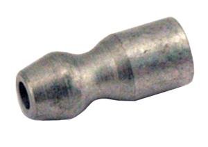

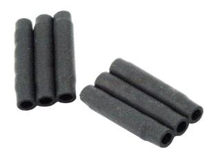

Here are pictures of the parts #'s described above. These should be available at local automotive supply, hardware or home improvement stores. However , color may be an issue. If so use black shrink tubing
- Attachments
- A_14486.jpg (7.66 KiB) Viewed 6328 times
- A_14487.jpg (7.58 KiB) Viewed 6328 times

Yeah cool. I’ve seen those parts listed on some parts house websites. I don’t quite understand how they work. Does the metal bullet connector plug into tha back of a different one ? And they are installed inside the black covering?
Susanne
- Posts: 1119
- First Name: Susanne
- Last Name: Rohner
Re: Electrical connectors
There's a metal tube inside the black insulation that the bullets plug into on either side.
