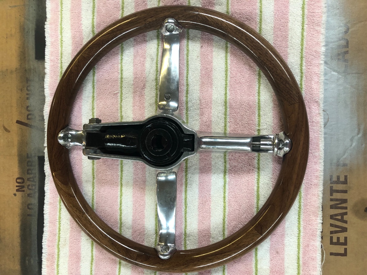

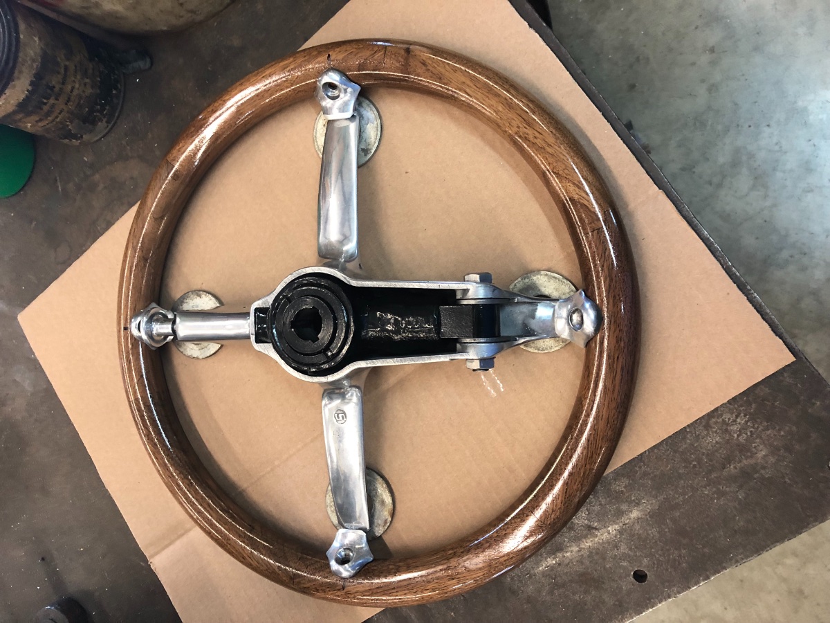

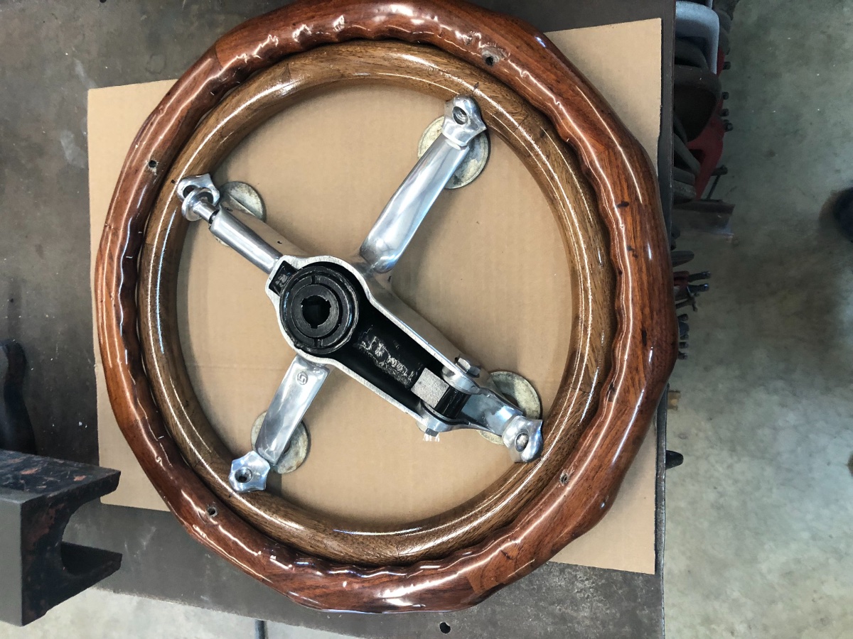

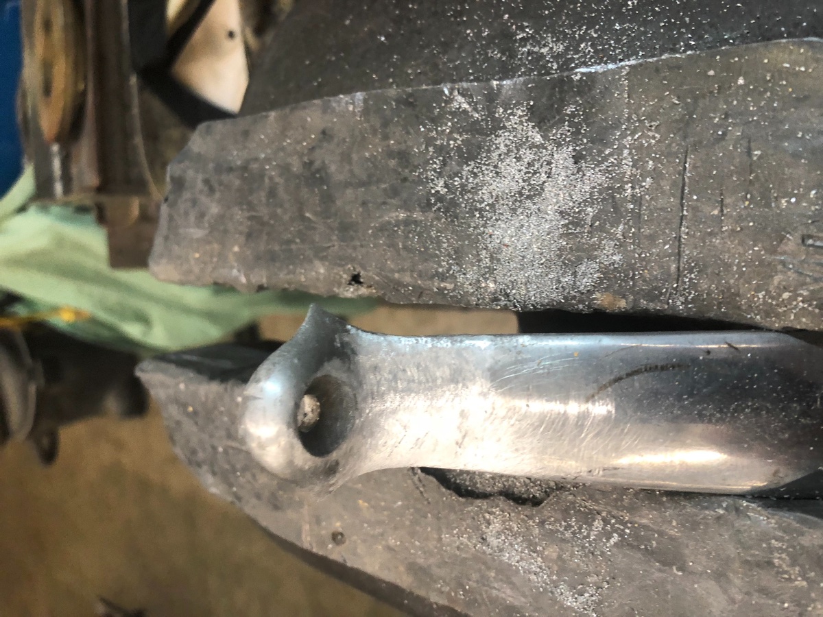

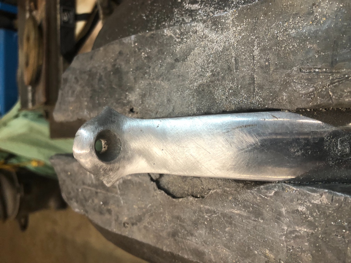

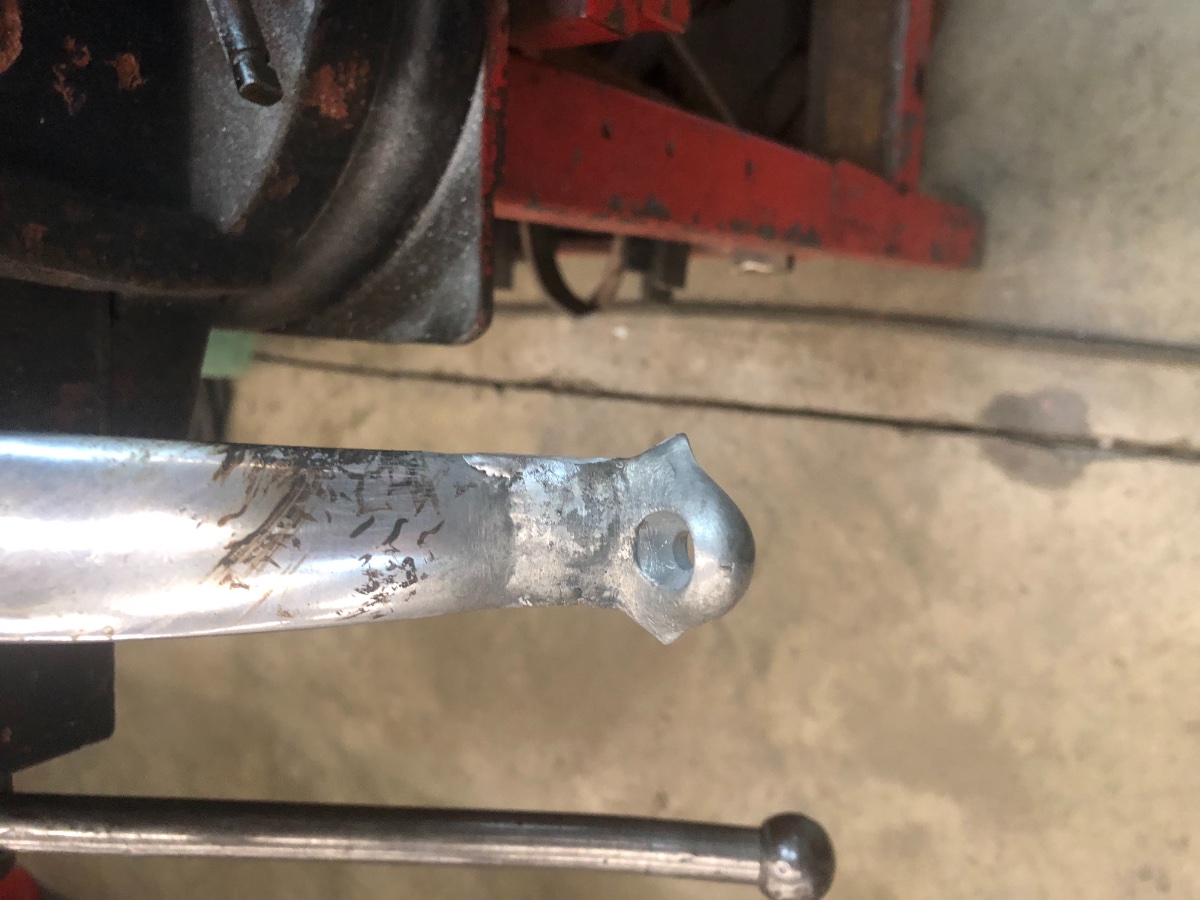

Well, a special request was undertaken to complete a special Speedster. Some will hate this and others will love it, to me it is all about personal choices with your car. A Speedster is an individual's car of options and likes. So modifying something to fit in the era is what it's all about.

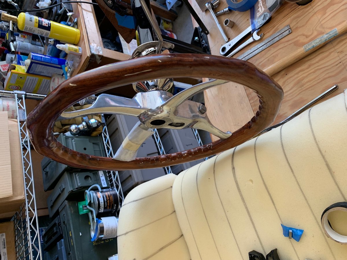

Since this car I built a lot for and know the man now well, it did not surprise me when he said, "My Spencer steering wheel will not work as I am to big". Options, replace the wheel with a smaller one or modify yours! He took the later.

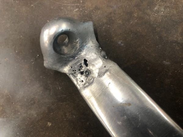

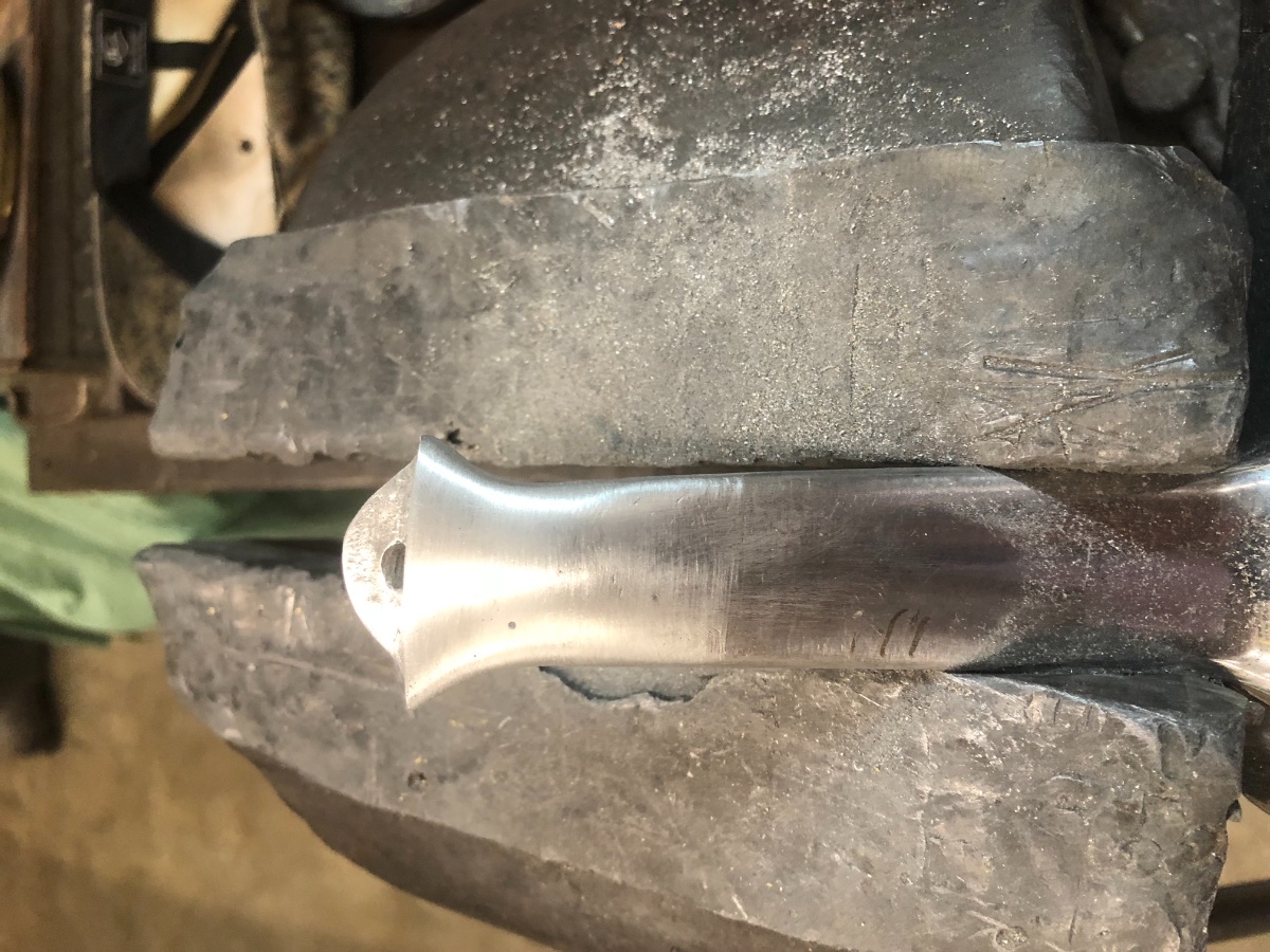

I am glad we did do the mods because the wheel had beautiful polish but was an accident waiting to happen with metal fatigue and a crappy casting on day one. Multiple passes of cleaning/grinding and re-tinting the metal as you can see was necessary. Kevin Allen's outside wood rim is just beautiful!

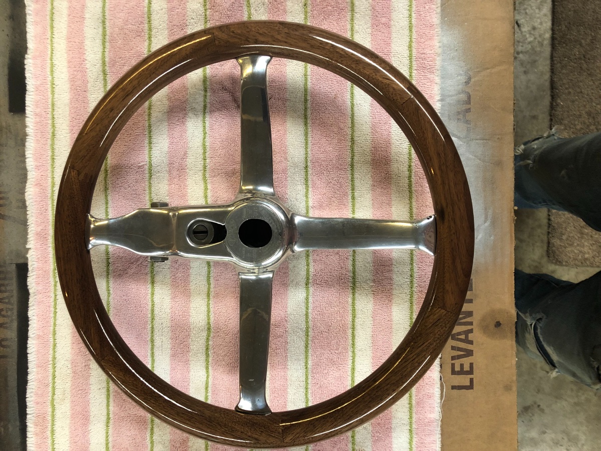

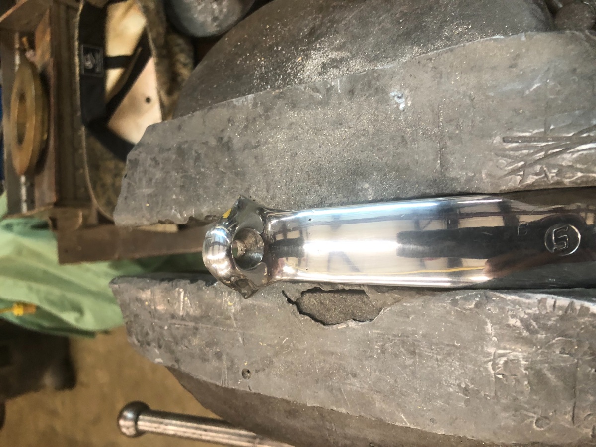

So as you can see too that integrity was gained. Hey for us. Racing your files occasionally through canning wax will keep your files from plugging up when doing soft metal. Some shaping, sanding in stages from 80, 120, 320, and 500 grit then to the polishing wheel.

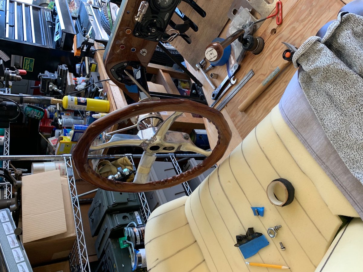

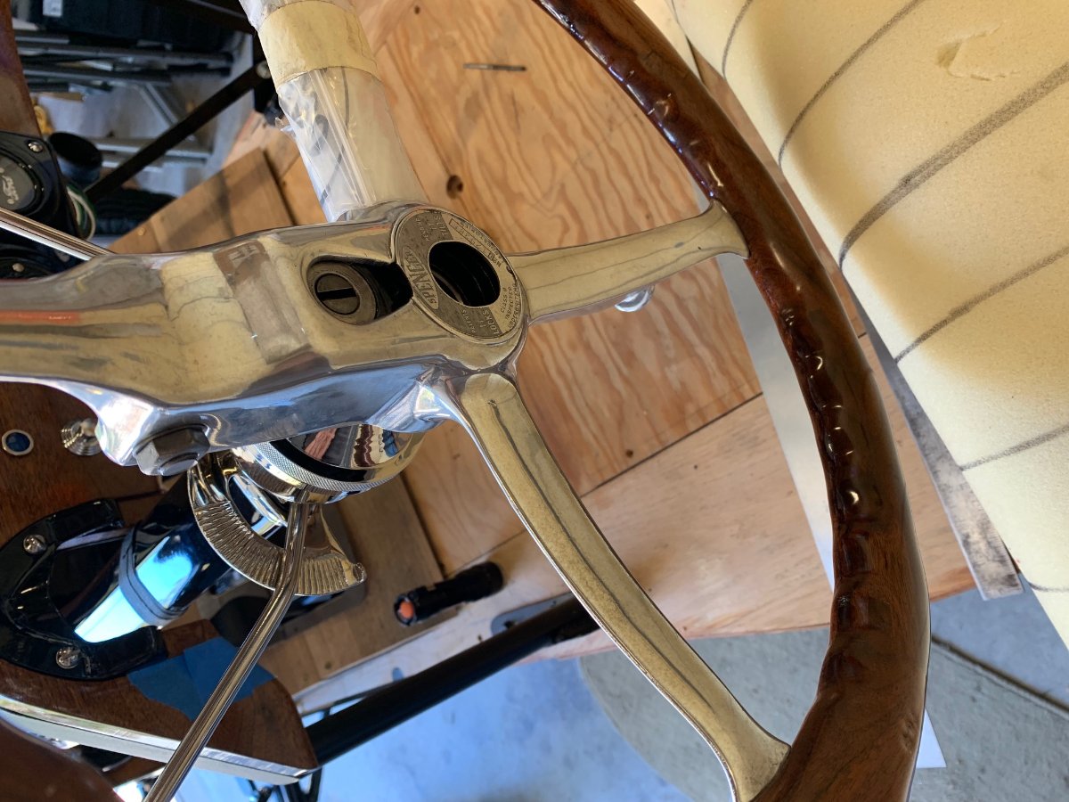

Now my oversize friend can slide in, drop down the steering wheel and look GOOD in total comfort. It is what is all about.

BTW, chalk works well on files, too.
Isn't it amazing what can lurk within a casting??? That fellow is very lucky!

Thank You All for the kind comments! Just sharing information and skills acquired over the years. Safety is first for sure.
Years back I was moving a gentleman's Neville Wheel as he was commenting how stiff it was. During a cycle of slides with no binding, no warning, breaks off completely in my hand. He just starts raising hell about how much I owe him and so forth! I looked him straight in the eye and said, " you owe me double for saving your and some else's life". But I am fixing yours for free. He shut up real quick!
Folks, please check those old beautiful aluminum castings well, they fatigue over the years from vibration, etc. Just do not want to see good people get hurt having fun!

I wish to take exception to Mr. Lee's unkind remarks relating to my girth. While I'm not petite nor am I excessively overweight. The problem is due to having to lower the steering column (via u-joints..Thank you Hank) because of the low hood and longer profile. The problem was also exacerbated by a 17" Spenser Fatman wheel which has a concave dish as opposed to a stock T wheel with a convex dish. Once installed the lower wheel rim was touching the seat cushion. Olive Oyl wouldn't fit behind it!
So.....this led to a conversation with Hank....he gave me some options and I selected to have it modified. As Hank has done a lot of work on this car, I have grown to have total trust in his artistic and mechanical abilities. I've never, ever been disappointed.

Very nice work on the wheel and thanks for the tip of the day; Racing your files occasionally through canning wax will keep your files from plugging up when doing soft metal.
I am sure that has been around for a while, but I haven't been yet.
So new one to me.
