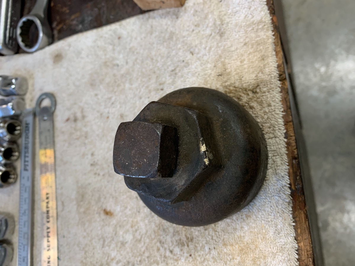

What’s the wheel puller for
Post by Tlitwin » Tue Oct 29, 2019 2:35 pm
The diameter is 2 5/8”
Thanks Tom

Re: What’s the wheel puller for
Post by Tlitwin » Tue Oct 29, 2019 2:36 pm
Forgot to add photos

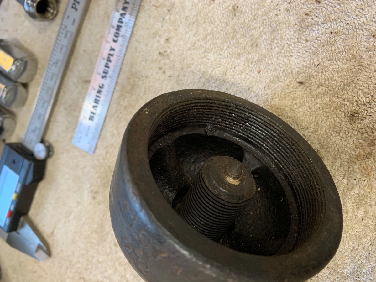

Tim, whatever it fits, it is not a good design. Fine threads like that are more easily stripped when pressure is applied, and some T wheels require a good deal of pressure. A far better puller has a pinch bolt which allows the puller to be clamped down tightly on the threads once full thread engagement is reached.

That may not be a puller but a thread chaser, in case you bugger up the threads and want to fix them. Frank

TT rear wheel.
I know the T is 2.114” or thereabouts😊

You will find that type of puller in many different sizes for many different vehicles. I think I saw about a dozen at Hershey. Unfortunately most of them don't have the clamp bolt Allan described.

If its a thread-chaser, it won't chase very far before the point contacts the shaft.
