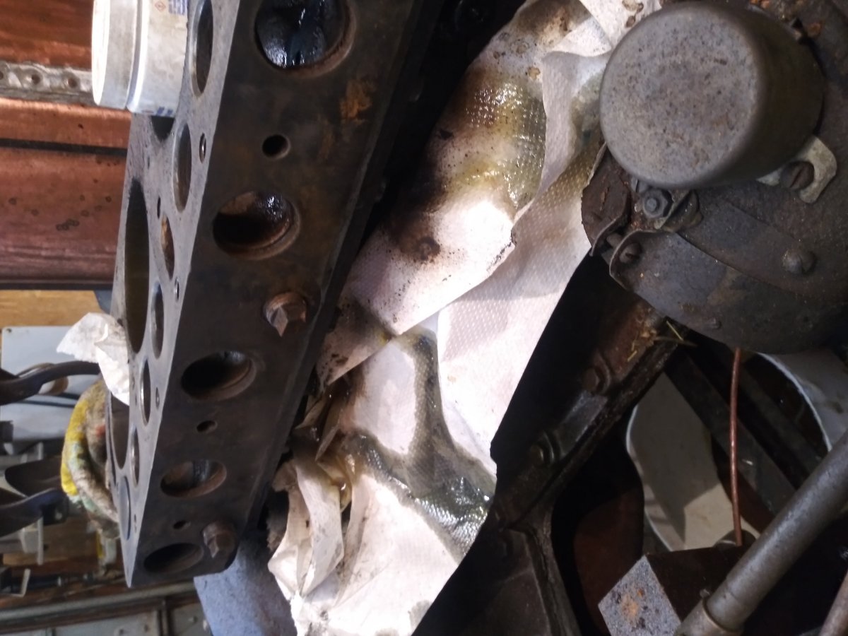

Post by BlackTinLizzie » Sun Nov 03, 2019 8:44 am
Here is a photo
Going to check casting dates now

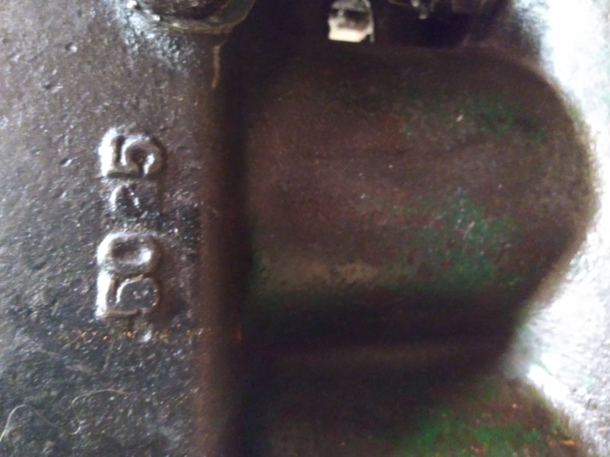

Post by BlackTinLizzie » Sun Nov 03, 2019 8:54 am
Only casting date found

Post by Dan Hatch » Sun Nov 03, 2019 9:31 am
Guys: someone just threaded it to fix leaking plugs.

Post by mtntee20 » Sun Nov 03, 2019 9:34 am
Looks like a previous owner got tired of leaking freeze plugs. He decided to tap threads into the holes and use pipe plugs instead. Guess that would be OK if you were able to ensure freeze protection for the next 100 years.

Post by Mark Gregush » Sun Nov 03, 2019 9:49 am
Have you ever seen a block that had the plugs pushed out because of freezing? The holes are there as part of the block pouring process. The Model A doesn't even have them and all the A blocks I have seen have the freeze cracks are in the same general area as the T, on the water inlet side. Remember that Ford used a screw in plug for a lot of years before going to the press in plug. If it were mine, I would replace the plugs that are now in it with Allen type recessed hole brass plugs so they don't stick out so far.

Post by Charlie B in N.J. » Mon Nov 04, 2019 8:59 am
Although Steve has a point about rusting a decent anti-freeze will have rust inhibitors in it. I only bring it up because I'm in the ain't broke don't fix it club. The holes, for whatever reason, were tapped for pipe threads so you can't go back to the factory type plug. They could be rusted or somehow locked in place and screwing with them might cause a bigger headache like torn out threads in the block. Not leaking ? Leave it be. Don't grind off the heads either. If one starts to leak and you simply have to try to remove it you won't have anything to grab.

Post by Mark Gregush » Wed Nov 06, 2019 12:33 pm
The if it isn't broke don't fix it, good idea. My only comment re the plugs, is they don't look to have been in that long going by the threads on the outside. but bottom line would be it's your call and if they are not in the way leave them.
