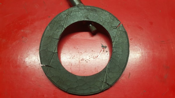

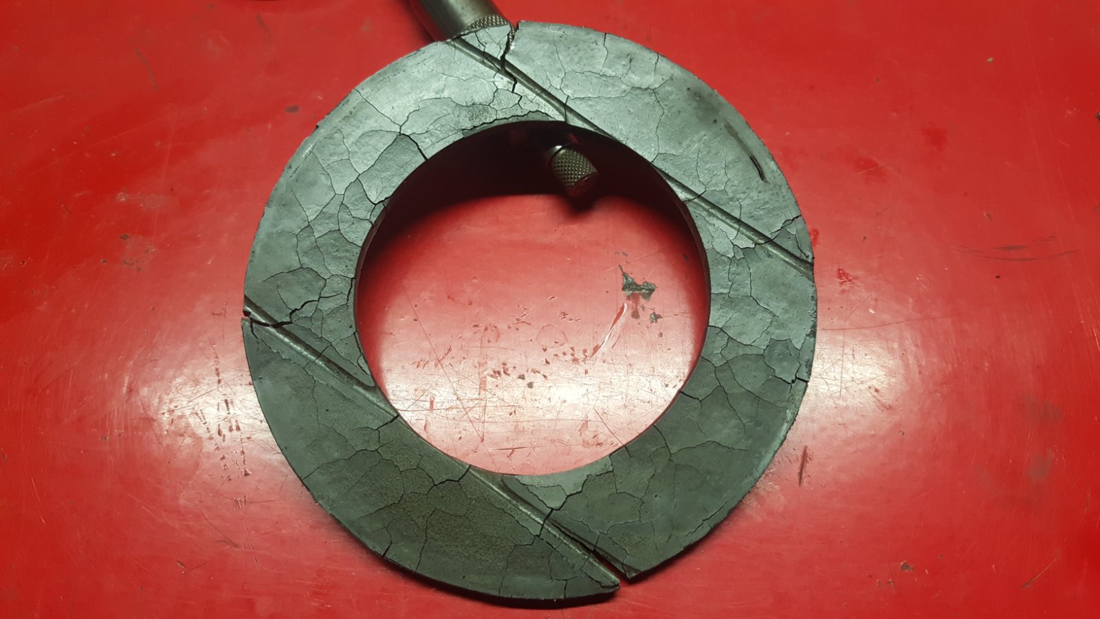

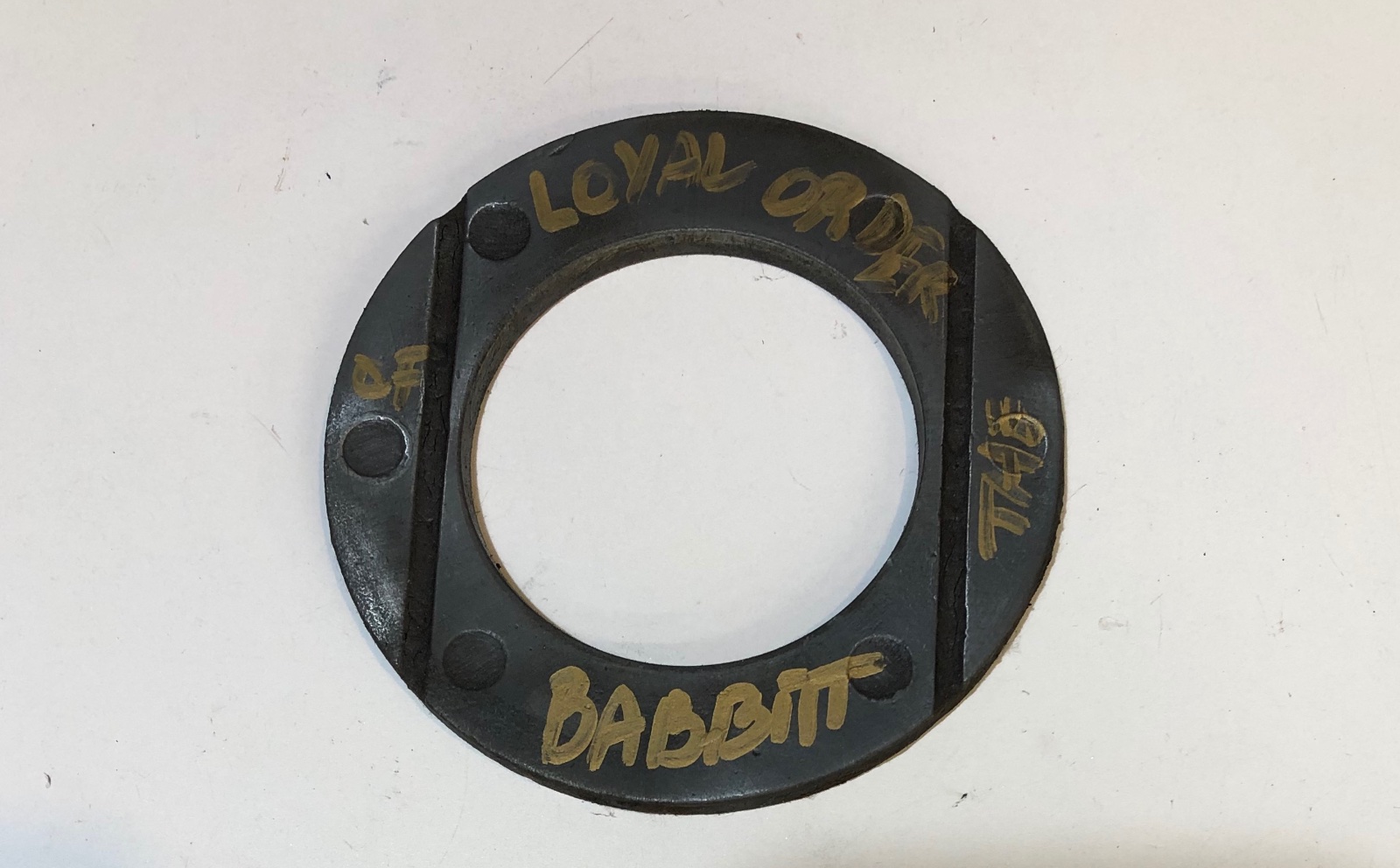

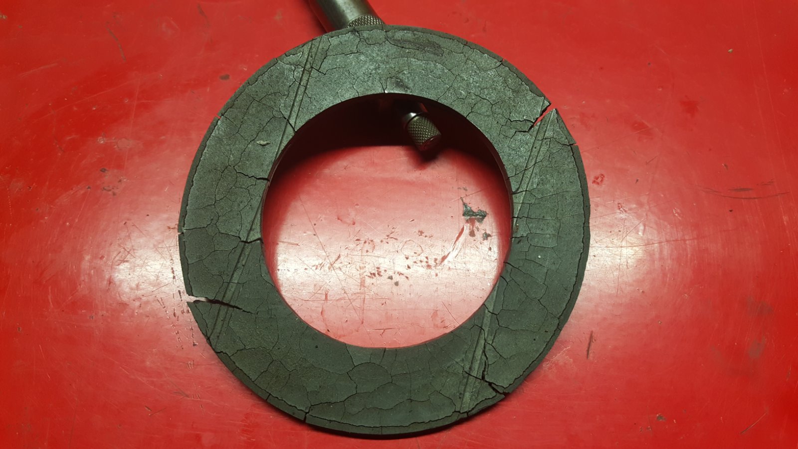

Jeff Perkins
- Posts: 237
- First Name: Jeff
- Last Name: Perkins
- Location: Lakeland MN
Re: repo babbitt bushings and axle disc
This fall I disassembled and inspected the differential in my 1913 Runabout. This thrust washer was the good one, the other was in very fine crumbs all over inside. I am now a member of the “Loyal Order of the Babbitt”. Oh, well, at least I am not yet a member of the two piece crankshaft club!
