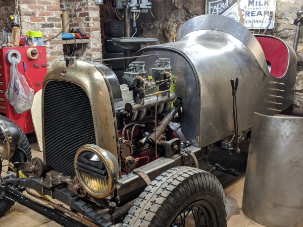

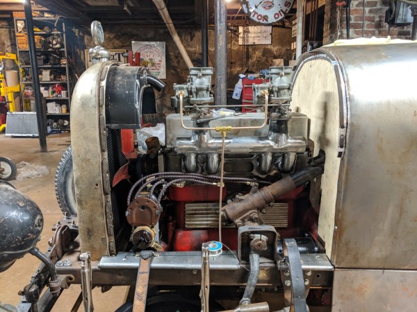

I've been working on getting all the engine components tip top. I rebuilt the carbs and finally got them so they don't leak. The accelerator pump wells were pitted so everything was binding up. I ball honed them then hit them with a brass wire brush in a drill to polish them up.
I'm also waiting on a mag to be rebuilt by Mark's Magnetos in Colchester, Connecticut. It's supposed to be done by the end of this week.
Hopefully next weekend I can post a video of it running properly. She fired up but the ~95 year old magneto gave up the ghost while trying to tune everything in.
Then it's off to the radiator shop to get new inlet and outlets installed on the whippet, as I'm just temporarily running a stock t rad to get it going.
Once this is all complete, I will do a final mock up, tear down, and finish work.

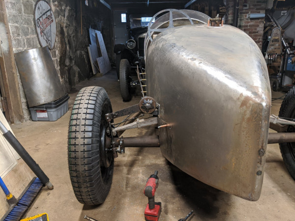

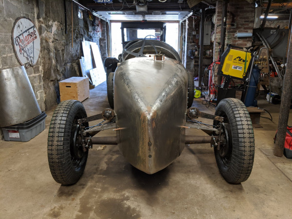

The wife's parents watched the baby for a couple of nights this week so I got to sneak in the garage. While waiting on a rebuilt magneto to come, I worked on the hood shelves and straps. The shelves are sheet metal with a 1/2" oak insert made to fit snug. I drilled holes for #10 screws, then countersunk the holes in the back to accept nuts. The nuts had a press fit into the wood so that works nicely for tightening the footman loops for the hood straps. I then made some mounting holes and bolted them up. Always grind those ugly manufacturing markings off your modern hardware
. I also found a nice radiator cap and motometer for a good price you can see in the last photo.

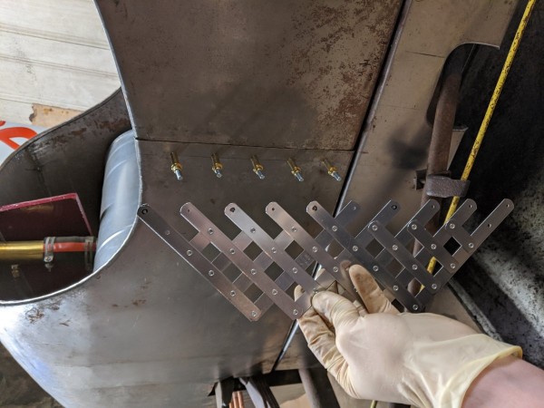

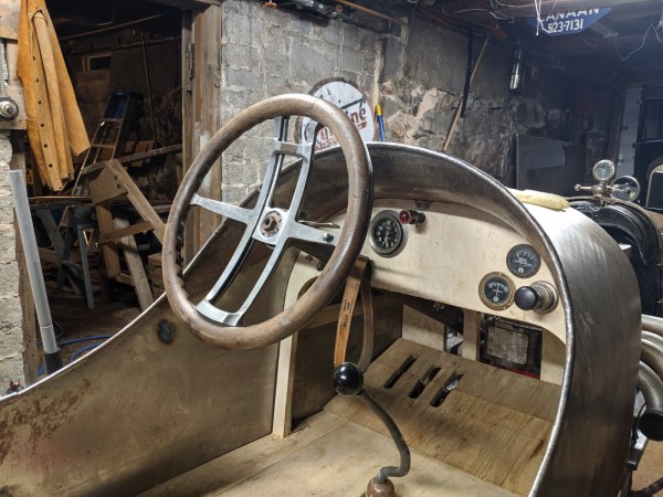

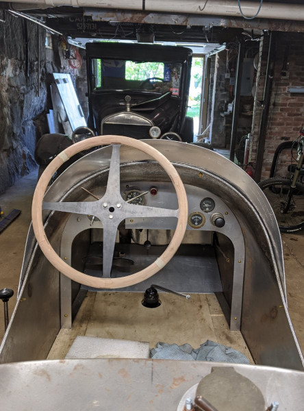

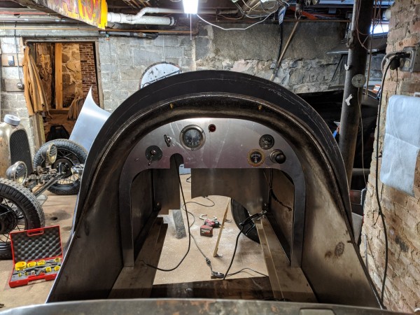

Earlier this month, I worked on mapping out my dashboard. I'm still searching for a suitable tachometer and speedometer. If anyone has a cool jones-motorola, johns-manville, Corbin, or the like gauge to sell I'd be interested! Ive been scouring for pieces which will look the part. Eventually I will make an aluminum overlay for the dash.

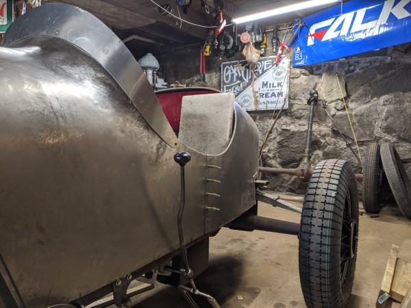

I was able to fire up the engine but spark got super weak due to a dying magneto. Therefore, I made a call to Mark's Magnetos in Connecticut. He whipped up a fresh Bosch ZR4 for me in a few weeks time and it arrived yesterday. I just finished making some new plug wires for this mag and hope to get it running tomorrow some time.

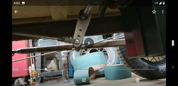

Hit a milestone yesterday around noon. I got this thing to fire up! It needs some tinkering timing and fuel wise but that can come once I do final assembly. No use dialing everything in just to take it apart and have to do it all again.
Here's a video the wife took. Disregard the tinny sound of the fan hitting the radiator outlet.

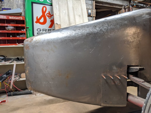

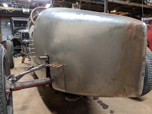

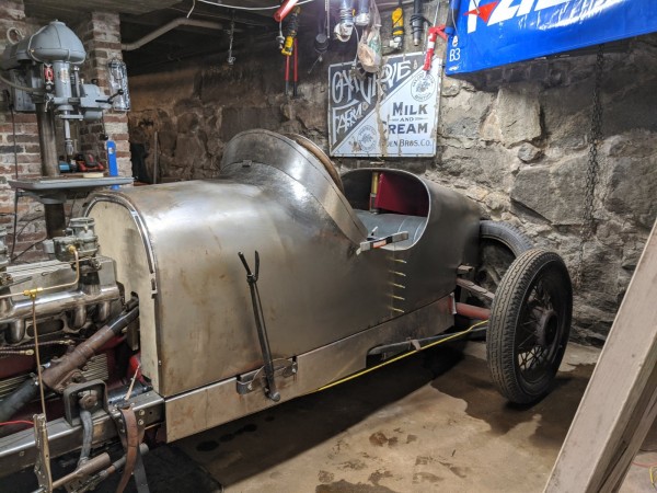

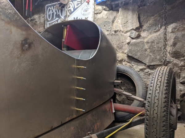

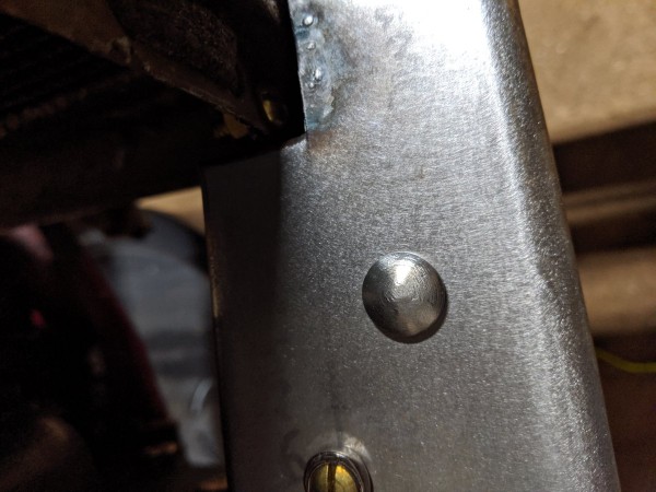

Hey y'all. Time for another update. Nothing wild but I've been beginning to drill the body for rivets. I bought a river fan which I will show. This tool is super simple yet really useful. It makes your rivets straight and even.
Once I mapped out where the body will be riveted with this tool, I used clecos to secure the body temporarily. Here's the other side.
Below is the tail finishing panel clecod on. I will be using drilled bolts and nuts, or possibly rivnut the body then drilled bolt and safety wire. Inspired by the old Bugatti type 35.

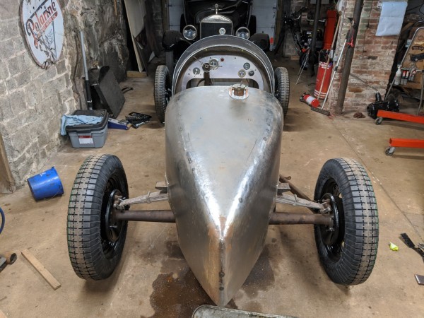

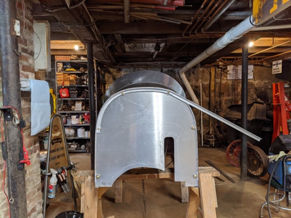

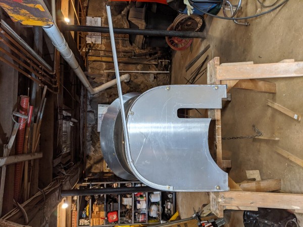

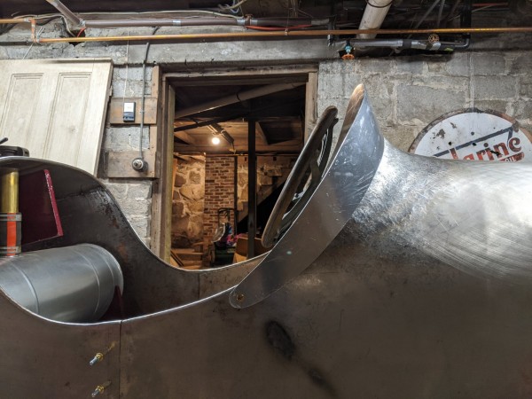

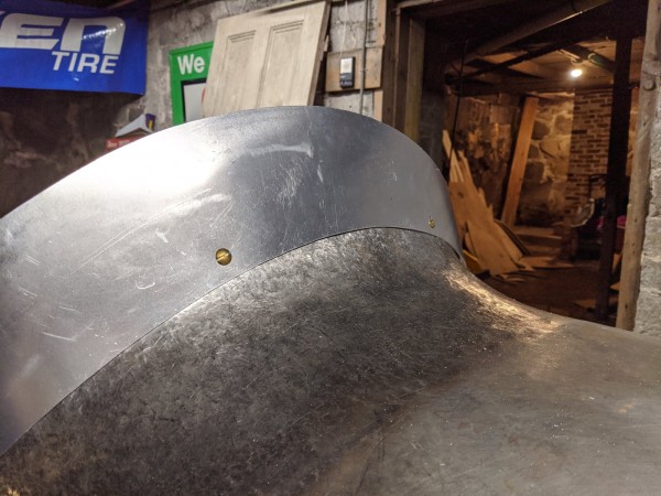

I dug into my sheet of .090 aluminum. This will be used for the firewall, dash, and other things. Here's the first endeavor.

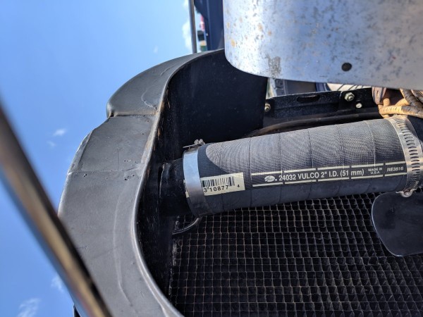

I wanted to add an aluminum air deflector inspired by some of the old Miller cars.
Beginning with some cardboard, I trimmed until I got close to the desired shape.
I then swapped to sheet steel. I wanted to see how it would act and form, without wasting aluminum.
Cut well outside my template line then trimmed to satisfaction.

Onto the aluminum. With all precautions taken not to spend more money than necessary lol.
That's it for now.
That's it for now.

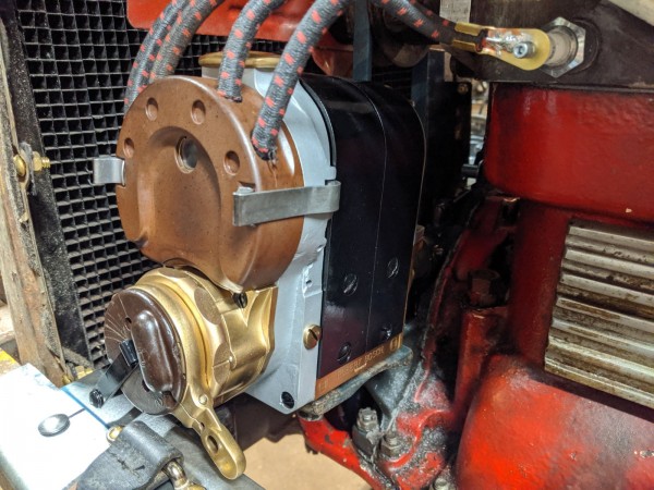

Oh and I also got this sweet oil fill extension from Tim Morsher! Thanks Tim! I appreciate all you guys who put forth the effort to have cool parts like this made

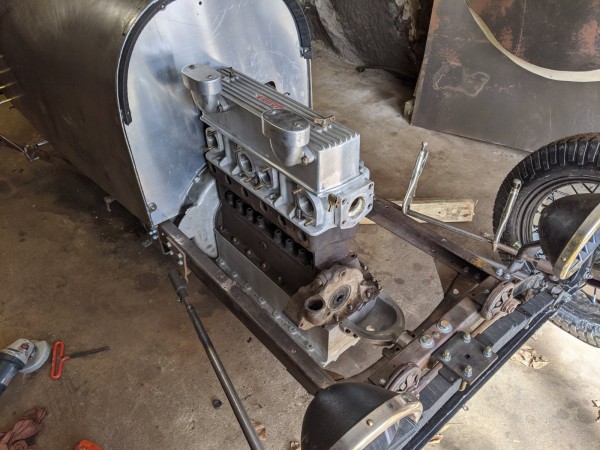

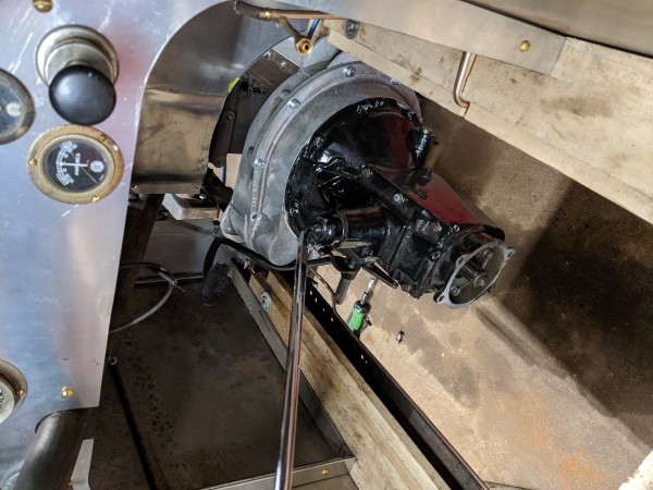

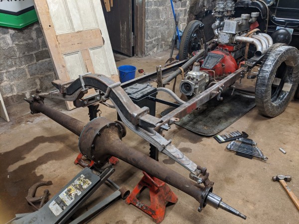

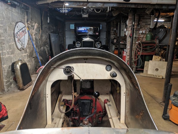

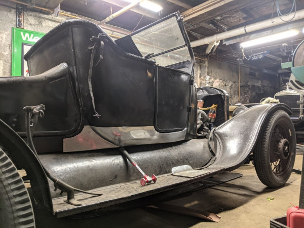

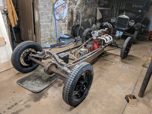

Update time!

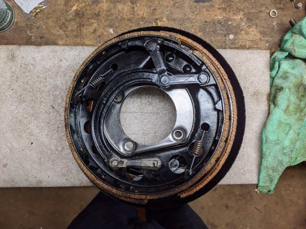

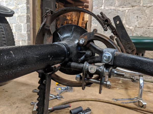

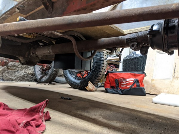

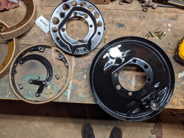

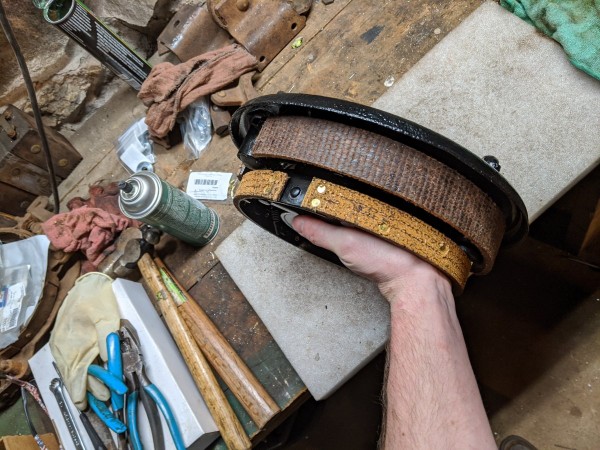

Over the past few months I fixed up a model a rear axle, fit a tapered leaf rear spring, remade the firewall and dash, and for some new tires and tubes mounted up on some 32 Ford wire wheels I blasted and refinished.
Here's the Model A rear axle sitting in the frame. Unfortunately this and future transmission plans changes up my radius rod, sideskirt, and rod mount design. But it's just another hurdle in this long battle. The spring perches are wider for the model a spring so I cut them down to T spring width and used t shackles.
Rebuilt some model a backing plates.
The double shoes of the A brakes will allow me to use 2 separate brake handles. One for parking and one for service brakes.

Re: Model T Special build.

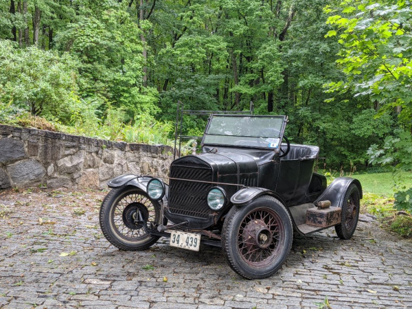

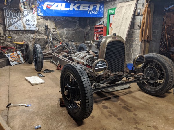

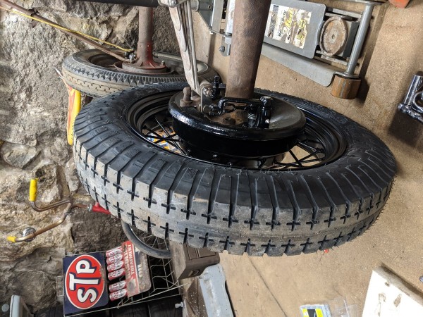

Here's the chassis with the new tires mounted up. The fronts were shorter height wise than advertised so I was a bit down about that but otherwise happy with how it's sitting.

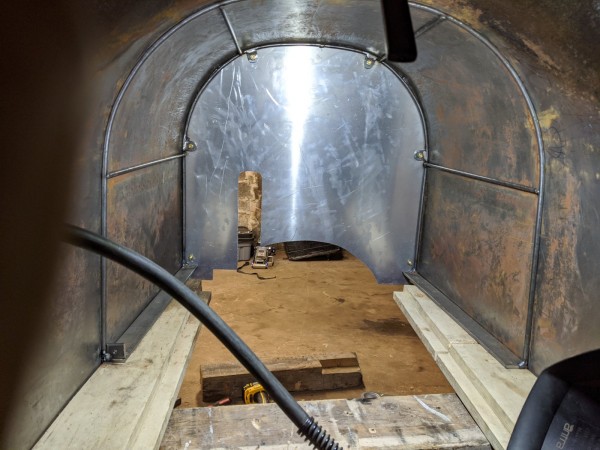

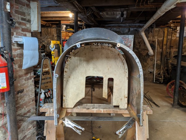

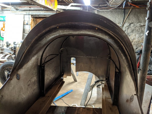

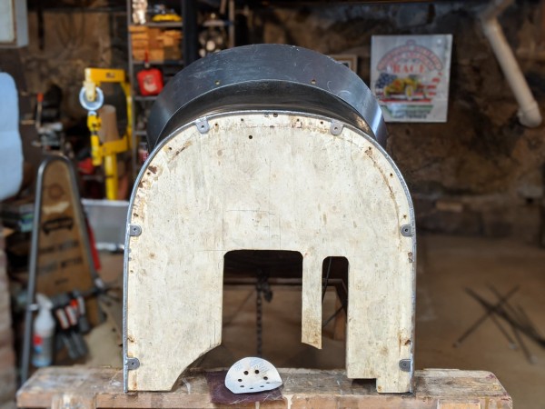

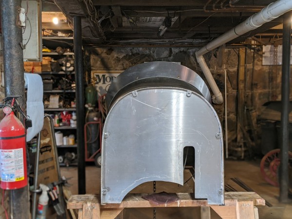

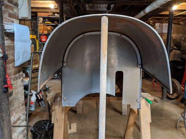

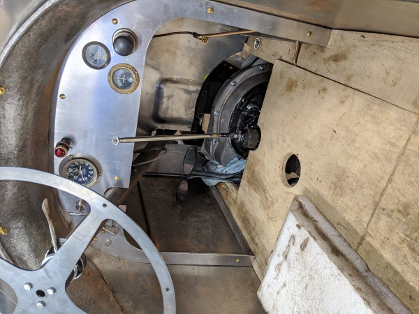

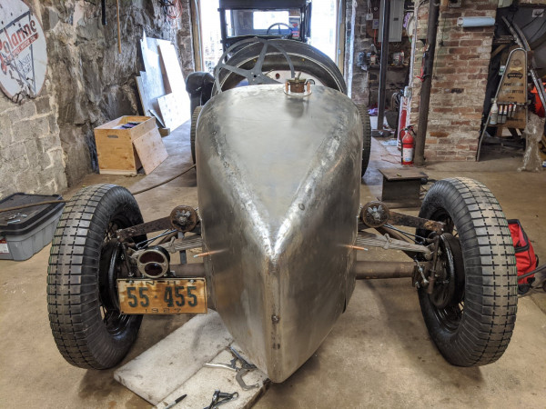

Onto the firewall redesign. I wasn't happy with the sheetmetal where it met the firewall, and also didn't like the wood of the firewall, dash, and supports. Time to undo everything again. I need to step back at the end of this and be completely satisfied with all of my decisions.
I started by disassembling the wood structure. Then formed a wire rod the shape of the firewall opening. Once done, I made and welded 6 tabs to the rod. I trimmed the sheet metal where the tabs met the body and rolled the sheet over the rod encapsulating the tabbed rod.
[attachment=2]IMG_20200111_112242.jpg[/attachment]
[attachment=1]00100lrPORTRAIT_00100_BURST20200111120432931_COVER.jpg[/attachment]
Then made the firewall out of aluminum.
[attachment=0]00100lrPORTRAIT_00100_BURST20200111130305343_COVER.jpg[/attachment]
I started by disassembling the wood structure. Then formed a wire rod the shape of the firewall opening. Once done, I made and welded 6 tabs to the rod. I trimmed the sheet metal where the tabs met the body and rolled the sheet over the rod encapsulating the tabbed rod seen mid process below.
[attachment=3]IMG_20200111_112242.jpg[/attachment]
I then made the firewall out of aluminum once I finished rolling the sheet metal.
[attachment=2]IMG_20200112_132453.jpg[/attachment]
As you can see I was in the process of making a new hood former.
[attachment=1]IMG_20200112_135259.jpg[/attachment]
I then worked on making a wire form the shape of the dash and attached it to another wire form I made in the shape of the firewall on the inside. This form sandwiches the aluminum firewall with screws passing through both sets of tabs and the firewall itself.
[attachment=0]IMG_20200115_174221.jpg[/attachment]

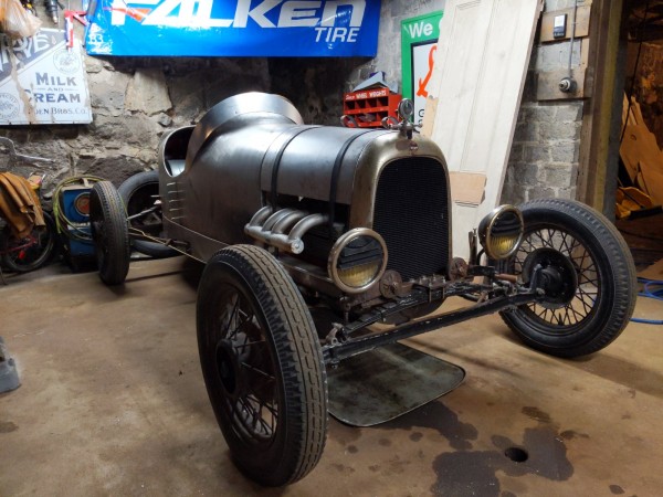

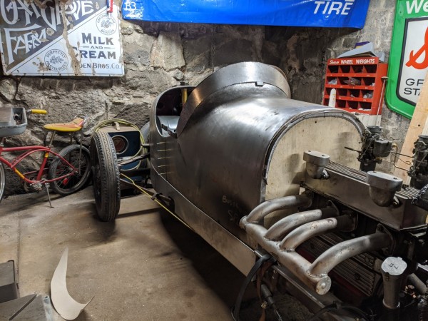

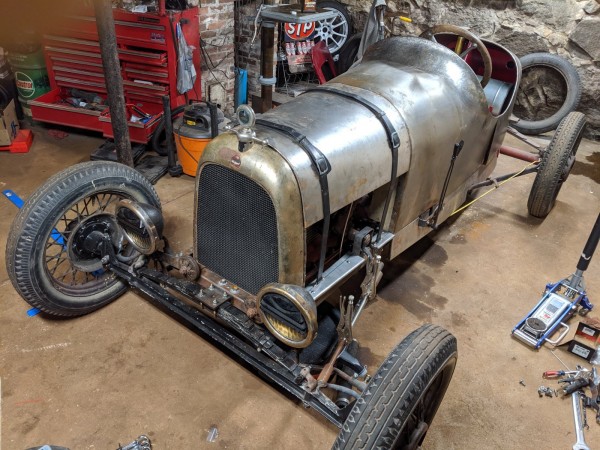

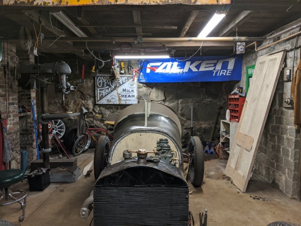

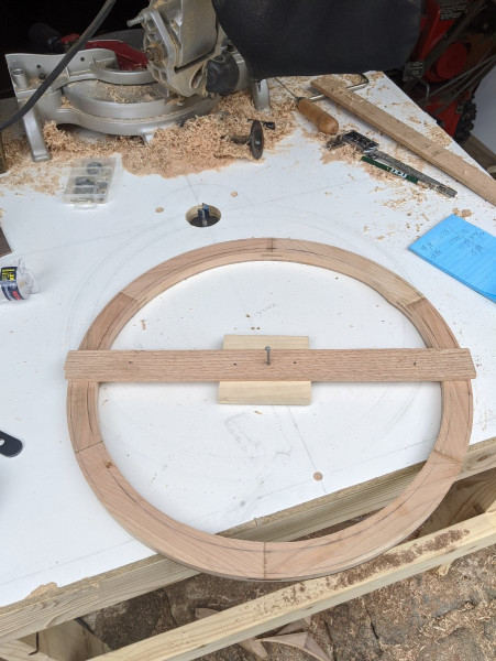

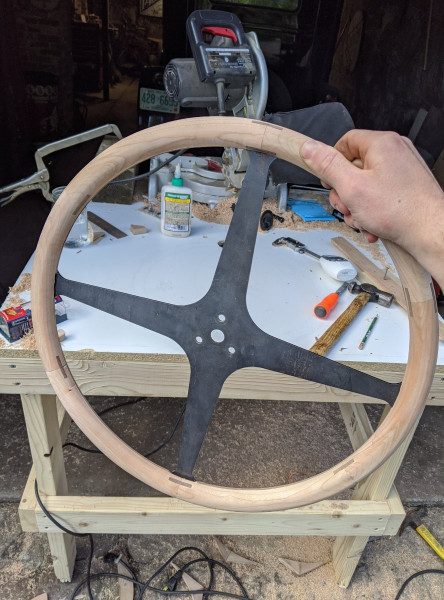

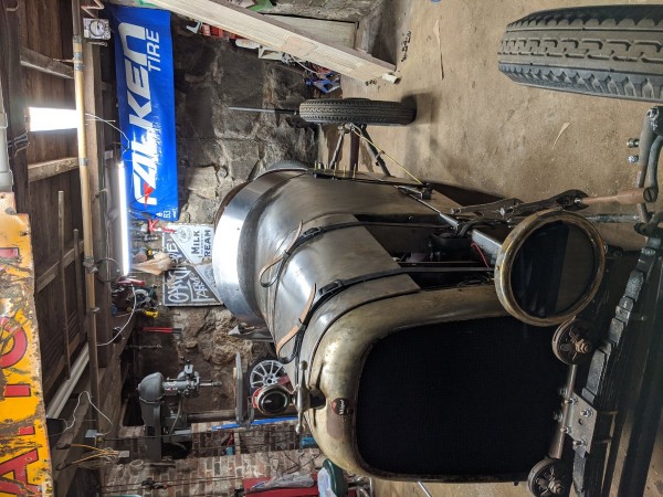

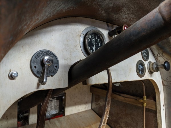

Here's the hood sitting on the hood former.
This is the dash wire form I made. The dash will secure to this.
Cut holes and fit all my goodies.

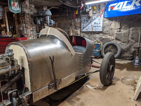

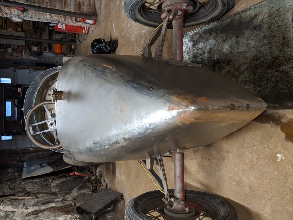

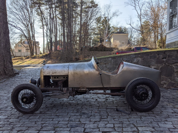

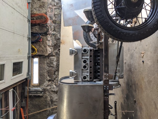

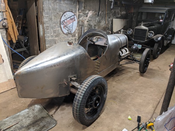

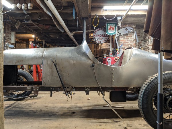

I plopped the body on the frame again to see how everything fit. I'll have to cove out the firewall a half inch or so to clear the back of the engine but much better than it was!
Best feeling staring at this thing.

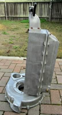

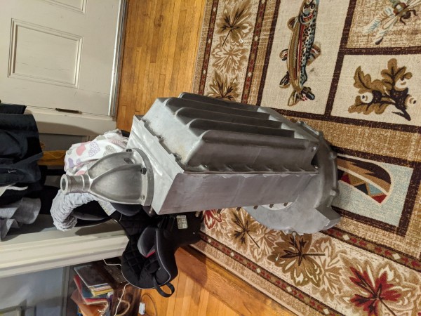

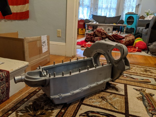

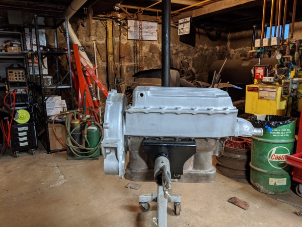

Hey Harold. The current plan is to aquire a Frontenac oil pan and transmission adapter which deletes the model t transmission and converts to model a. That should simplify the driveline conversion. I'll save the Sherman oil pan, t pan clearanced for the model a crank, vw oil pump, Watford, shortened t driveshaft and rear end, and t transmission for a future project. I'm thinking a totally period correct bobtail or something with a proper period power train.
RustyFords
- Posts: 1559
- First Name: Don
- Last Name: Allen
- Location: Houston, TX
Shane Lach
Topic author - Posts: 246
- First Name: Shane
- Last Name: Lach
- * REQUIRED* Type and Year of Model Ts owned: 1927 Tudor and 1921 speedster in progress
- Location: Milford, NH
Unfortunately I can't get my hands on one. They're all on engines or the ones that are sitting on shelves the owners don't want to get rid of.

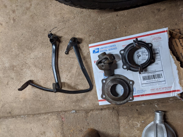

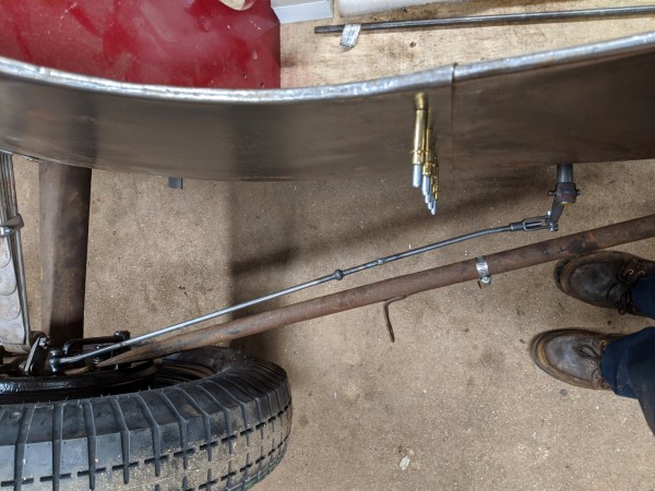

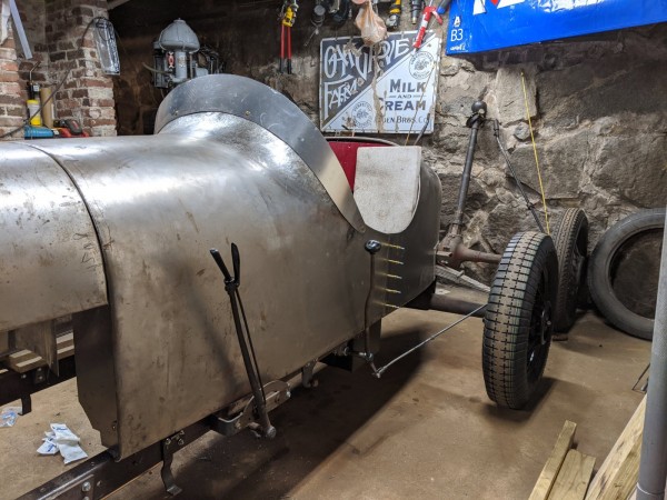

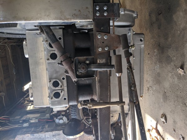

Thanks Harold! I'm glad you guys enjoy it and I'm happy to share my trials and tribulations. There isn't much out there in terms of speedster build threads so I'd like to put some info out there for others.

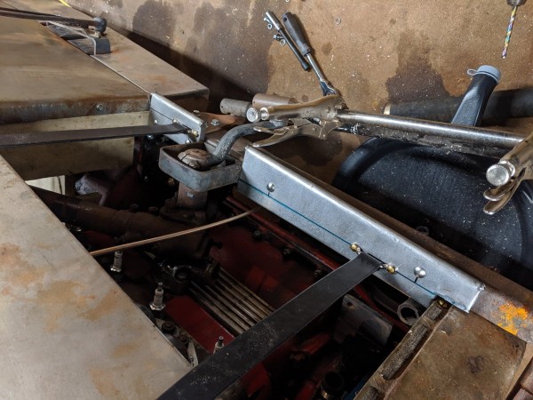

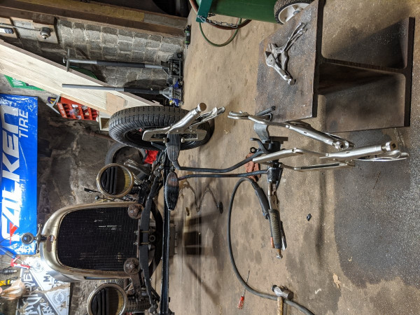

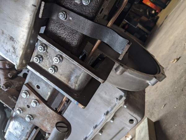

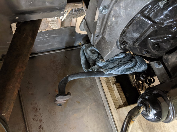

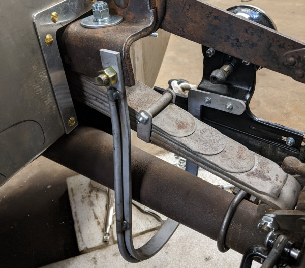

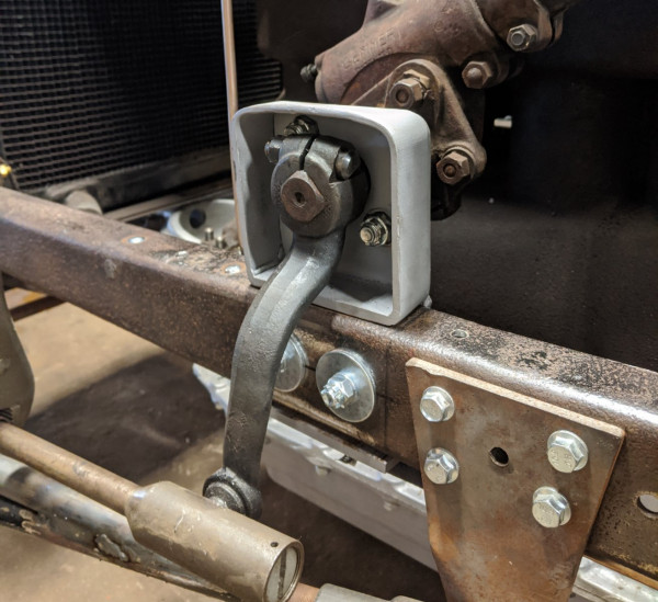

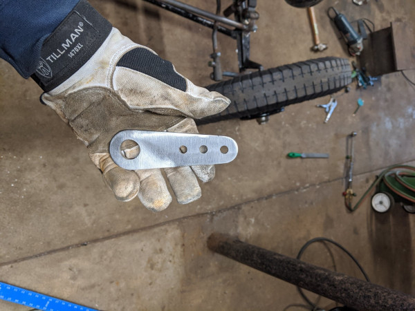

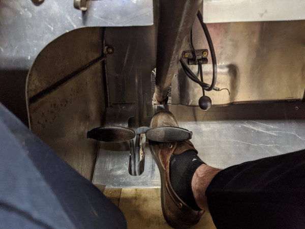

I began working on the brake system recently. I chopped up a couple brake cross shafts and some 3/4 rod. I extended the shaft a few inches in each direction, beveled, and welded them up. I removed the pawl for the t transmission, slid on some brackets to mount it to the frame, and added the brake rod levers. I used some brackets with bronze bushings and a ruckstell shifter out of my Tudor that the previous owner had made. Before installing the levers I added some lock collars to the shaft so it remains centered on the vehicle.
Mocking up placement
It sits perfectly in reach when in the car fit to me.
Brake rods made
The forward most handle will be for parking brakes, and the rear will be for service brakes.
I will be adding another pickup point on the cross shaft and connecting it to a brake pedal. That way I have the option to use my foot or hand to slow the vehicle. I really like the outboard brake handles on the old racers but wanted the convenience of a foot operated brake as well.
Brake rods made

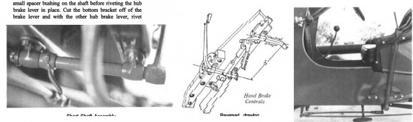

- Posts: 6588
Here is a design fora relocated outboard hand brake

Hello Shane:

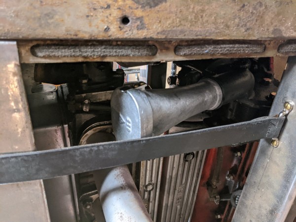

Not to get the cart before the horse....curious what the "radiator to motor" hose configuration will look like?
Regards,
Scott
Regards,
Scott
Shane Lach
- First Name: Shane
- Last Name: Lach

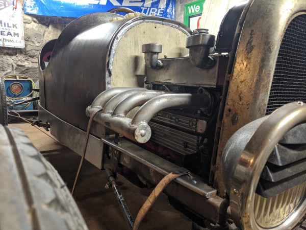

Hey Scott. Once the engine is rebuilt and in the car, I will be blocking off the top tank fitting and adding one to the bottom of the top tank. I took photos of Mike Benders bob tail racer and this is the way he did it. I will share the photos in a moment.

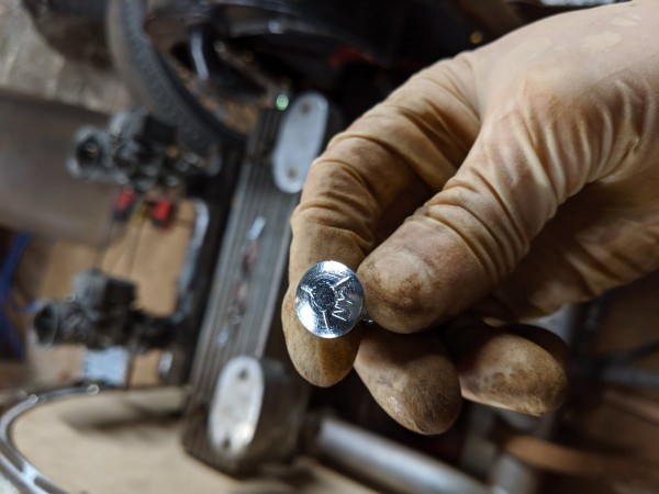

Target aquired. Thanks Dan!
Now that that hurdle is over, I will be purchasing a balanced full length A crank and sending my block out to Mike Bender for some Babbitt and crack repair. I can't wait for final assembly!

Holy cats! The holy grail!
RustyFords
- Posts: 1559
- First Name: Don
- Last Name: Allen
Wow...that is a cool piece.
Cooling fins and everything....so neat.

Well I tossed a spare block on the pan and began mock up. I used some 1/4" plate bent and braced/welded for the flywheel housing mounts. I drilled a half inch hole through the housing ears and the new mounts, added some rubber washers to insulate it, and used a lock but so I can leave the bolt a little loose so the ears don't sustain damage due to frame flex. Everything will be riveted to the frame soon instead of the bolts seen.
Shane Lach
- First Name: Shane
- Last Name: Lach

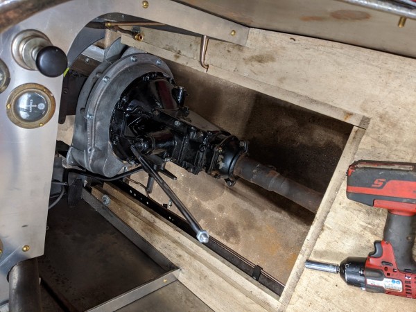

Mounts are done and my clings adapter came in. I'm installing a 39 Ford transmission on this thing for the best pre-war driveline I could come up with. I will be running a turned down model a flywheel and a 9" V8 clutch/pressure plate setup. I just shortened the torque tube today and got that all mounted so now I can move onto the rear radius rods.
Here's the transmission mounted up to the clings adapter mounted up to the fronty pan. What a money sucking contraption.
Torque tube bolted up. Just have to shorten the driveshaft and then I can do a final rear end assembly/set backlash.
And there's the torque tube mocked up.

I got the pedals all mounted up this weekend. I used model a pedals bent and cut then welded to get them to sit where I need them. I'm happy with how they turned out. Just enough clearance to press the clutch and brake.
I'll make some floor boards tomorrow.

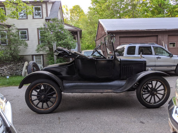

Update time!
I rolled the car outside to take a photo for my monthly motivation a while back
I made a floor board and mounted my throttle pedal to the firewall. I used a sheet of aluminum that I used for the firewall and other doodads.

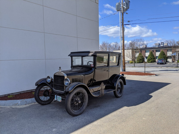

As a side note, I've been driving the Tudor as much as possible. It's great with the reduction in traffic lately.

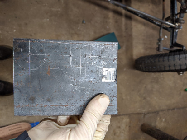

I then made a toggle lever to weld to the hand operated service brake cross shaft. I will make a rod to link this to the foot brake. That way I can use the foot brake for practicality, or hand brake for the true racer feel.
I drilled multiple clevis pin points for more or less brake pedal travel/leverage.
I ended up somewhat reworking my steering box mount. I had modified it to clear the starter, but now with the fronty pan the starter is in a different location. So I remade the bottom portion and officially bolted it to the frame.
Then we move back to the rear end. I needed to mount my Hartford shocks somehow. They're a bit long so I didn't have many options. I'd like a shorter pair but they're not easy to aquire. I cleaned them up a bit but left them crusty for the look.
First side down Unfortunately this left me with not much room for a taillight. I had to get creative.
I made this strap and welded a round bar to it to stop the springyness. I mounted my 26-27 accessory stop light to it with the license plate mount.
She's starting to get the complete look now. Can't wait for a big slash cut stainless exhaust. Something obnoxious like 4".
This has been one of my favorite threads. Having built a Speedster and 2 racers I can enjoy the whole design and ingenuity going into this. The photos are well done and show great detail.
And then there is the cute baby.
But even more than that is the delightful workshop of brick and rock with such warm and rustic features.
I visited here today to get some of that awesome feeling for some painting details.
What a treat this has been.
Thanks for all of this.

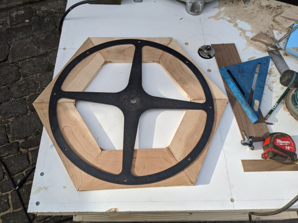

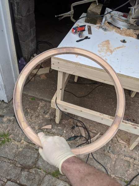

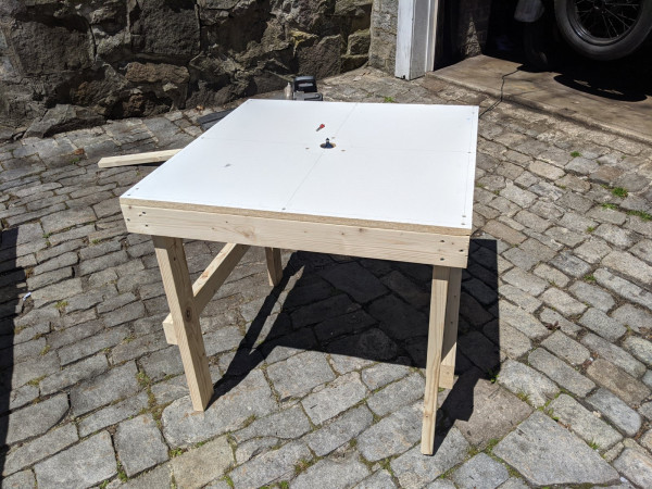

Progress has been slow lately. Tackling much needed home maintenance. I did however have some time to tackle a steering wheel project. I had a cracking issue with the Neville so unfortunately I think it's unusable. Therefore I bought another wheel and decided to make my own wood rim. I decided on cherry with a walnut 1/8" laminate down the center. First I built myself a router table out of some melamine as it's pretty flat and smooth.

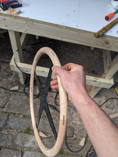

Then I cut down my cherry into equal parts at 30* angles to make a hexagon.
Then made a center point and a compass essentially. Traced my wheel and dimensions onto the wood and made a rough cut with a jigsaw. Don't try to take more than 1/8" off it you'll tear out the grain on the router.
I routed out an 1/8" pocket for the wheel to sit in. Another hexagon will be made and epoxied to the back sealing everything together.
Chisel out the spoke areas so the wheel sits in the rim and here we are!
I had made a back half but destroyed it on the router table. I ordered more lumber and hope to wrap up this project this week.

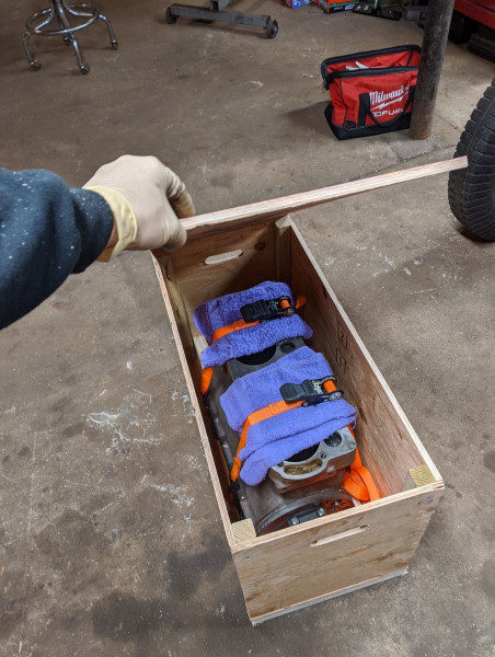

Also, Mike Bender has my engine for Babbitt and crank fitting currently. After that the powerplant will be completely refreshed and ready to run for good this time.

Hey John. I shipped the engine block out last April and have not received it back unfortunately. It has been very slow going getting it re-poured. The goal was to have it done and raced at Lincoln this year but it doesn't seem like I am going to hit that goal. Pretty disappointed honestly. Haven't touched the car in like 9 months. I need the engine back to button stuff up and do some test miles to ensure everything is going to be ok where it is.

Mr. Bender has the block currently. There has been a handful of snags here and there but as of a couple months ago everything should be squared away in terms of issues. I am actually building a new shop and am hoping to tackle this thing head first once it rolls in there. The foundation is poured and awaiting backfill and framing. 32'x42' 3 bay shop behind my house. That should give me some well needed room as I have been tripping over stuff lately.
I did however purchase William Harper's runabout last year and did a quick gowjob build.
As purchased
3" drop axle, Chevrolet front hubs, 19" wire wheels, chopped and raked windshield, steering column drop, gas tank relocation to turtle deck, seat lowered
Rear axle rebuild, flipped housings, second rear crossmember added and spring moved ahead, torque tube shortened, aluminum over under Warford installed. Custom Chevrolet spacers added to clear Rockies.
As purchased
John Warren
- Posts: 1071
- Last Name: Warren
- Location: Henderson, Nevada
That's Nice too! Touch base with Mike, He may need someone to race against.

Who is the “gentleman” who made your tank?
He could be in big demand these days!
Shane Lach
- First Name: Shane
- Last Name: Lach
Billy Gilliland made my fuel tank. Unfortunately he passed away last year.
Here's a photo of some metal work. Im shaping this patch for Chads gowjob project.
Nice!Shane Lach wrote: ↑Thu Feb 18, 2021 12:22 pmPXL_20210217_231012307.jpg
