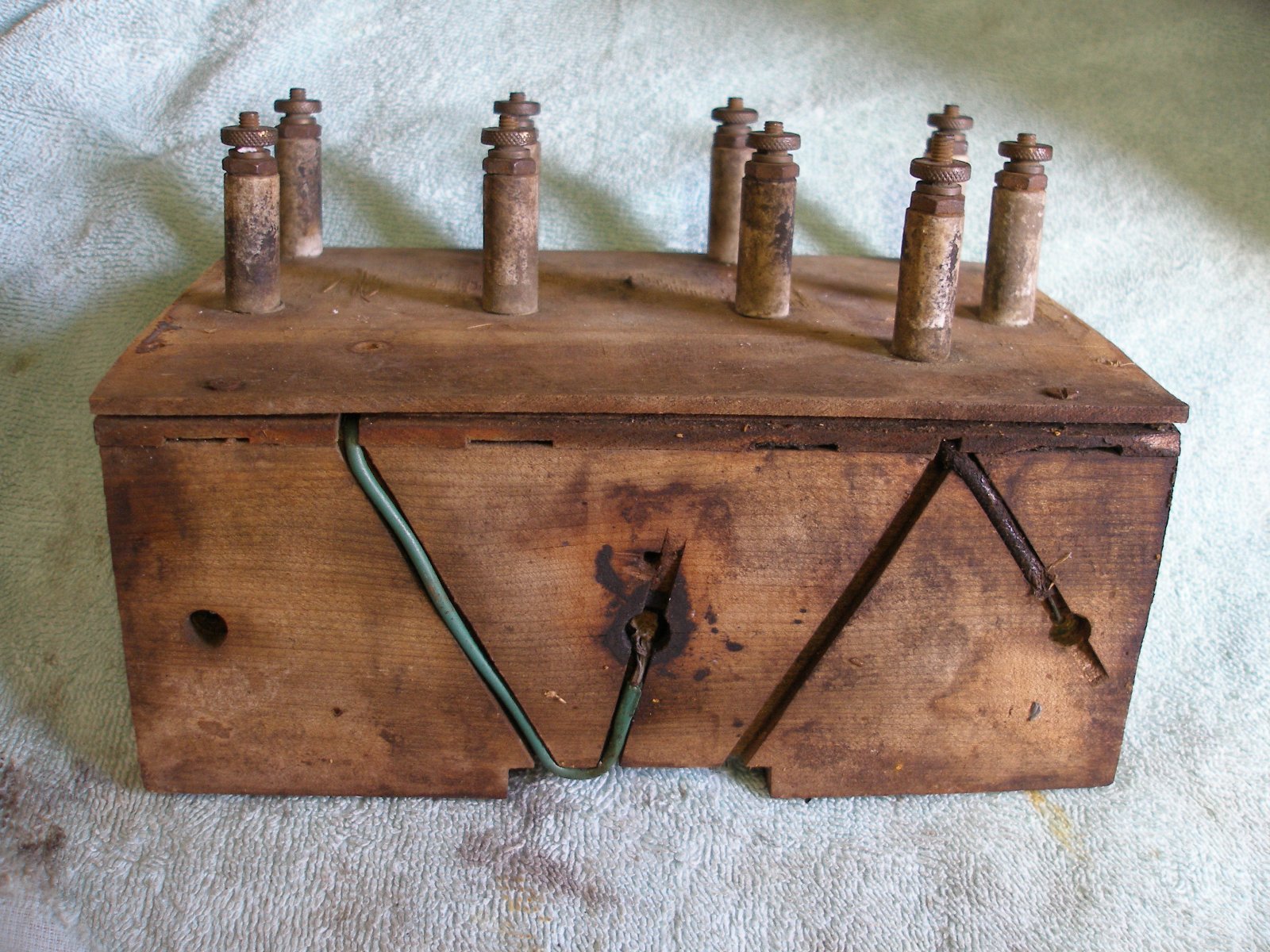

On a 23 you Your switch should have a post on one side for battery and on the other side magneto. wire and connect the battery to that side of the switch. Tape up the magneto wire so it won't touch anything connected to the battery. Then run the engine on battery with the switch in the magneto position. If it still cuts out, your problem is in the switch, the wire, or the coil box. While you run on battery, you can also test the magneto output to see how much it produces. You need an analog AC volt meter. You should have at least 6 volts at idle and higher as the speed of the engine increases up to around 30 volts AC. Note, at high speeds the bulb might burn out. Test between the mag post and ground with the meter across a 6 volt light bulb. When a magneto gets weak, sometimes it will drop below 6 volts at idle or low speeds and will work OK at higher speeds. In that case the magneto either needs re-charging or you have too much end play in the crankshaft. The flywheel will move away from the coils when going up a steep hill or when you depress the clutch into neutral or low gear.

Question: If the engine runs fine on battery how can the problem be with the coil box if it won't run reliably on magneto?
- Posts: 6596
Re: MAGNETO TROUBLESHOOTING
There is wiring, pinch points, and insulation resistance all to consider.
Your box may or may not have the 2nd post for the mag connection...I don't recall from your posts. Anyway, here is what goes on out of sight on this version of coil box wood.

Don’t know if you’ve rebuilt the coil box but an intermittent can certainly occur because of an original coil box. Age catches up to coil boxes as with other original electrical components.
When restoring a T the coil box is the first thing to rebuild in the electrical system.

Thank you John. Your suggestion is good but if the coil box is the problem wouldn't it not run when on battery as well?
- Posts: 7342
...if the coil box is the problem wouldn't it not run when on battery as well?
Correct. On your 1923 the coil box has only one input. It takes current from both the battery and the magneto. That makes the switch a leading suspect. I would first determine whether there's normal output at the mag post. If there is, then the problem has to be somewhere in the path from the mag post to the coil box. That would be in the switch or one of the connections. A problem I once found there was a cracked terminal block that kept one of the screws from making a tight connection.

I was thinking the coil box may be out of adjustment, but since there are four of them, they would never cut out all at the same time, so that's not it.

If it hasn't been mentioned already, a possible point of failure is in the ignition timer, which some people also call a "distributor." If the main power lead to the timer is cutting out, it could cause all four ignition coils to stop working.
A timer and a distributor are two different critters. A timer has no main power lead going to it. It's a rotating switch that grounds each of the four wires from the coils in order. A distributor has a single main power lead from a single coil, and distributes high tension current from the coil to each of the spark plugs in order.
From what I've read so far, I assume this car has the Ford setup of a timer and four coils. The fact that it runs normally on battery says the timer is OK.
