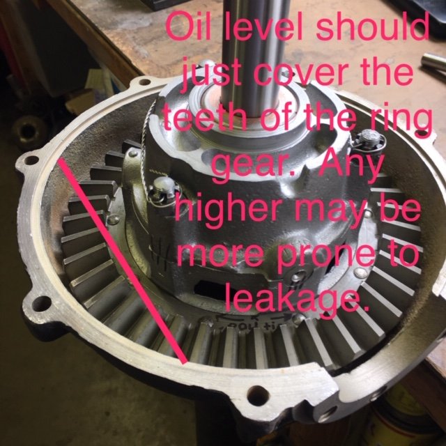

A fellow with a lot of experience shared with me that it was only necessary to add enough oil to the differential to cover the teeth of the ring gear. Any more tends to result in leaks. (see photo)
I decided to experiment by adding straight mineral oil and looking thru the opening in the front of the pumpkin so see the level. I found that 20 ounces (1.25 pints) was enough to cover the teeth and ride high enough that the hub of the differential just touches the oil. It is well below the opening to the axles which should help prevent leaks. Using my homemade dipstick I measured the oil level at 1.5 inches below the fill hole which I've been told is where you want it to be. Note: My fill hole is on the centerline.
I suspect that after use some of the oil will be distributed into the hyatt bearings and other mechanisms and a little more oil may need to be added. Nonetheless, I think 20 ounces is a real good starting point. Note: This is just my opinion - time will tell the story.
