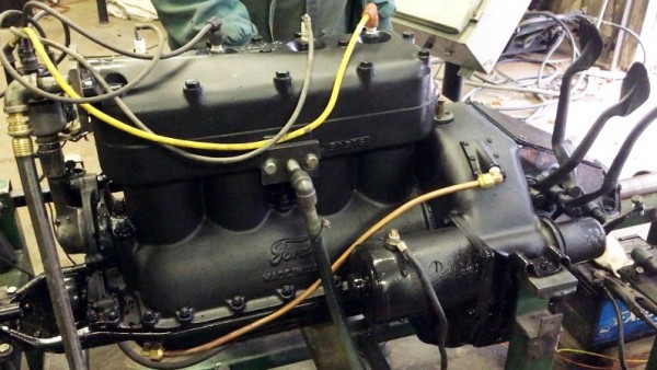

I'm in Bob's camp on this discussion - I also own a '14 Touring that I converted (and hid most of the components) for an elderly customer many years ago due to his inability to hand crank any longer and after his passing, we were offered the T. Other than one hole drilled into the front seat panel, no harm, no foul !
