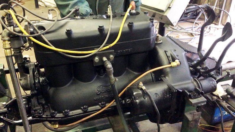

I have a 1917 Touring that I've had a starter installed on. The car sat for many years and had no maintenance history so I wanted to go thru it anyway. With brian_d's help we pulled the engine and took it to a fellow who is set up to overhaul Model T's. In addition to updating and overhauling the engine and transmission, we installed a later model hogshead, rebuilt coil ring, and built the magneto up on a newer-type flywheel with a starter ring gear.
I did not install a generator choosing to go with a "total-loss" system. An "intelligent" plug-in charger in your garage will keep the battery up and you can get a lot of starts between charges. I have a similar setup on my 73 year old non-electrical airplane and it has worked great. There is also the option of going with a Fun Projects Hot Shot Charger, a simple device that uses current from your magneto to help keep the battery up. The latter might be useful if you plan a number of days on tour and have nowhere to plug in your car at night.
It cost me a few bucks but I now know the condition of my engine - what parts and seals are installed and I have a starter. The uninitiated wouldn't be able to tell the difference between the car now and before. As others have pointed out, you have options. You have to decide your priorities and go on from there.
