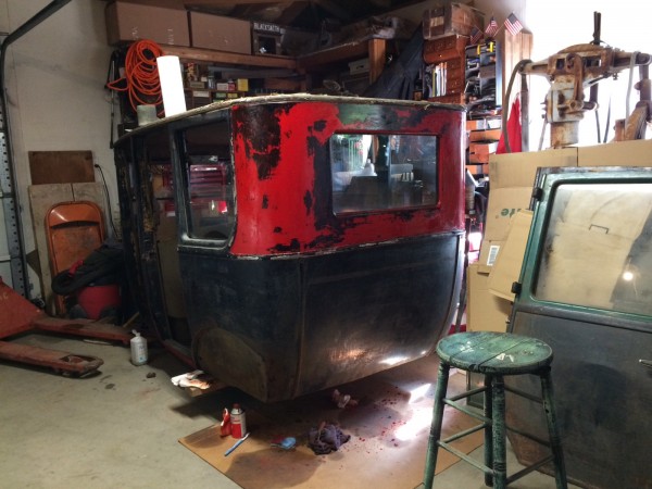

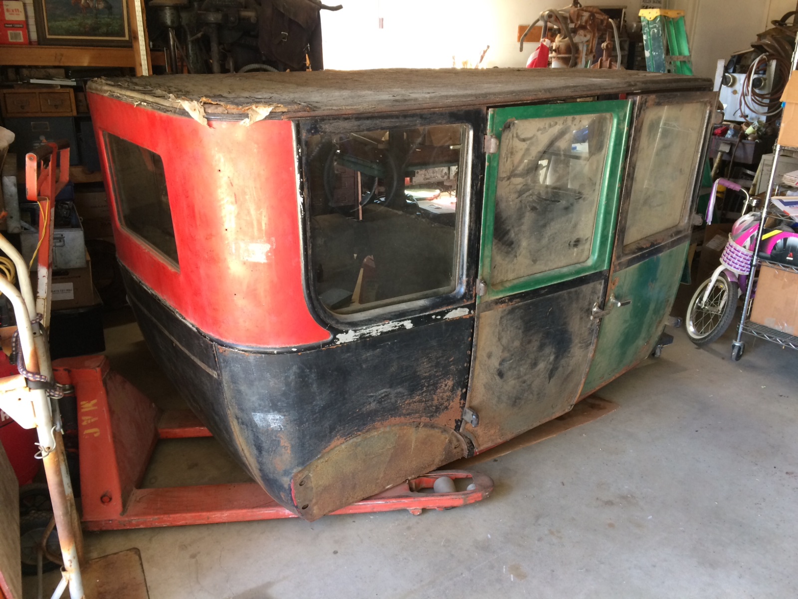

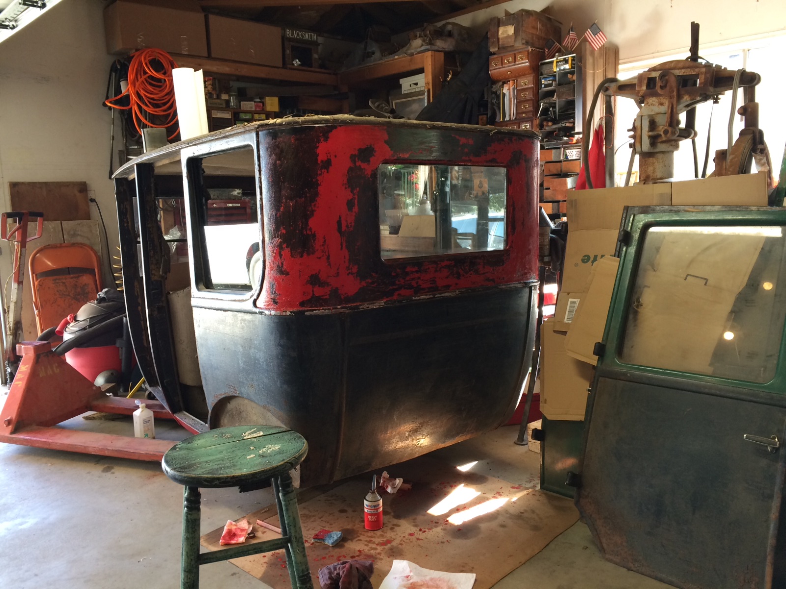

Just bought a 1926 unmolested Fordor Body
Post by Matt in California » Sat Nov 02, 2019 10:42 pm

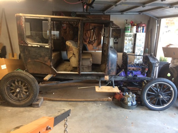

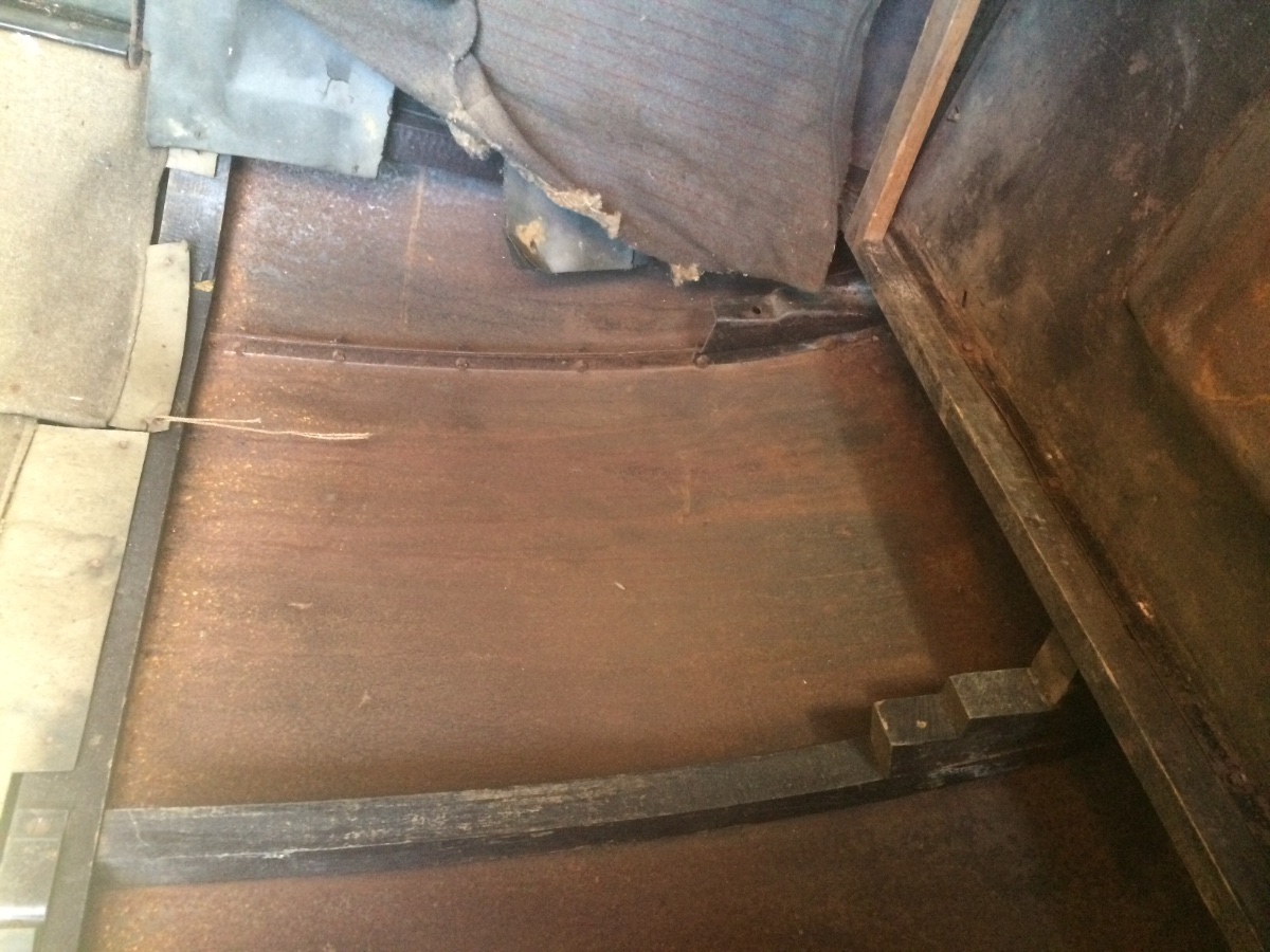

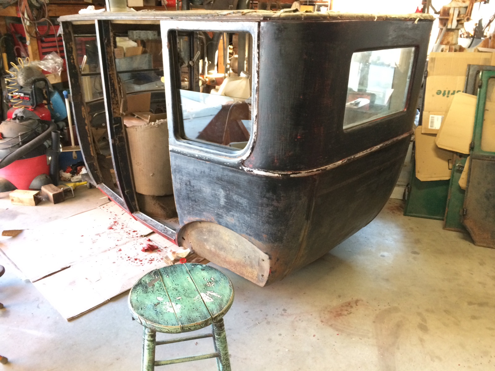

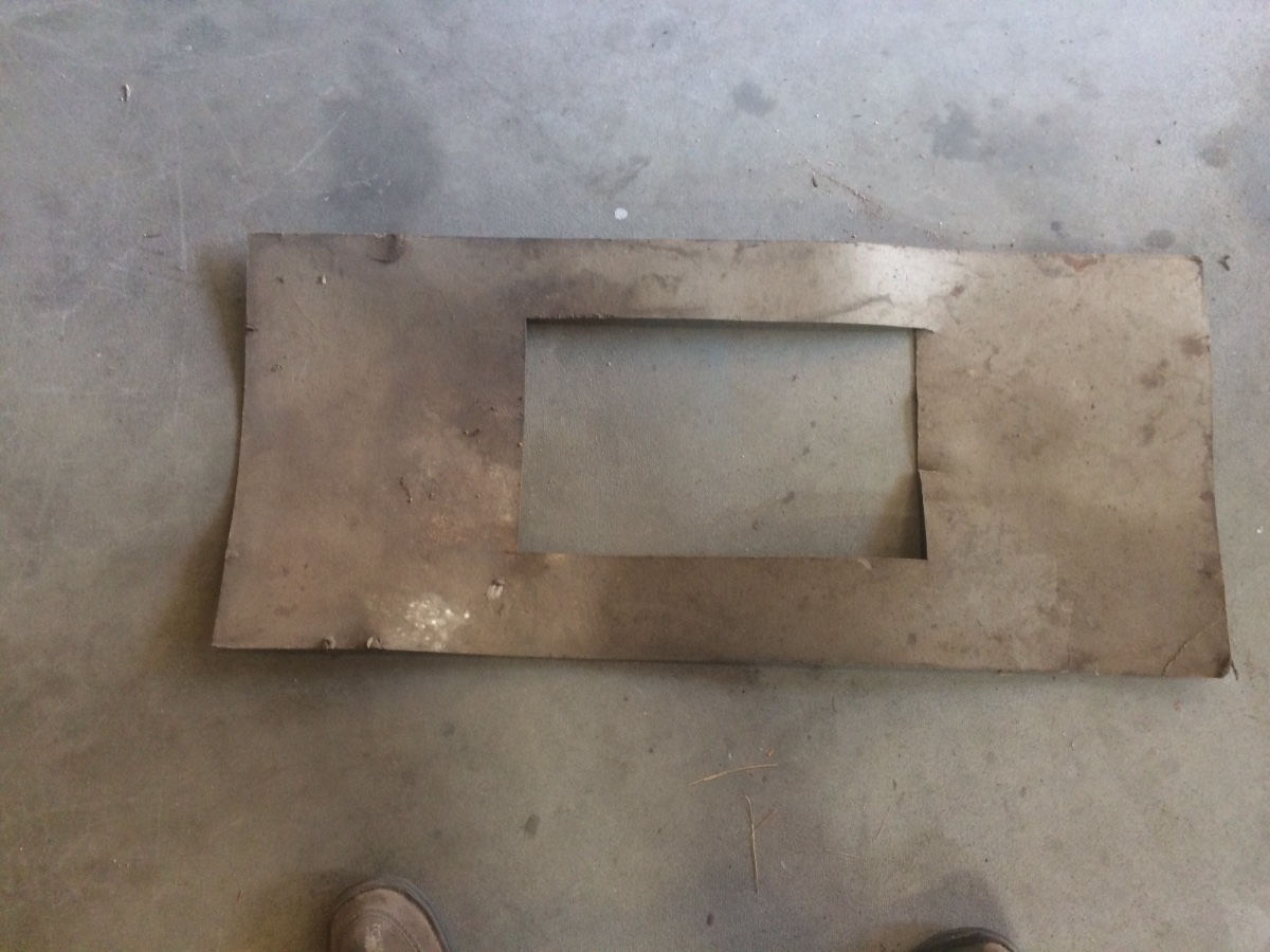

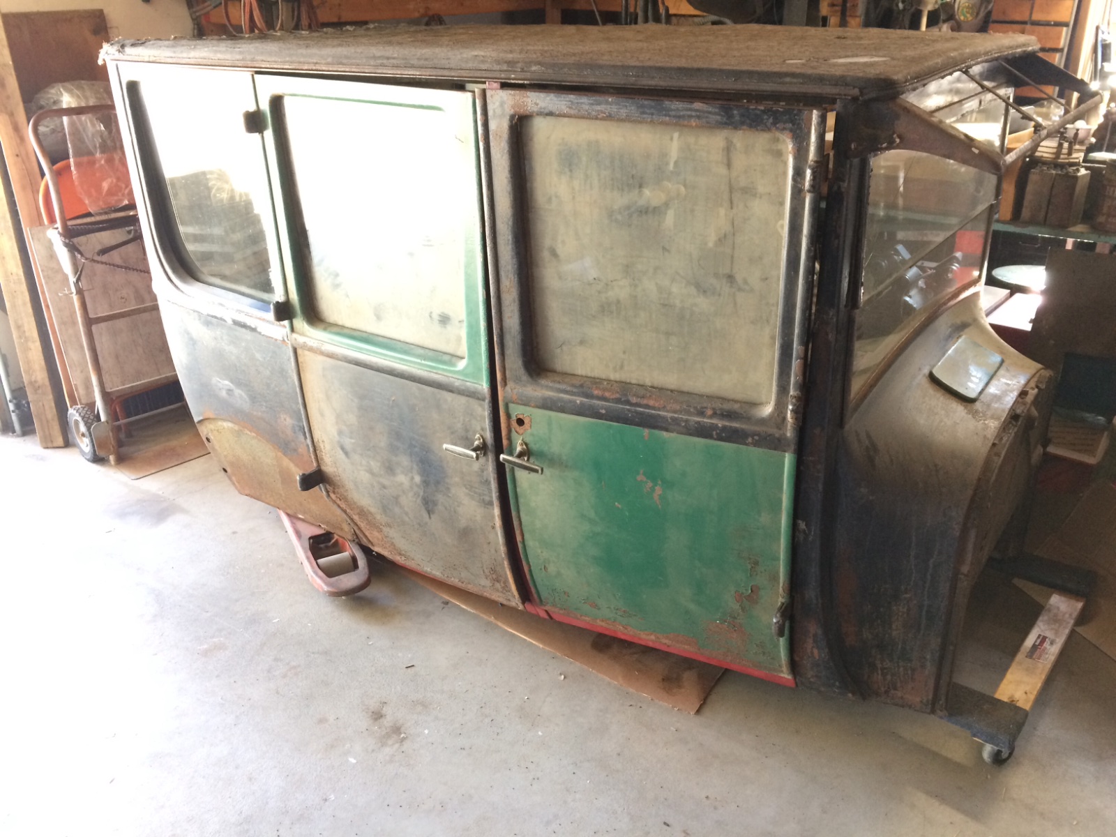

Okay they did add some accessories and had an interesting concept going with the paint, but everything looks very original. I don’t plan to restore this, but I do plan to put it on the correct frame. I am in a hunt for matching fenders and splash guard.
I would love to get your comments. I would also like to photograph this to preserve history for others who are looking for details for restoration. If you have any questions I would be happy to take pictures in the areas you were interested.
This body was sold by the grandson of the original owner. If I understood things correctly his father attempted to restore it but the project out lived him. The car was moved from Maine our West. Evidently it set from the 1970s until now. It also seems to have avoided the salty road conditions. So it must’ve been before they did that but it was no longer in service.

Don’t Molest It
Post by FreighTer Jim » Sat Nov 02, 2019 11:03 pm
It is the only one in existence that looks exactly like that.

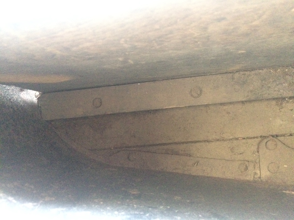

I have never seen rear floorboards that come in two sections like that.

But David, don't you remember the story? Henry was using up pieces of shipping crates. :)

I don't see anything special with a two piece rear floor boards. Vendors sell them: https://www.modeltford.com/item/3626CRH2.aspx
Perhaps from the photo it was not clear that this was from the rear. It is much easier to service the battery with these.

It is colorful. Wow, that upholstery is amazing!
We let one like that slip though our fingers when a group I worked with liquidated. I got more than my share but enjoyed that one.
It's always interested me how much the Fordors carried over from the earlier ones.
Thanks for these and any future photos you have time to take.

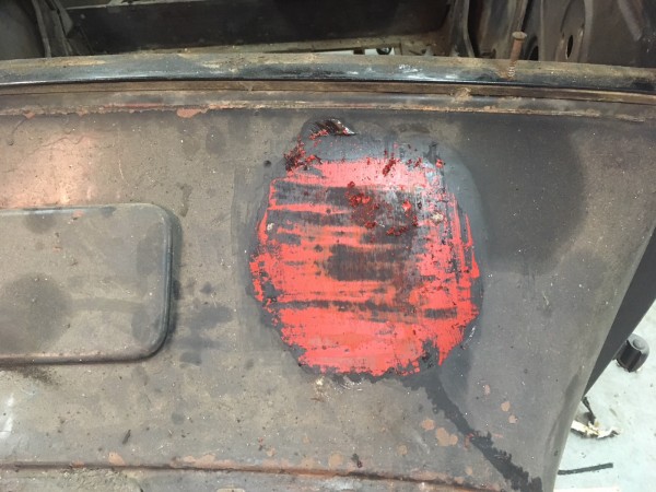

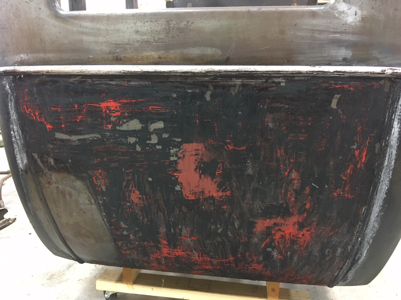

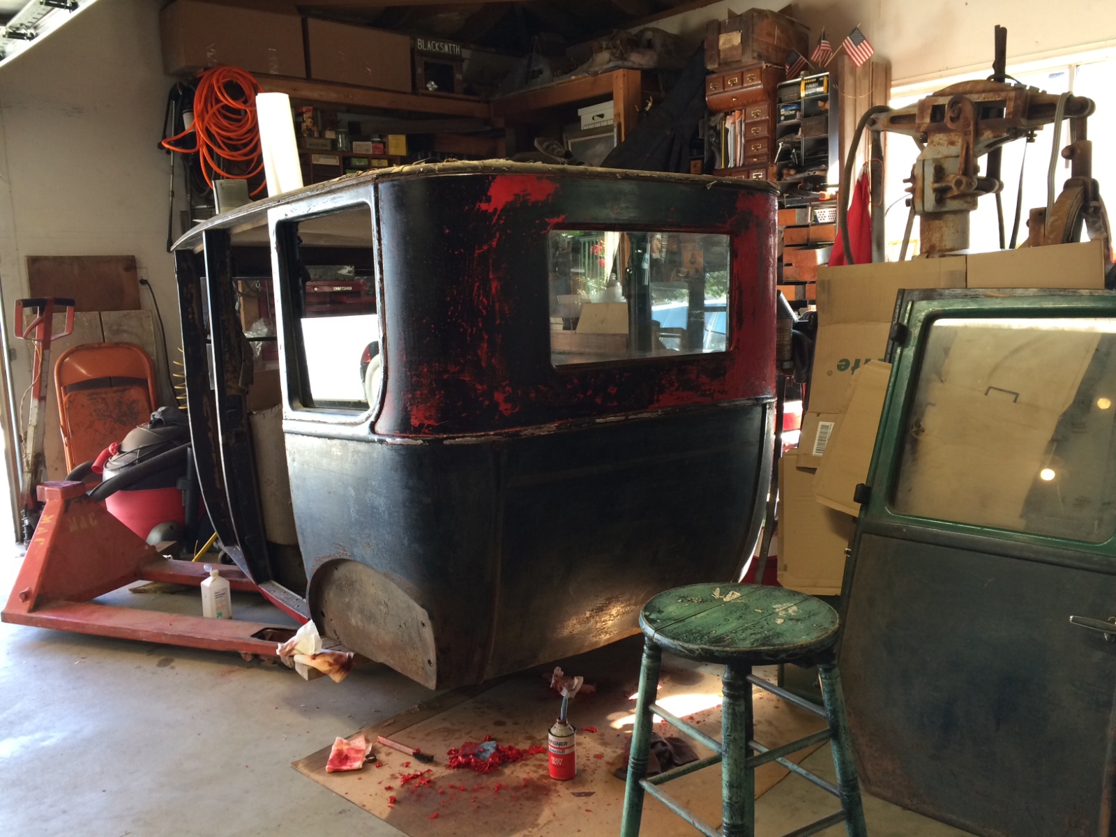

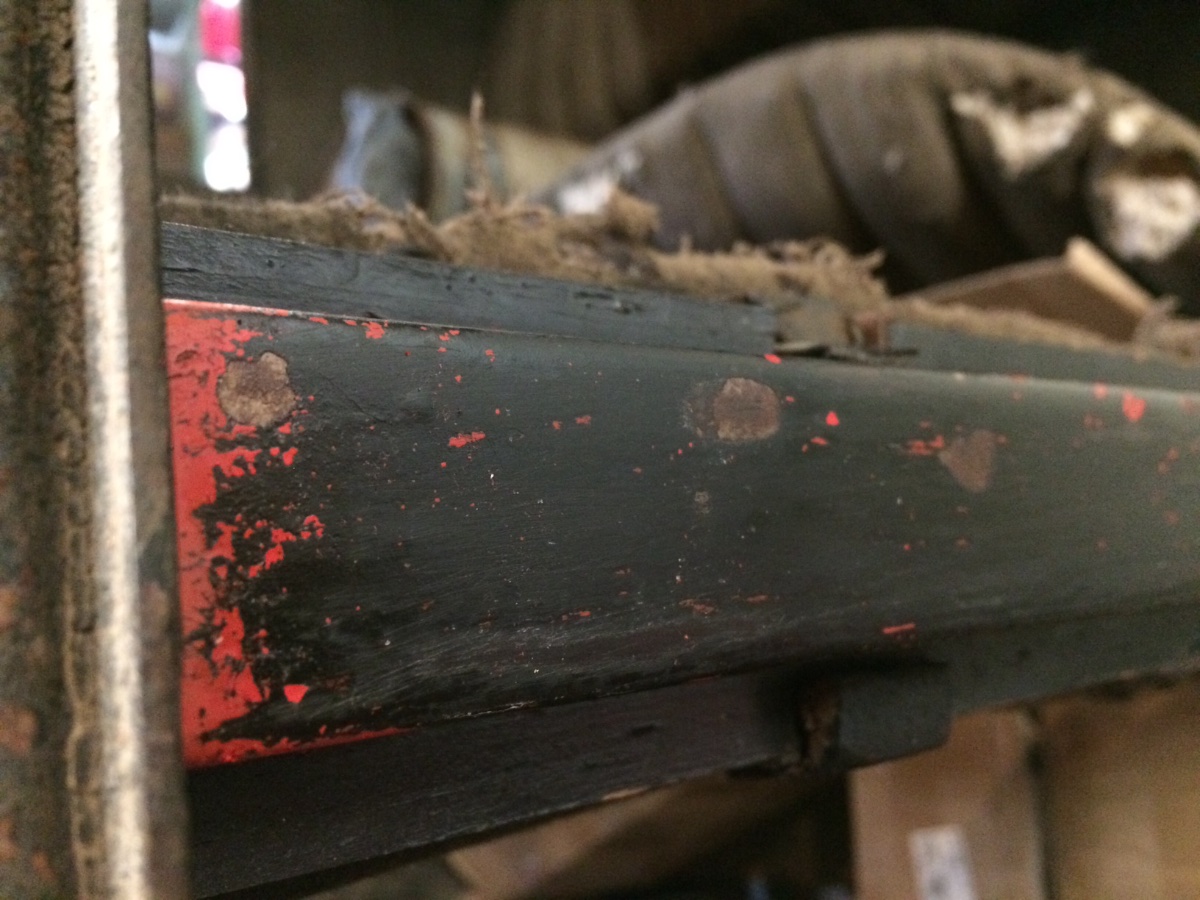

I am restoring a 1926 Fordor and I am finding traces of that same red color. Could that be the original color? I thought the 26 Fordors were either maroon or black.

Bill,
This car was originally Ford black day and night.

Seeing the doors installed brings the color pattern together. Maybe it served as some sort of taxi or shuttle car.

Color
Thanks for all the input on the Fordor color. For mine it is very clear that the car was originally black. I didn’t think much of it, then I noticed in Bruce McCalley’s book he mentions in 1926 Fordor should be “Windsor Maroon.” I wonder how many made it out with that color.

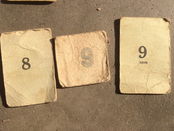

I found this in one of the door pockets.
Does anyone know what these are?

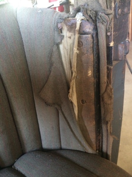

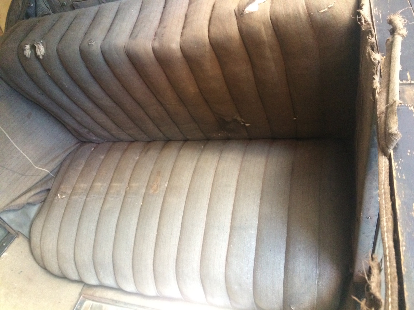

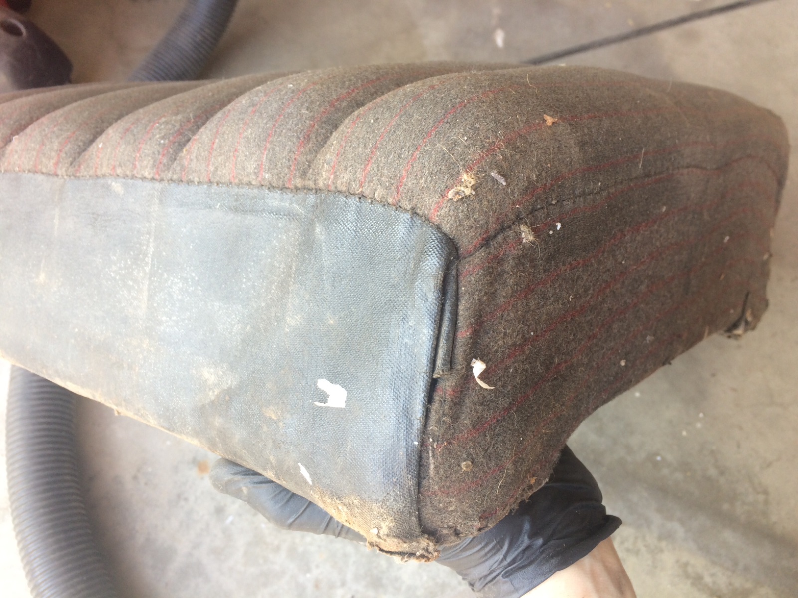

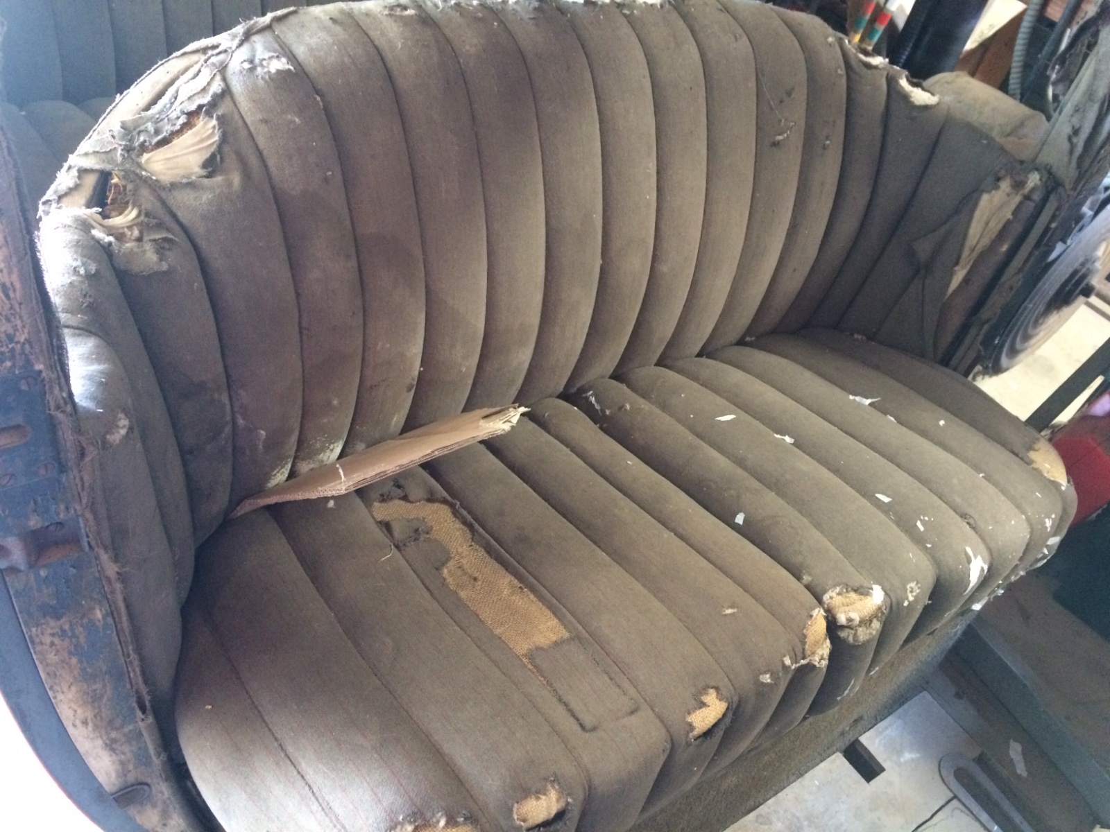

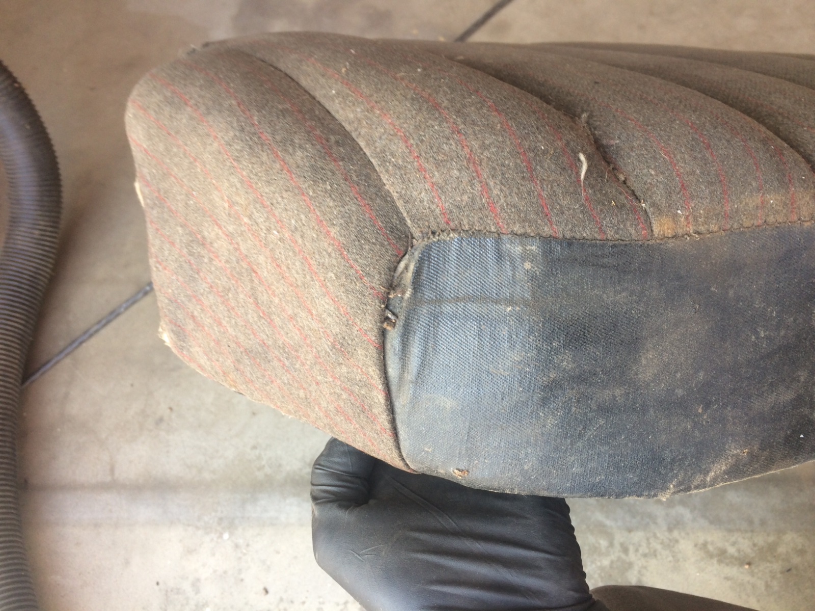

I have an all original, never restored 1926 Fordor with the original wood, roof, interior and upholstery. The only thing un-original, is the red paint job that someone applied to the metal of the body to preserve the steel of the body.
Bruce McCalley points out in his book that the uphostery of the 1926-27 improved styles is closely associated with the body and hood color (the fenders, splash shields fenders and radiator apron are black) which, if you are fortunate enough to have all or remnants of the original upholstery, it will tell you what the original color was. For instance, the color of the 1926–27 Coupe was originally channel green from the factory and the upholstery had green stripes that corresponded with the green body color. By the same token, the factory body color of the 1926-27 Fordor was Windsor maroon and the upholstery had red stripes that corresponded with the maroon color.
In the photos of the subject Fordor of this post, even though the stripes are hard to see, it appears that the original upholstery has red stripes, which indicates that the body color was originally Windsor Maroon. Unless the body was thoroughly stripped, you may be able to find the original Windsor Maroon color by gently wet sanding a protected portion of the body. Jim Patrick
jiminbartow
Posts: 2468
Last Name: Patrick
Location: Bartow, FL
Re: Just bought a 1926 unmolested Fordor Body
Post by jiminbartow » Sun Nov 10, 2019 11:45 pm
PS. The bench seats, seat backs and door upholstery below the windows is striped. The upholstery covering the columns between and windows and above the windows as well as the ceiling is not striped. Jim Patrick

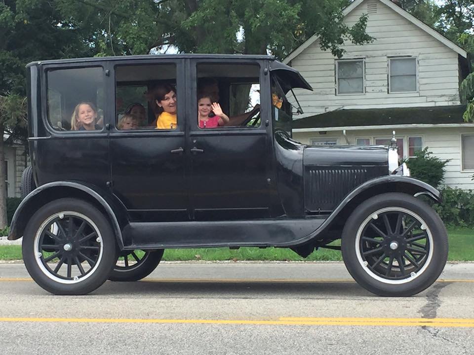

From the same encyclopedia. Pictured is my "original" 26 Fordor.
COLORS: All cars were painted black, with black fenders, initially. Closed cars were then offered in colors: green for the Tudor and Coupe, and Maroon for the Fordor. Other options offered later in 1926, perhaps for the “1927” models.
UPHOLSTERY: Imitation leather in the open cars. The pattern was a stitched vertical pleat design on both seat bottoms and backs. Closed car upholstery was gray cloth with green stripe on the green cars (Coupe & Tudor), and gray with a red stripe on the maroon cars (Fordor sedans).

Joseph, I love your photo! The last word of the quote above seems very important to this discussion- initially. What is your engine number or date of manufacture of your car?

Here are some photos of my front seats.

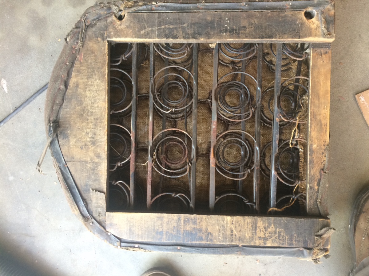

Post by Matt in California » Mon Nov 11, 2019 12:23 pm

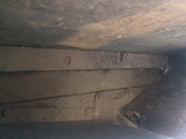

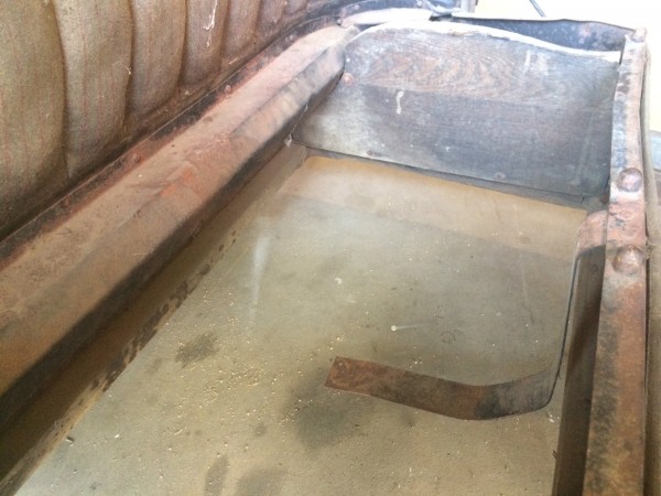

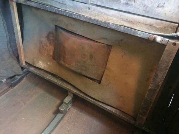

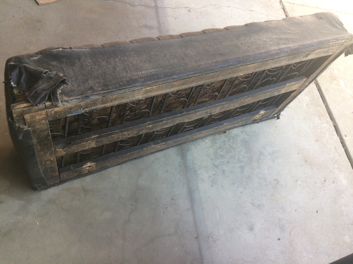

Under and the sides of the front seats:
Note: center strap bent, likely to remove gas tank.
Last edited by Matt in California on Mon Nov 11, 2019 12:32 pm, edited 3 times in total.

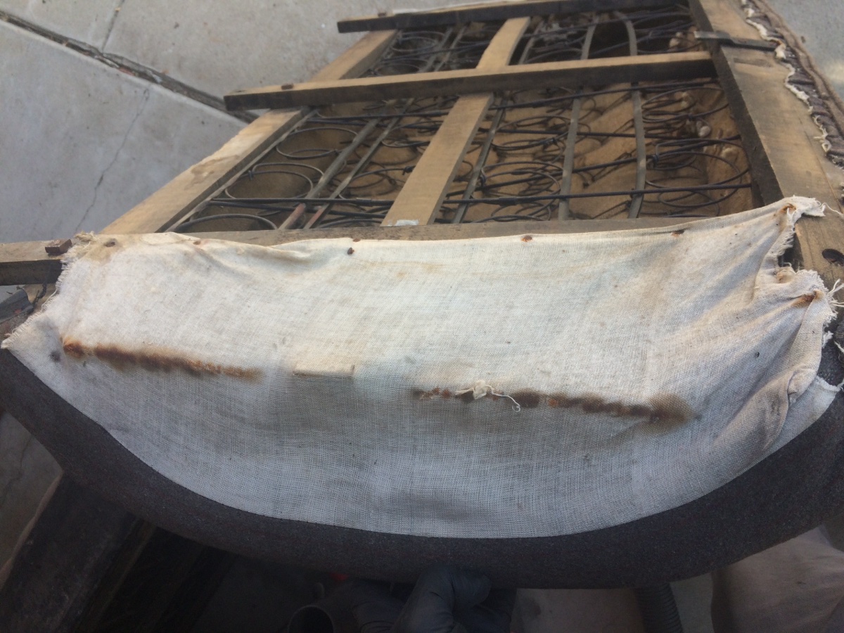

Post by Matt in California » Mon Nov 11, 2019 12:34 pm

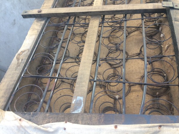

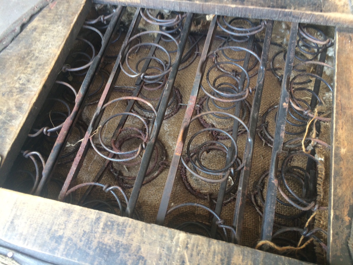

Under back seats:
Matt in California
Posts: 808
Joined: Sun Jan 06, 2019 5:42 pm
First Name: Matt
Last Name: G
Location: California

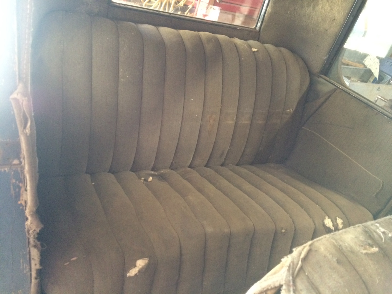

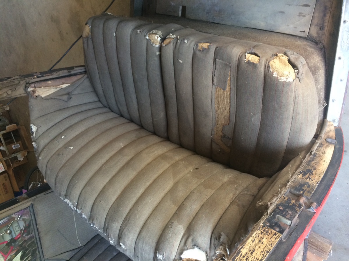

Post by Matt in California » Mon Nov 11, 2019 12:41 pm
Back seats:

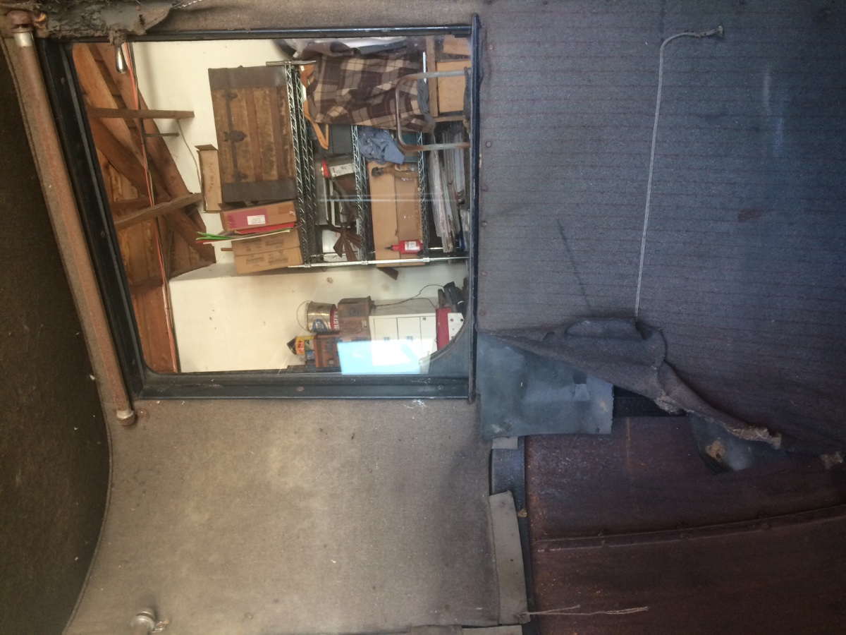

Post by Matt in California » Mon Nov 11, 2019 12:48 pm

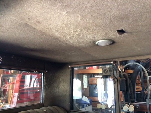

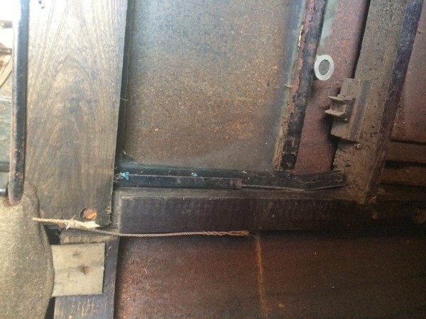

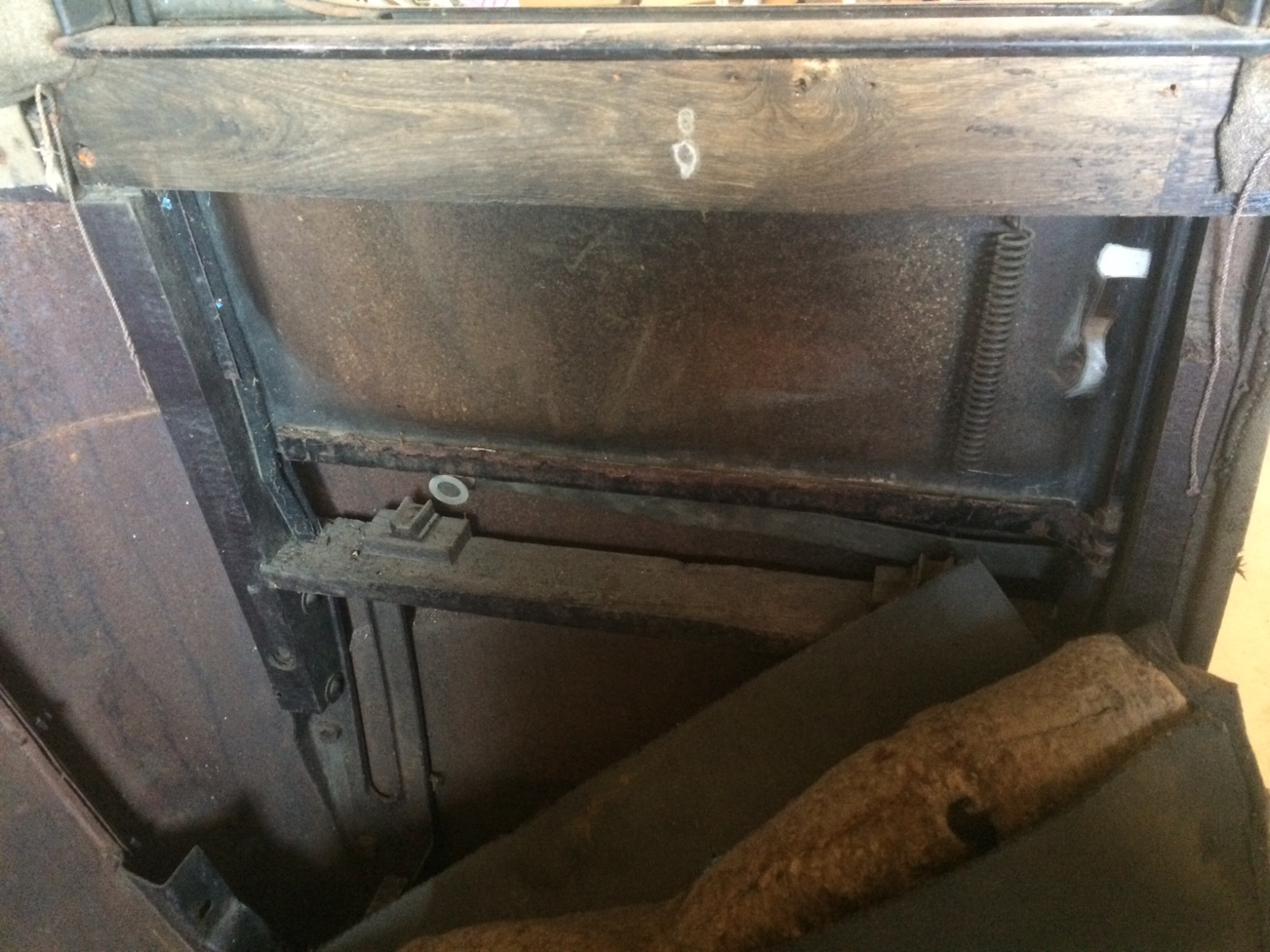

Rear side windows:
The little aluminum will above gave me trouble, but after I got it spinning it worked well.

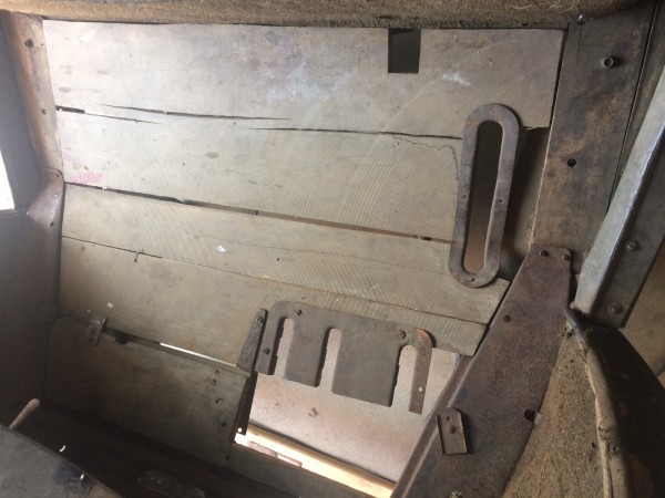

Rear floorboards:

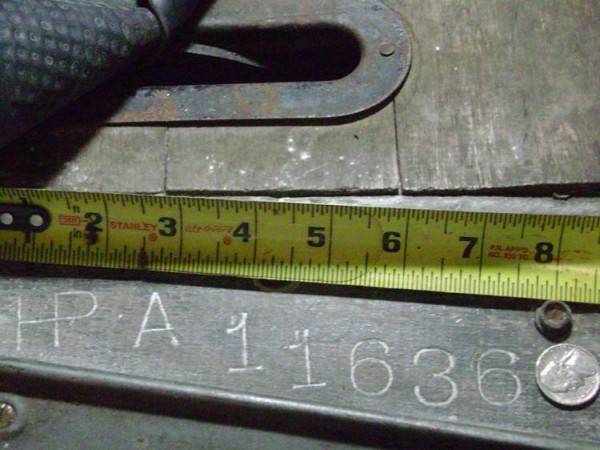

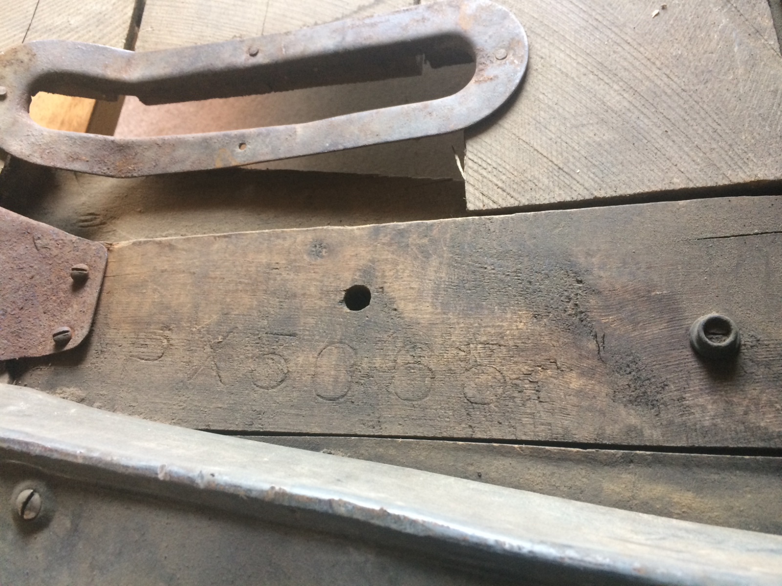

Front Floor Boards:
Note: the number above. Does anyone know what this is for?

Matt, In your picture above with the hand brake trim piece, you ask what the number shown is for. That's a body number from the plant where the body was built. I have a '27 Fordor and this number on mine begins with HP, meaning it was made at the Highland Park plant. I saw another one once that began with KC, meaning Kansas City. I see the X in your body number but can't make out the first letter. Do you know what that letter before the X is? If you can make it out, that will tell you where the body was built.
Hap Tucker has a thread going several years ago discussing this topic.

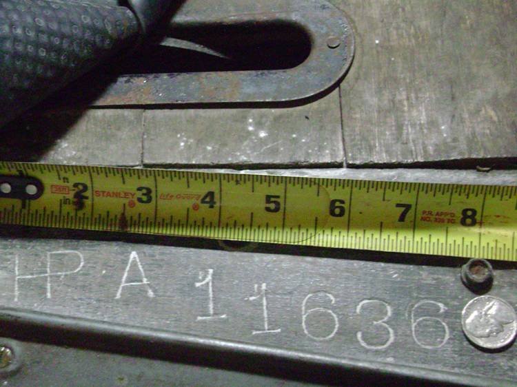

KeithG wrote:
Mon Nov 11, 2019 5:38 pm
Keith
Keith, I found this thread: http://www.mtfca.com/discus/messages/80257/111490.html
After some light brushing I found a HP mark very lightly written and was not able to take a photo, perhaps I will be able to bring it out with chalk. But it looked like this from the link above:
So my body number is: "HP X5065" So this is a Highland Park body.
Any insight on these number is appreciated!
Matt

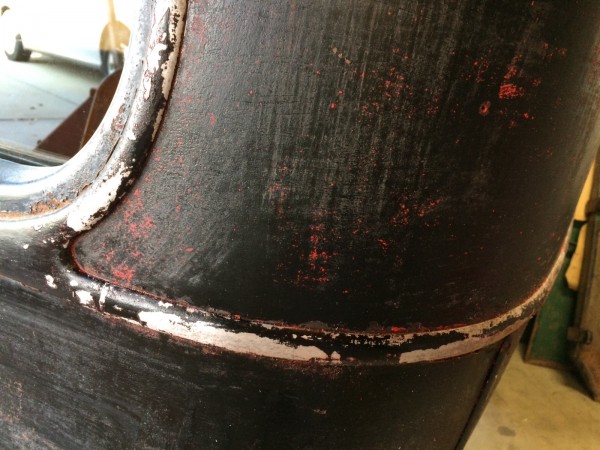

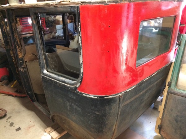

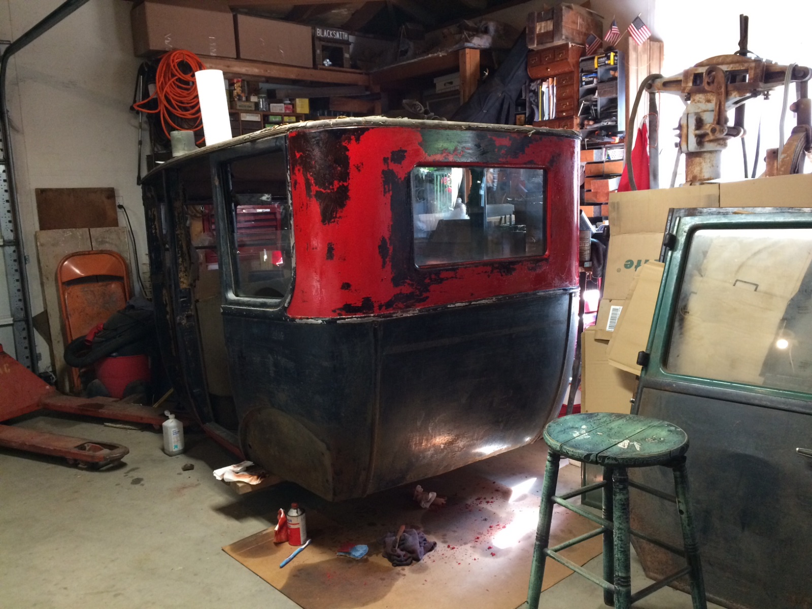

I did some testing with brake fluid to remove the red paint that was added. I started in the area that wouldn’t be is visible- the center post.
Now I plan to tackle the back!
It is shiny because I applied brake fluid last night. And I just put a second coat on. This morning I noticed that it totally absorbed into the into the paint. The paint is getting softer.
Matt

I am sooo hesitant on posting this but, when I restore Coke machines, call boxes, jukeboxes, etc., and the have been painted over and I want to keep the original paint underneath, I use a paint stripper called CitriStrip. It is an all natural stripper that I use. When I first used it, I thought it sucked because it wasn't working as fast or easy as I wanted it too, to strip things down to bare metal/wood. Paint was only coming off in layers.. Then the light bulb went on and I started using it on projects that I wanted to preserve the original finish. After I apply it, and see it is working, I then use an ultra fine #0000 steel wool pad and a toothbrush in tight or detailed areas, and I keep dipping it in luke warm water to work off the covering paint. The pads get gummed up real fast, so I go through a lot of them. It takes a long time for me to do things this way, but has worked for me well in the past. Me personally would not use brake fluid unless stripping down to bare metal. Too absorbent and will affect and strip the original paint you are seeking to save. The CitriStrip is a gel and not as absorbent, but to each their own. Please, PLEASE, PRETTY PLEASE, IF you try my method, do so in a small unnoticeable spot. I do not want you screaming at me that it stripped all of the paint away. This is why I am hesitant to post this but I would not suggest it if I remotely thought it would have a tragic ending and ruin the original paint. Obviously all paints are different and some are more difficult than others to remove. Patience is your friend. Feel free to contact me with PM if you have any questions. Hope this helps.

Kieth,
Thanks for your advice! I just read your post after work on this for four hours. Not only do I want to look into the stripper. I wanna look into the methods that you mentioned. I didn’t use steel wall but I did use a toothbrush, an old sponge, a rag and lots of paper towels! Here are the results:
On a close up inspection you can see in the ruff areas I had a hard time getting the paint.
Thanks for your comments!
Matt

That is a great trick. It's good to see that black paint.

Looks great. I am glad it came out the way it did for you. And yes, I forgot to mention LOTS and lots of paper towels and rags.

Thanks Kieth and Rich,
I think I need to get some better photos. It may look better in person. From 10 feet it is hard to detect.
I left the brake fluid on too long on the section under the doors on the left side and I did pull of the paint. I am glad that it is less noticeable. But Kieth's word of caution is important. Brake-fluid, and I imagine any stripper, will eventually pull up the black paint.
I haven't decided what I will do with the green on the doors. If I strip them I want to try CitriStrip as Keith suggested. But I may leave them for the taxi look.
Matthew

I put it on the chassis, but it doesn’t seem to fit.
:o
Maybe the body shrunk because it was taken off a chassis about 40 years ago.
Matt

Dont worry, it the extended cab! Very rare? :lol:

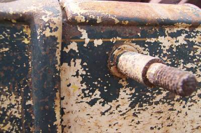

My 1926 Fordor exhibits that same red color under a black over coat. Also seen under the cowl vent door. Could this be an original color?

Post by Matt in California » Wed Nov 27, 2019 12:59 pm
Bill,
Mine clearly has the red painted over the black. The photos can be deceptive because the black is in the high spots and the red in the valleys, but this is because the black paint degraded then the red paint stuck to the surfaces in the valleys.
The cars with original red should be “Windsor Maroon.” If your red looks like mine, but it is under the black paint my guess is that that someone used red primer.
Matthew

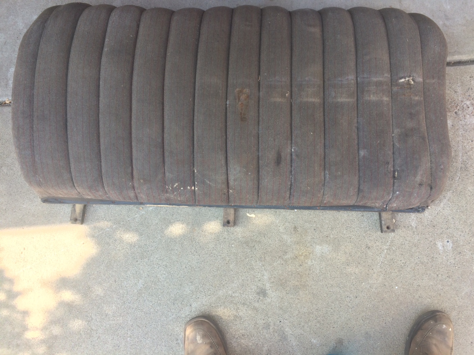

Bill,
I am always open to learning new things on the forum. And I think that sometime we find details on our cars that don't match the norm or period references. But I think you may have to really do some uncovering to prove that your paint was not done for restoration. Please post some photos of your car. i would enjoy seeing them!
For me it seemed most likely that the upholstery is original. Black paint is found under the upholstery and paint, so for me it was clear that this is a black Fordor. After research (or comments on this thread) it was clear that the absolute statements that all Fordors would be made in Windsor Maroon needed to be take in the context. If Ford offered Fordors in a different red it would be great to learn more. I am not a person to say that is impossible, but I think you should show your evidence so we can discuss it. In the process I think it is very educational.
Matt

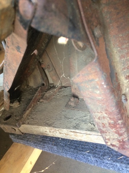

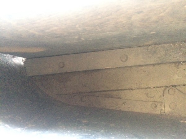

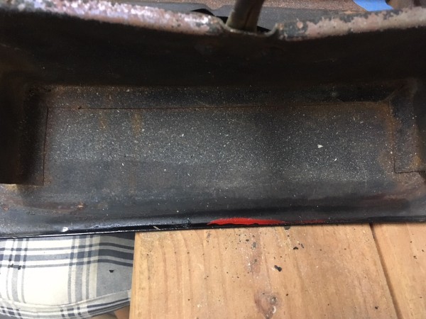

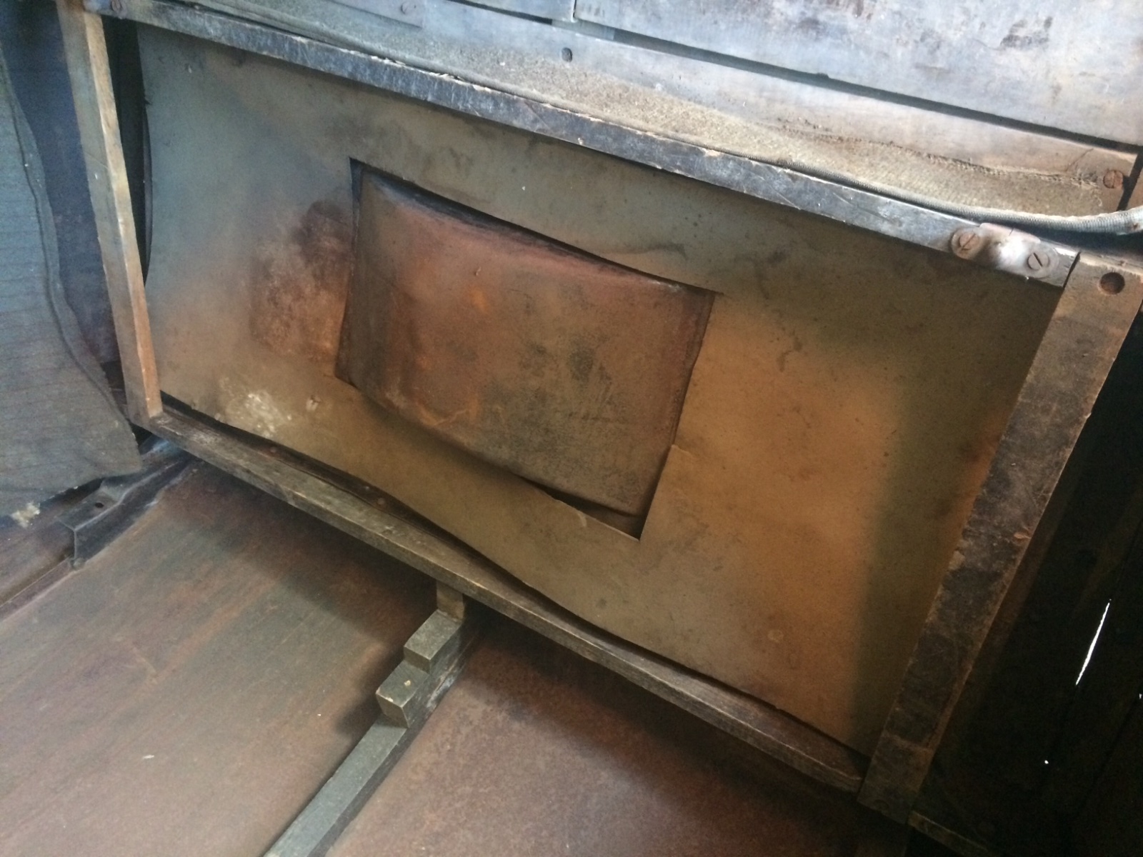

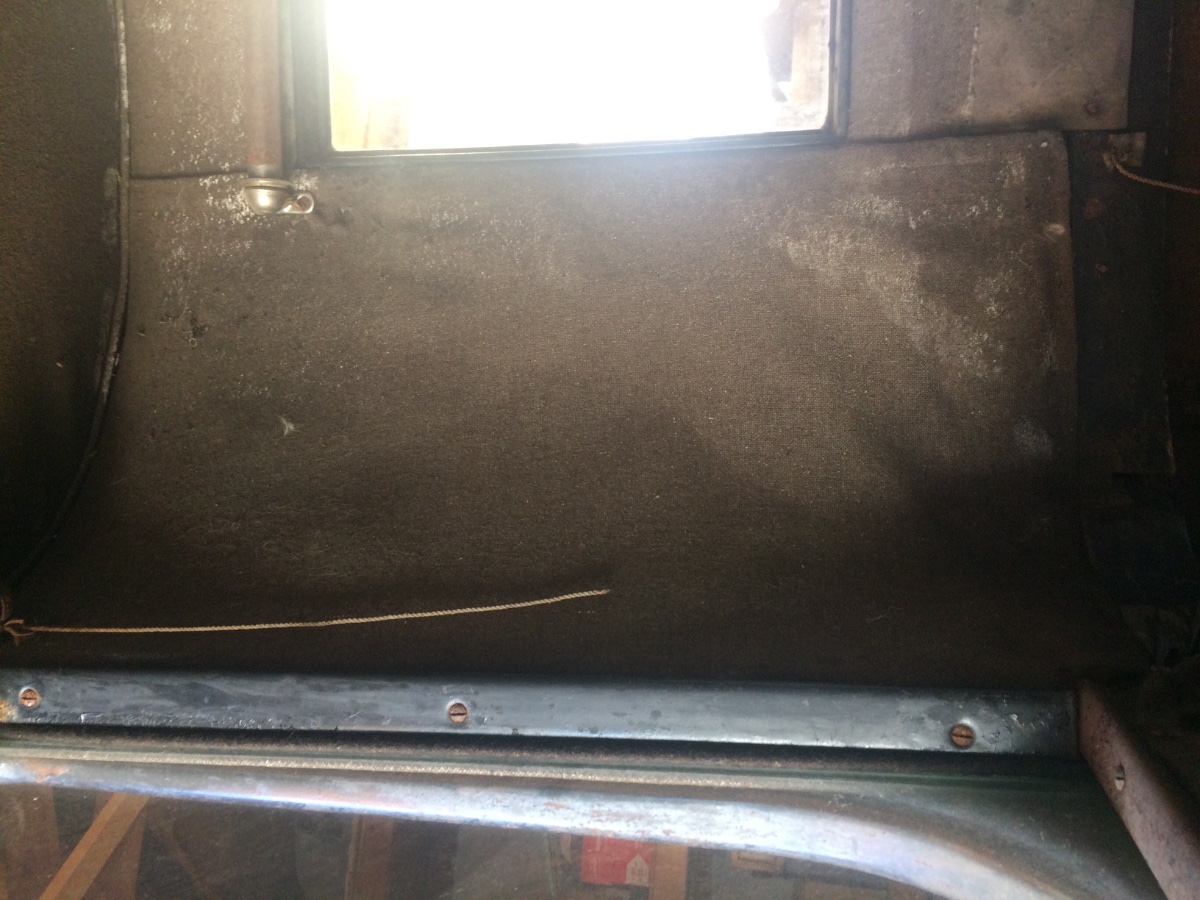

I am posting the following photos for TBill (these are NOT photos of my car). Bill wants us to comment on them and the possibility that it is original paint.
Under Cowl
Cowl
Back
Last edited by Matt in California on Mon Dec 02, 2019 11:13 am, edited 1 time in total.

Hi Matt. I believe that you have all the evidence you need that your Fordor was originally painted maroon in the fact that your upholstery has red stripes. 93 years is a long time for the inferior automotive paints of 1926-27 to survive. Some may disagree, but a common thread on the forum is “what did the original colors look like”. That fact that this question has never been satisfactorily answered is due to the fact that very few, if any, Model T’s have survived to the present with the original paint, so it is not surprising that you are having trouble determining the color history of your Fordor. If your car was garage kept in a climate controlled garage for the entire 93 years, some original paint may survive, but since you don’t know the history of the car over that time span, you don’t know whether or not it was kept outside, exposed to the elements, which if that is the case, the paint would oxidize completely off over that time span. Also, at some time in that time span, say, in the 1950’s if it was completely dismantled and old original panels replaced by other panels, during an incomplete attempt at restoration, which appears indicative by the multi-colored panels, it is conceivable that the replacement panels and other body parts were stripped and painted black by a restorer who had no idea what the original color should have been. If you want it to be a correct restoration, I believe you should assume that, based upon the original red striped upholstery, your original Fordor left the assembly line as a maroon Model T. It makes no sense that Ford would have painted your Fordor black, when the vast majority of 1926-27 Fordors were painted maroon. It is more likely that the black paint was applied during a very old restoration attempt years ago by a novice, in response to the incorrect assumption that ALL Model T’s were painted black. Jim Patrick

As Jim Joseph Andulics stated earlier on this thread.
henryford2 wrote:
Mon Nov 11, 2019 7:33 am
It is clear both with the evidence of original black Fordors and the documentation on the MTFCA encyclopedia that Fordors were "painted black, with black fenders, intially".
Bill's question (with the photos that I posted on his behalf) is if his bright red paint could have been original. I believe that he is asking because he found the red paint under the black paint that he is currently stripping off. My question is for Bill is if under the red paint is black paint. I ask, in part, because when I see the back section with the top down to metal it looks like a bit of black paint on the bare metal.
Matt

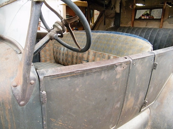

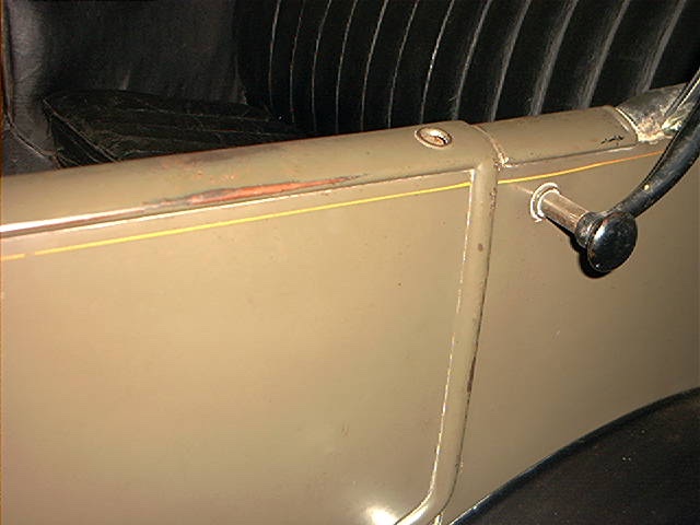

I have a '27 Fordor that was made in Oct., 1926. The original upholstery is still in the car, but the lower front cushions are worn and kind of raggedy. The front seat backrest and the entire rear seat upholstery are pretty much ok. Of course, the upholstery color is faded, but on the lower cushion hidden surfaces, the original gray with red stripe is in good shape and would serve to be excellent samples. That said, the original paint is still on the engine side of the firewall and on the inside of the doors under the upholstery where it's always been covered. The paint is flat, not shiny. The color is kind of an olive drab. My opinion is that the color was originally green, much like the the original color on the cut away engine at The Henry Ford Museum. It might have been a dark gray also. Further, this car has an excellent original body with all original wood. The doors shut nicely and it had the original top on it when I bought it in 1964. I doubt that it ever sat out in the weather. This car also has the "HP" code body number stamped in the wood between the hand brake lever and the drivers door.
This indicates, at least for 1927 cars, that not all Fordors with maroon stripe upholstery had maroon painted bodies. Of course, there all kinds of hypotheses that Ford ran out of that color paint or parts and used something else that was available, and that different parts, or colors were sometimes used at the assembly plants located away from Dearborn. We've all heard those stories and can't say that they are right or wrong.
In summary, the analysis given here is my opinion based on the solid original condition of my '27 Fordor.
Keith

Bare metal under the red on my Fordor.
Maybe that’s what maroon looks like after 93 years?
Seats are gray with red pin stripes.
THANKS ALL!!!

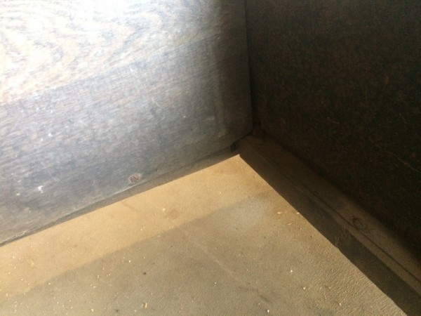

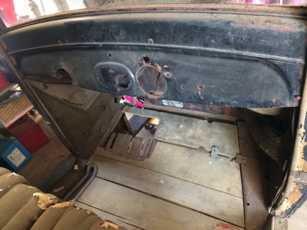

DHort wrote:
Sat Nov 02, 2019 11:06 pm
I've had two different 26 fordors; still have one at the present. I do think that I remember the rear floorboards being two piece.
