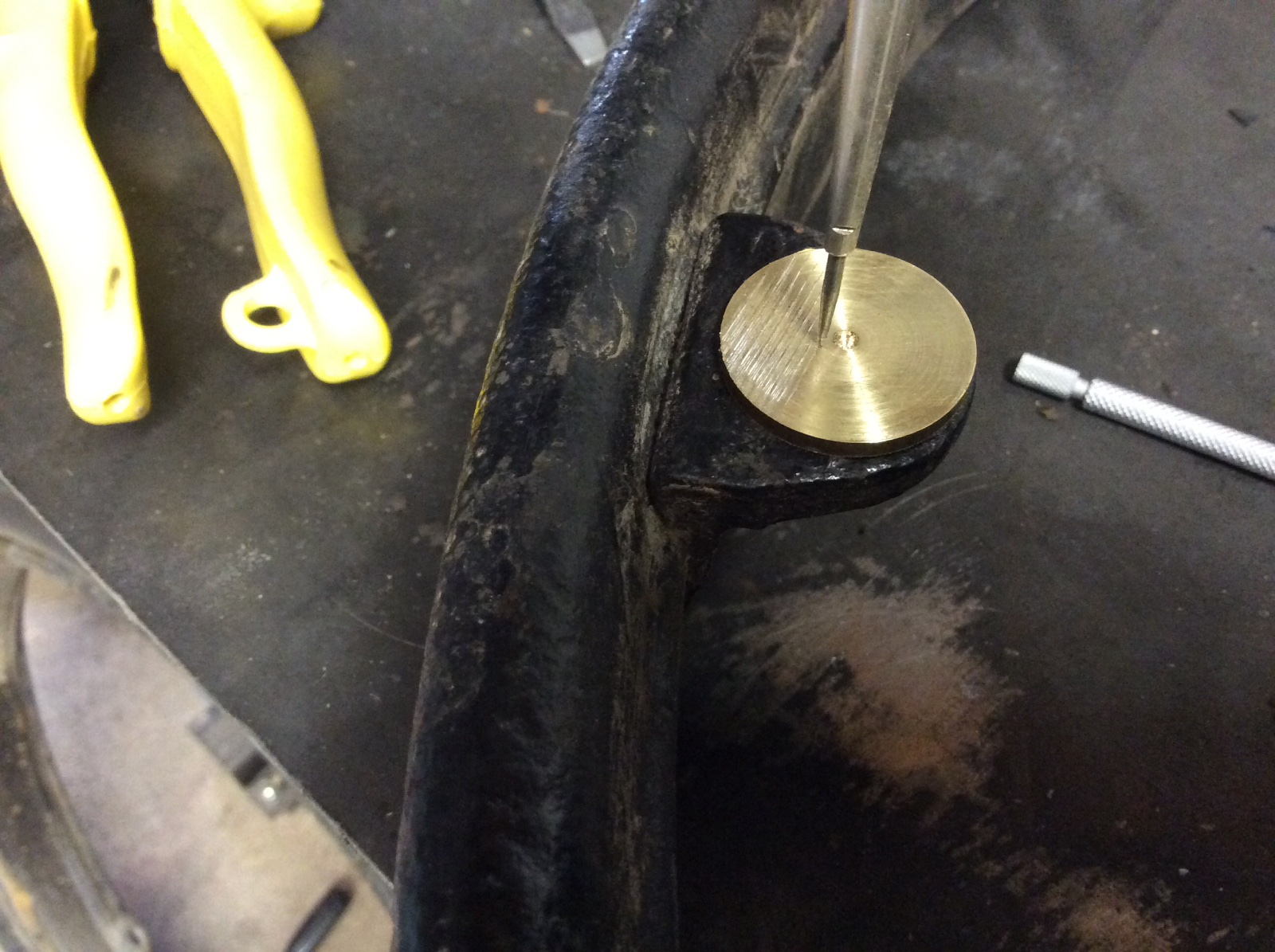

It is difficult to measure worn and altered parts,but I made centering plugs to see if the rim and felloe were different size.
I calculated that the felloe is about 1/8” bigger diameter than the rim lugs. Except for the holes in lugs the rims fit pretty well.

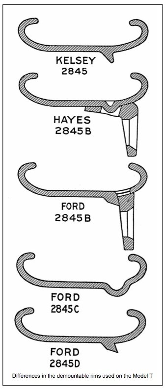

Thanks that is good to know. I still need new rims as these are too rusted. Are Kelsey rims correct for the wheel with the valve stem coller?

I am not an expert on this subject, and on the rare occasions I must mix/match, I refer to what has been posted before...
http://www.mtfca.com/discus/messages/50 ... 1434340728 take a look at Mark Strange's pictures of wheel/rim with a raised ring...I am thinking you have Hayes based on your description.
also on the same link, look at By Mark Strange - Hillsboro, MO on Friday, June 12, 2015 - 08:35 pm: you'll see the gap which leads to "square" feeling of wheels that I posted earlier.

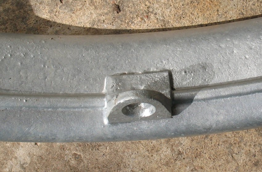

- Posts: 7403
Re: More on wheel replacement
I believe the felloe in your first photo is Hayes. The notches accommodate the lugs on Hayes rims.
Note how the Hayes lug extends almost to the center of the rim.
Hayes lug.
Hayes lug.

Thanks. the the rims are marked Hayes on the lugs. I was not sure if they were correct.

Well, there you go...your felloe picture is a Hayes felloe and you say "Hayes" is on the lugs of your rims...you have matched sets. Now you need to seek out rims that are compatible with your known felloes.

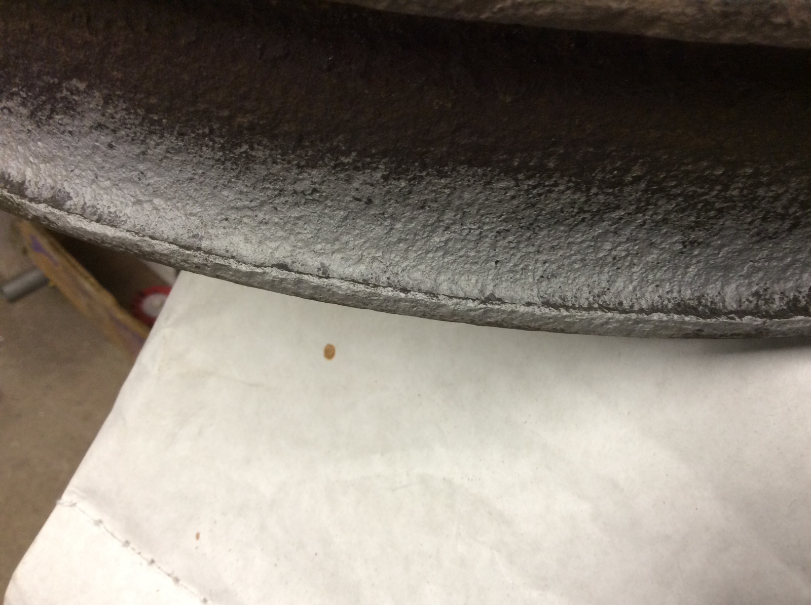

Rusty rims are one thing, but if the edge that folds over and holds the bead is sharp that is another thing. Show us what you have. If the edge is not too bad, they could be ground back to a better profile and should work fine.

One rim is ok and has good edge. One rim has lugs that do not lock in the fellow, different style. Two have vey sharp edges and pitting. I have not inspected the spare,but it is a Hayes also. I found three good used rims today,so I am all set. Thanks for all your help . This is a very good forum.

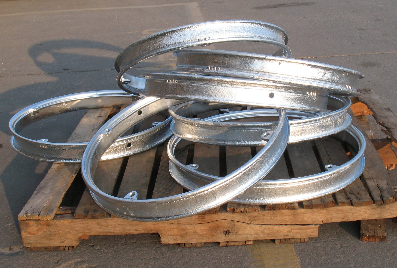

When it comes to finishing rims you have three choices. The most authentic is to have them galvanized as original. Another is powder coating. The third, which a lot of people do, is to shoot them with a rattle can of Oklahoma chrome (aluminum paint).
Galvanizing is best.

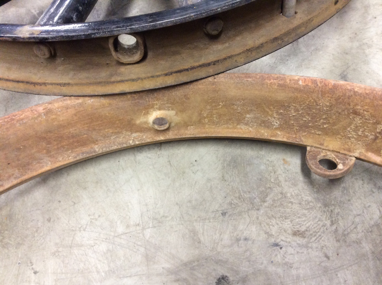

Mark,here is a picture.

I don't know where the cadmium story got started, but it's bogus. Galvanizing is zinc coating. It can be electroplate or hot dip. The latter is better.

Cadmium appeared in the 30s and 40s as a plating for iron, so came too late for the T. Good old zinc was what was used as Steve says: https://en.wikipedia.org/wiki/Cadmium

John, quite apart from the finish for rims, the photo you posted shows a rim I would reject. The bead is heavily rust pitted and quite rough on the edges. Beginning T modellers without previous experience are often unaware of how a good rim looks and how much heavier a good one is.

Allan thanks for your advice. the picture was in response to mark. I would not use that rim.

Ya that one looks to be eaten back quite a bit in the photo, them darn rust worms.

Isn’t that cup around the valve stem for a Firestone rim? I see the “notches”like a Hayes. I think that fellow is a universal wheel, takes Firestone or Hayes rim. The Firestone wheelsI I have seen have do not have the notches.
If you will clean the inside of fellow around the cup, you may find a name there. Sometimes it is spaced along the wheel, but most times close to thr valve hole. Dan

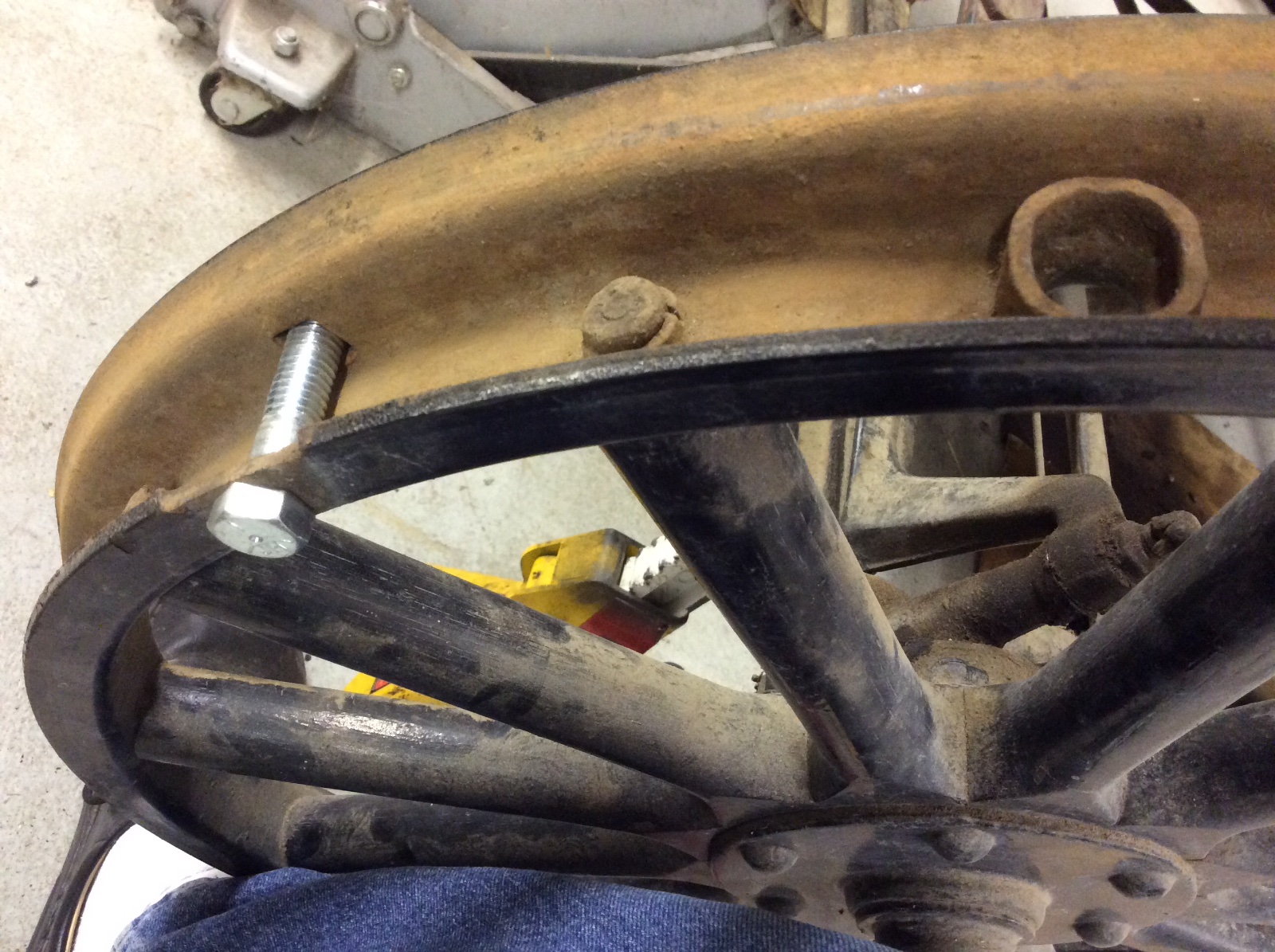

Here is a rim like one that was on the front wheel of car. I thought it might lock in to the cup,as it has no tab for the notches.Dan Hatch wrote: ↑Tue Nov 12, 2019 3:22 amIsn’t that cup around the valve stem for a Firestone rim? I see the “notches”like a Hayes. I think that fellow is a universal wheel, takes Firestone or Hayes rim. The Firestone wheelsI I have seen have do not have the notches.
Unfortunately the extrusion on the rim is too short to catch the cup. At least I now have 4 Hayes rims that work fine. I could not find any name on felloe.

I wonder what keeps this rim from slipping on the felloe with braking?
John
John
- Posts: 7403
Four bolts.

Firestone type rims have a big tit to fit the cup. If I get time I will get some pictures of the NOS ones I have. It will also show the zinc plating. Dan

Steve ,Thanks for answering my question. I did not know if the 4 bolts were enough to hold the rim on with no other locking.
This will save me some work as my bolt only rims are in nice shape and one of my locking tab rims needs a lot of metal work. I will have several to choose from.

John, four bolts do hold the rim on the wheel, but that is only part of the story. The rims are designed to be jammed onto the felloe by the tension in the four rim bolts. It is this jamming of the rim which provides the binding between the two components that keeps the rims tight on the felloes, and on the rears, provides for the drive to be transmitted. Any combination of rims/felloes which relies on the four bolts only for the mounting and taking drive/braking forces is not the safest.
