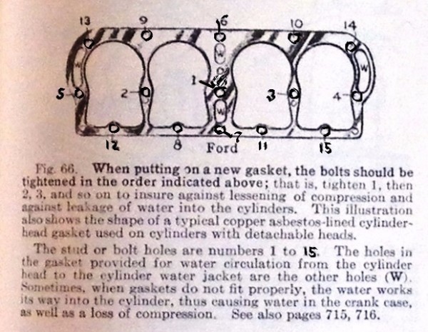

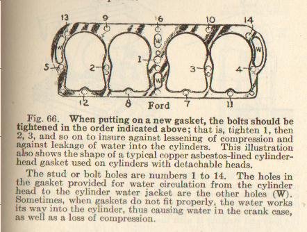

- Posts: 6577
Re: Head Gasket Replacement
torque chart
- Attachments
- Head bolt sequence.jpg (48.22 KiB) Viewed 8681 times

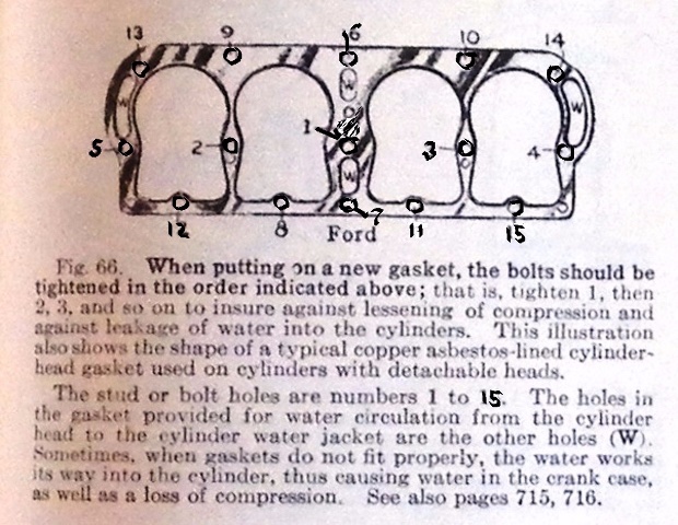

- Posts: 4081
Frank
Regarding that old torque sequence chart the artist left off bolt #15
So here it is redone......
Most important to always tighten the center head bolts, 1-5 first.....to squish the gasket at the middle tightly then alternate around the edges, your sequence can very, but never vary the center line of bolts first............
reason........the head gasket is thinnest at the center between the cylinders.....most gaskets blow at the thin spot.

- Posts: 6577
Dan, Thanks for the correction. Page replaced in my file. Also I heard that it helps to simplify positioning the head on the new gasket if you put 2 dowels (headless bolts) in head bolt postions
