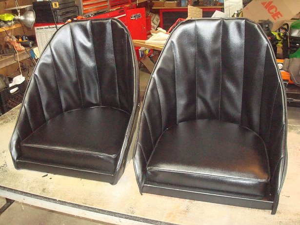

Here is a set that I did this past summer. I bring a set like these every year to Hershey. I am in New York State.

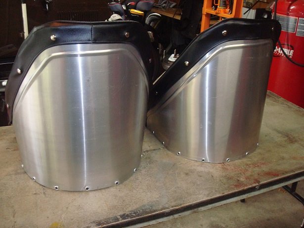

Tyrone, perhaps a more important question is how others support the edges of the metal. I have two sets that I built a wood framework around the inside edges to support the back and properly attach the material. It ended up being about a 1 1/2 inch by two inch curved piece.With the compound curves it took a lot of wood. I have seen 1 1/2 inch by 1/4 inch steel bar heated and bent as well. It became quite rigid but needed snaps fasteners on the back to attach the material.
In my opinion, if you don't support it, you get a floppy backed seat and cannot get the material tight.
I am just about to start to make another set of seat backs for my wife's fire truck. I make patterns. cut the sheet metal and roll the edge beading into the backs.
