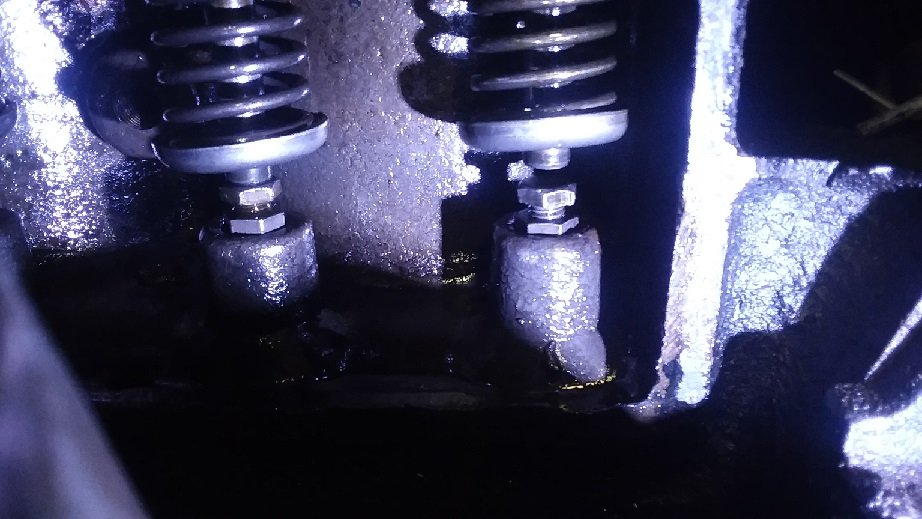

I found the reason for #1 not working. I removed the front side cover and turned the engine thru a few revolutions, with the hand crank, and found that the #1 exhaust valve is not closing. The engine is a fresh rebuild with 50 hours or less on it and has never given any hint of such trouble, until now. I'm pretty sure the valve is new. I haven't removed the head yet but the spring doesn't appear to be broken and the keepers are in place. I have a new/old head gasket so I suppose I will order a new valve and a new spring, from Lang's and prepare to fix the problem. I hope the valve seat is in place where it belongs. I heard no noise when the running bad began and hear none now with it running on three cylinders so I' hoping for the best.

You don't need a new valve or spring (at least not yet, you don't). That valve will tap closed with a wood dowel and small hammer through the spark plug hole. Your engine is too new to have accumulated too much crud.
I will suggest either a small amount of spindle oil into the valve through the spark plug hole and let it sit overnight. If you don't have such oil, then buy some Marvel Mystery oil
and put a little in there instead.
Next morning, tap closed. Start car
repeat as necessary...as it may take a couple times to get oil down along the length of the valve.
The petrolium distilates are what will work along the valve stem to help free it up, and the TCP (Tricresyl Phosphate) will (hopefully) aid in it's continued freedom, as it is an anti-wear, high-pressure boundary lubricant. It is ideal for this condition, where valve-to-hole diameters may be a tad too close.
read lable on container and dope the fuel with recommended amount and drive the car.
Hopefully, this will fully resolve itself within a tankful, and then you're done with it. Do not add to the oil...ever...fuel only.

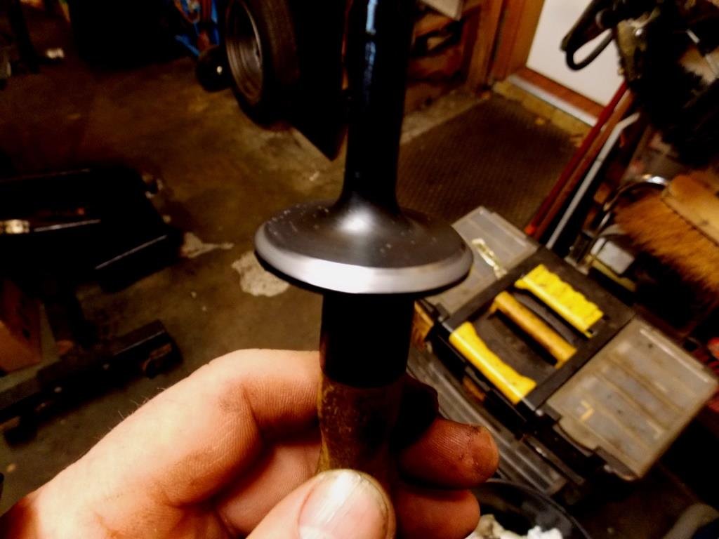

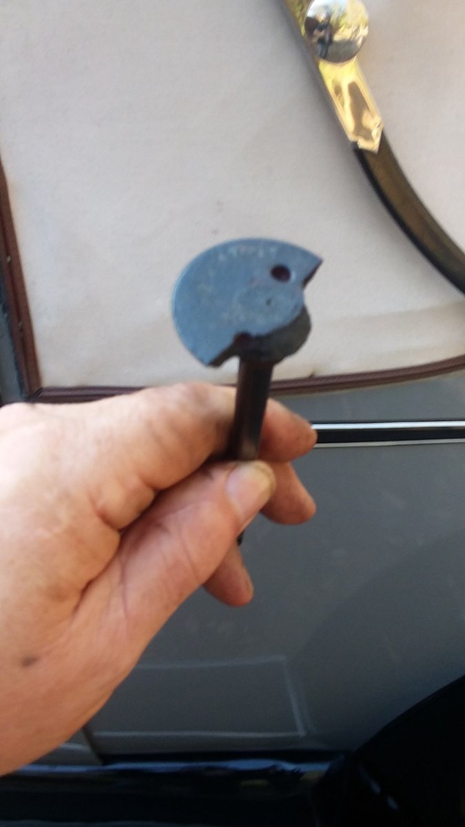

I guess I'm gonna need a bigger bottle of MMO. Here is the #1 exhaust valve out of our T. I'm ordering a new valve from Lang's today.

I believe I'd be questioning the "fresh rebuild" back to whomever did the work. I've not seen "new" valves with the 2 dimples for the old timey valve grinders - appear to be 2 pc. ?

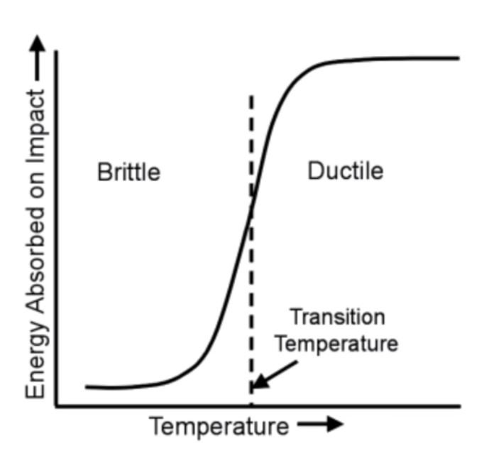

I'm no expert on the steel that went into those valves, but some of the steel in those days could be quite brittle due to the way it was manufactured.

HOLY MOLEY!
2X what Steve said!
2X what Steve said!

Yep, sure looks like a 2 piece (well, maybe 3 or 4 pieces) valve to me.
I would consider replacing ALL the valves if they have the holes in the top like that one.

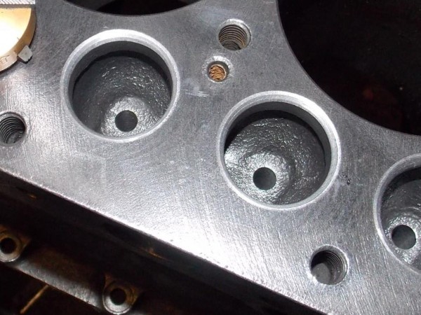

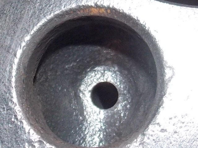

I will grind the stems if necessary but I don't have a liquid cooled grinder. I will buy a new stone for my bench grinder if that will get the job done. What kind of stone do I need to buy?
Meantime, can someone show me a good pic of valve seats, without any valves in them. I want to see if mine look as they should.

The valve seats in my engine have very little angle but seem to contact the valves in the correct area. I'm trying to decide whether I should grind the seats or not.

You can check seat width, contact continuity, and location on the valve with Prussian Blue. Though that is the way it was done "in the day", lapping is a great way to ruin valves and sink seats into the block.
You said the car ran great before your valve went to pieces, so the seats can't be that bad.

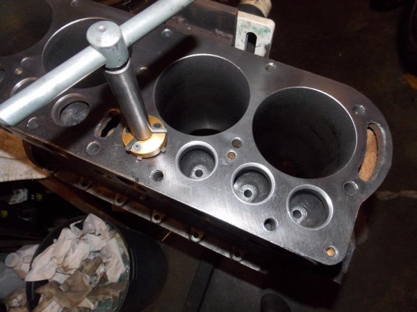

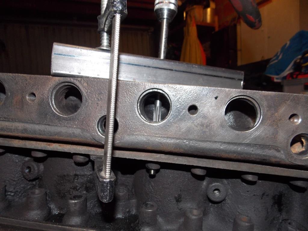

If you're absolutely committed to messing with this, find someone with a Neway cutter kit for a Model T and barely kiss the seats, and set the seat on the valve where it belongs using the raising and lowering cutters. None of this is possible by simply lapping the valves. And after using the Neway cutter, if you're still tempted to "kiss" the valves with compound. Don't.
Andre's post above shows a Neway cutter in use with what appears to be a custom handle. Magnifying his photos to the max, shows the 3 angle cut, and the correct width of the sealing seat.
Also, on the new valves (or old), do not rely on them being perfect. For a very small fee, have each kissed on a facing machine and be SURE they are concentric to the stems and completely without blemish.

My new (one) valve finally arrived today. It fits the guide fine. I believe the tappet will take up enough so I won't have to grind the stem.

I got all eight new , replacement valves and found that, I believe, the stem to guide fit is good, but as-is with the lifters adjusted all the way "down" I had little or no clearance on some. Today I took all eight new valves to the machine shop and left them with him to get .025 ground off each stem. If that's not enough I'll take 'em back as needed. Anybody know how much adjustment is usually built into adjustable lifters?

Tommy, there is at least 1/4" of adjustment.I discovered this when I mistakenly cut the stems on some modern replacement valves to the wrong groove on the two piece collets. There was enough length in the adjusting bolts to compensate, but I wouldn't recommend winding them out that far.

I just rewatched Mike Bender's video on installing valves and he said the norm is to have .100 taken off of new valve stems. Maybe I should call my machine shop guy in the morning and tell him to go .100?

Tommy,
I grind mine always to 125mm = 4.92" . This made the clearance you need to adjust the gap with the adjustable tappers and left 4mm under the hole.
