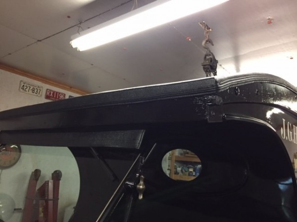

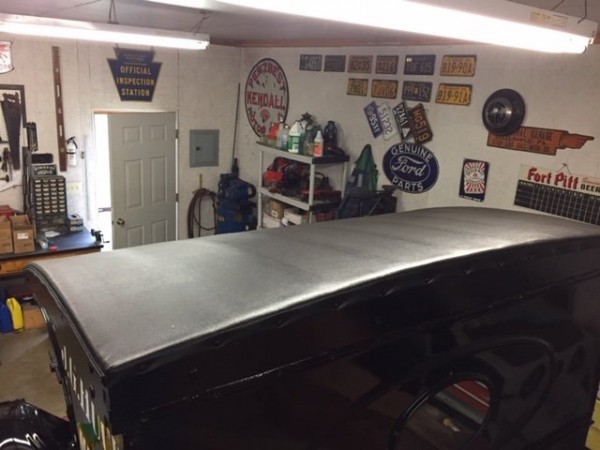

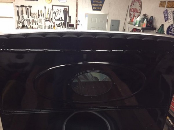

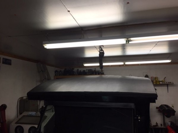

My high roof C cab had minimal remnants of the original covering that consisted of burlap and the typical oil cloth. There were no signs of padding but with so little left I couldn't say for sure if there was padding or not. On my top I used a layer of black duck cloth followed by 1/8" of cotton with the Ford grain material on top. I also followed the original edge design where the back section was nailed and then folded over and held with tacks. The side and front used hidem welt. There seem to have been different methods when new for the top installation as some of the factory photos look to have metal side and front beads while others appear to have hidem.
The original windshield flap was also in my truck. It was made of the same material as the roof and had a layer of burlap sandwiched between the front and back oil cloth pieces. The flap is secured by tacks to the inside upper roof wood panel.

Also, the roof does show the roof slats but it is minor as long as the roof material is tight. I expect that they showed some originally too but don't show up well in period photos. They certainly did not have thick padding. An overstuffed roof on a C cab doesn't look good.
Justin in Western PA

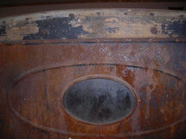

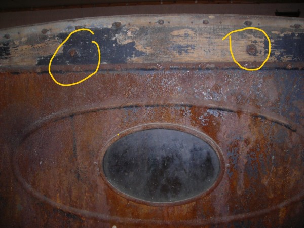

- Posts: 70
- Joined: Sun Jan 06, 2019 1:19 pm
- First Name: Justin
- Last Name: H
- * REQUIRED* Type and Year of Model Ts owned: 1924 TT C cab
- Location: Western PA
Re: 24-27 C-cab Roof

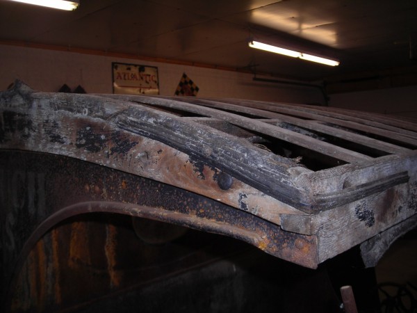

They are the top, center bolt for the rear curtain brackets. The other two lower ones are wood screws.
