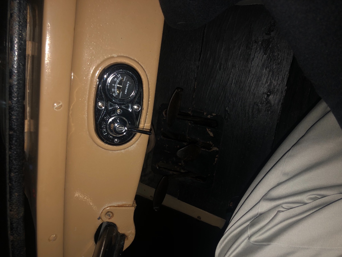

Interestingly enough, the car seems to be in no danger of starting. With a fully-charged battery, at most, the starter simply “lugs” for about 1/3 turn-When it works. Which it really doesn’t. Thankfully, I have a replacement switch that I’ll throw in. The old switch will eventually get hot. Since the shop area it’s currently living in is cold, It’s a bear to crank-But it won’t start on crank and magneto, either.

If you jack up a rear wheel, chock the front wheels and put the hand lever in neutral without it engaging the rear brakes you should be able to crank start the car with the switch in the battery position. Take out the plugs and put a couple of tablespoons of gas in each cylinder before you replace the plugs. That assumes you get each coil to buzz when you crank it through and that you have enough gas in the tank. I have started my '27 that way in 20 degree weather with a battery that would not turn over the starter at all. Good luck!

I actually tried jacking the rear and chocking the front wheels-Then engaging neutral as well as high gear-No luck on crank or battery.
....My car has been converted to coil and distributor...I’m actually going to replace the starter switch tomorrow and make sure everything is connected-Tightly. The fact that the switch gets hot and even smokes a little points to the: “Weakest link.” And that’s not holding it for any more than a few seconds. Either that, or there’s a momentary short close to the switch!

...and make sure everything is connected-Tightly.
Wise words. A weak starter is often due to a weak ground, not the starter. It can also be due to a dying battery.
But this car's refusal to start is likely from something other than slow cranking. Even when cranking by hand, a slow turn should get it going. After all, a lot of these cars have no starter and are easy to start. Don't despair. You'll sort it out.

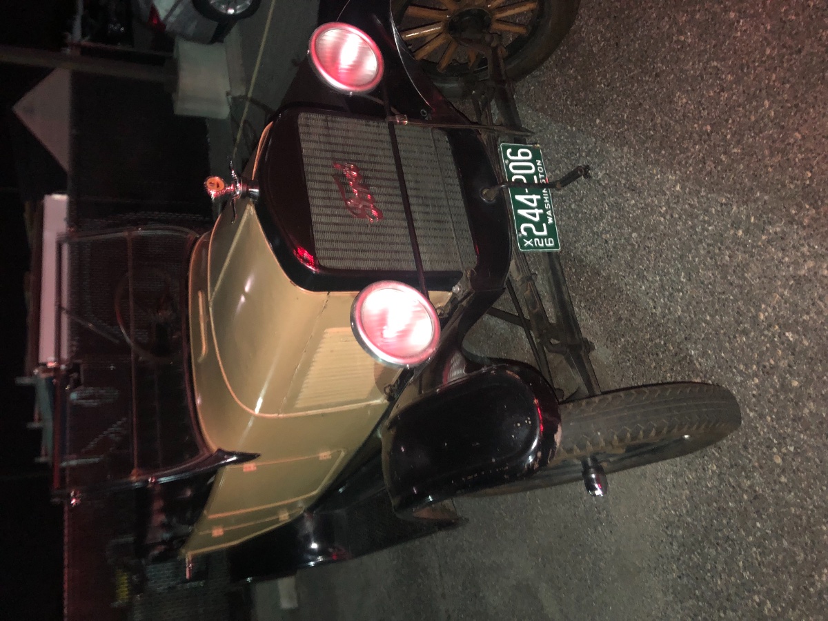

....Interesting question:
....As today’s rainstorm stopped all hopes of pushing her outside for an attempted start, I’m still thinking of options involving the title mishap-The seller of the car has been a good fellow thus far, but I’m thinking about a: “Plan B.”
It was suggested to me that I can title the car in Vermont and then use a loophole of sorts to simply pay double-tax, but at the end of the day I’ll be holding a valid NJ Title-Has anyone ever heard of this? Thanks again in advance!-Rob

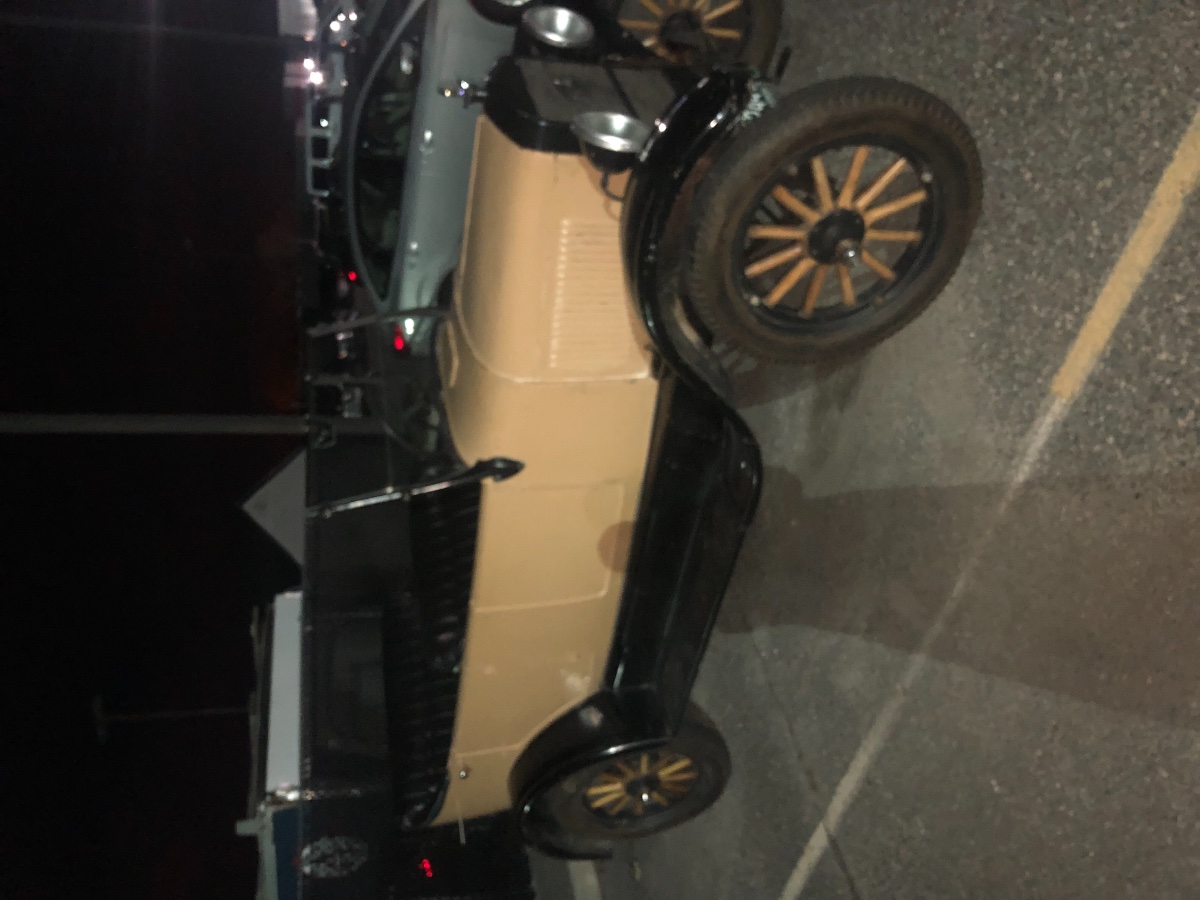

Hey, neighbor. Dave Young here. I'm right up the road in Mays Landing. That car looks very familiar. Is it from the west coast? If you want any help getting her going, let me know. Forget about the Vermont title thing. It can be done through the local DMV, but it's a long process. The manager at the Shore Mall DMV is a car guy and can guide you thru it. For the actual registration and QQ tags, you'll need to go to the Deptford DMV. Send me some more pictures via text. 609 289 0677

Isn't that Eric Bruckner's car that he was forced to sell a few years ago when he got divorced?

...It *was* a West Coast car-But that name hasn’t crossed my path yet. The car seems to have been sold every year...Given the large “kill switch,” I suspect it’s also been an electrical nightmare.
...That said? “Howdy, neighbor!”

That looks like Erech's car. I saw it once. I would suggest that you pull it with a long rope. Attach at the front cross member or the spring but not the axle. pull it until it starts in high gear. Then have the towing vehicle stop. Once you get it running, you can fiddle with the carburetor adjustment and timing and find the "sweet spot" Next time you try to start it open the fuel mixture about 1/4 turn to start then lean it out after it runs a minute or two. A lot of owners use a kill switch just in case of a short when parked. That switch could also be the source of your problem. Many times they get corroded and don't make a good contact.

Don’t know if this has been mentioned or not, but check the starter terminal post. If you can wiggle it with your fingers, the buss bar is probably bad. Just got done fixing mine and that’s what I found
