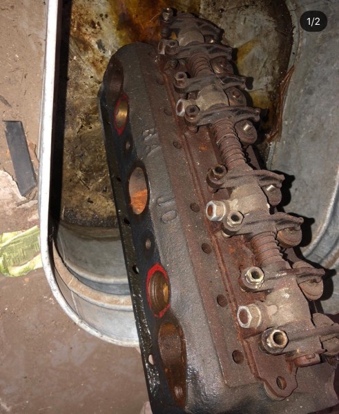

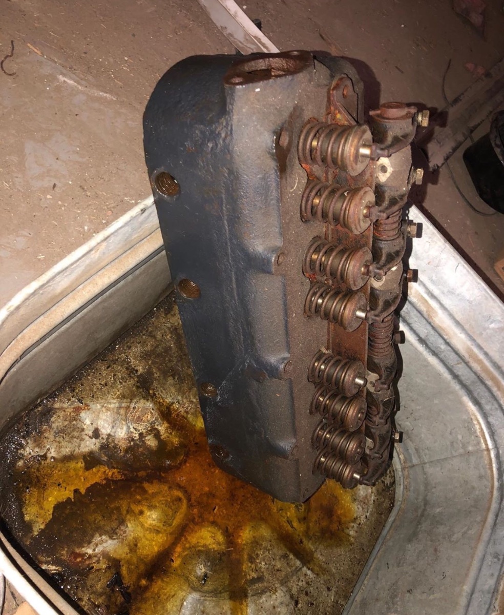

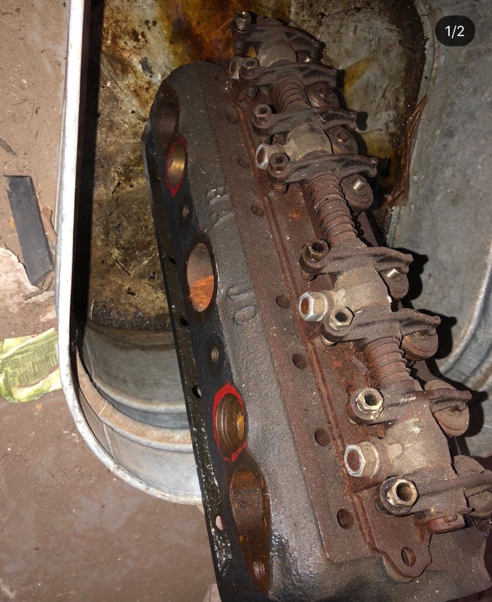

Hey all, I have an opportunity to buy a RAJO head. After talking with a few people, we believe it is a model B or a C35 head. It missing the intake, exhaust etc. The rocker and valve assemblies are all there though. I can fabricate most everything but I’m most curious about pushrods. Are they available? Are they hard to find?
Here are a couple of pics. Waiting on more.

Just FYI, those are Ford 6 cylinder rockers- not original Rajo. They will need some work to get the geometry at the valve stem end to be even close to correct. Also, that's definitely not a B head.

I’m certainly not the RAJO expert... but looks like a C-35 to me. Take a good look at the deck thickness of this, or any, overhead. They have a tendency to have an excessive amount of material removed to increase compression. This one appears to be a bit thin under the plugs, and the short flange too. Maybe someone can post the nominal head height for you to compare

I have a model 30 (AKA commercial) Rajo head. Single intake four exhaust ports. The thickness of the head at a head bolt boss is 4.660 inches. There is about a quarter inch between the surface to where the spark plug bump begins. I measured my Mark Chaffin Rajo and the head thickness is 4.690. Looking at the original post I would think it has been milled, maybe as much as .200" .

I have several Rajos and I’m pretty sure that’s a model 30 or the commercial head

It is definitely a "C". No bump out on drivers side and oblong or rounded rectangle center port. As mentioned before the rockers are not correct, but that is not uncommon.
